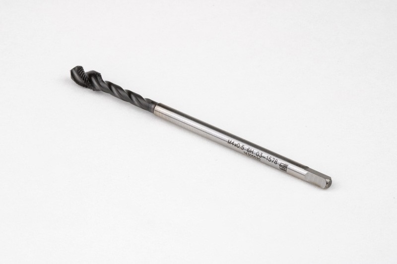

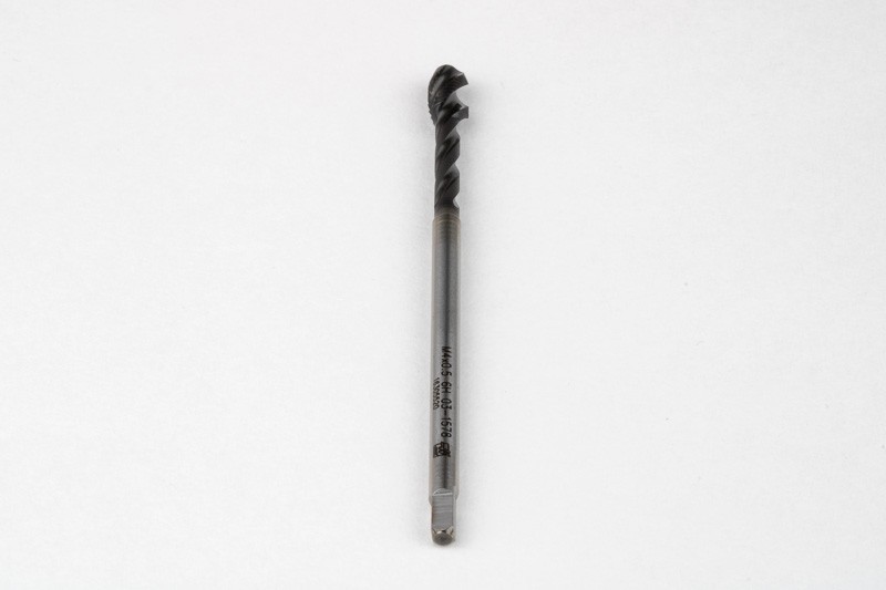

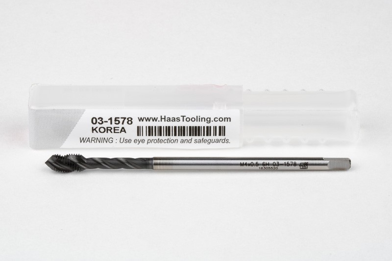

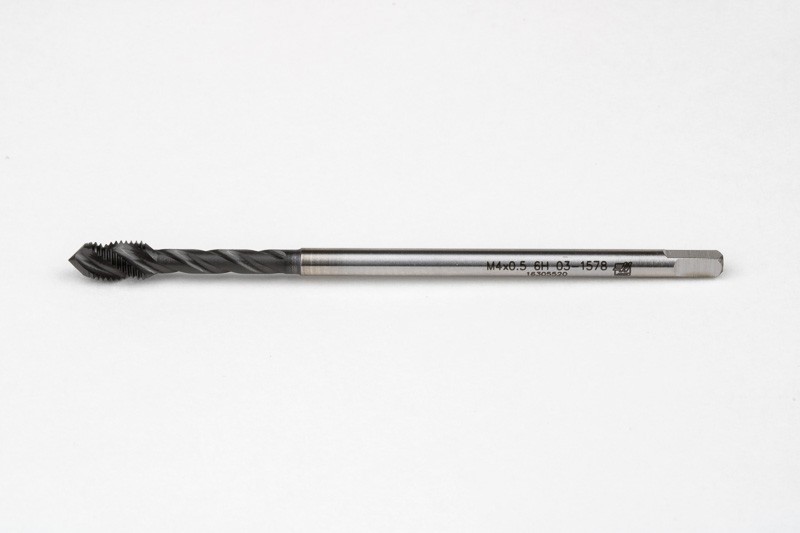

Thread Series MF - Metric Fine
Thread Size M4x0.5
Primary Workpiece Material M - Stainless Steel, P - Steel
Tap Type Spiral Flute
Shank Type Square
Material HSS-E
Coating Hardslick
[TP] Thread Pitch 0.5 mm
Tap Drill Diameter 3.5 mm
[ØDC] Cutting Diameter 4.0 mm
[ØDMM] Shank Diameter 2.8 mm
[L2] Chamfer Length 2P - 3P
[L1] Thread Length 5.0 mm
[LU] Usable Length 21.0 mm
[OAL] Overall Length 63.0 mm
[SS] Square Size 2.1 mm
[NOF] Number of Flutes 3
[FHA°] Helix Angle 40
Length / Diameter 2.5 X D
Thread Class 6HX
Through Spindle Coolant No
