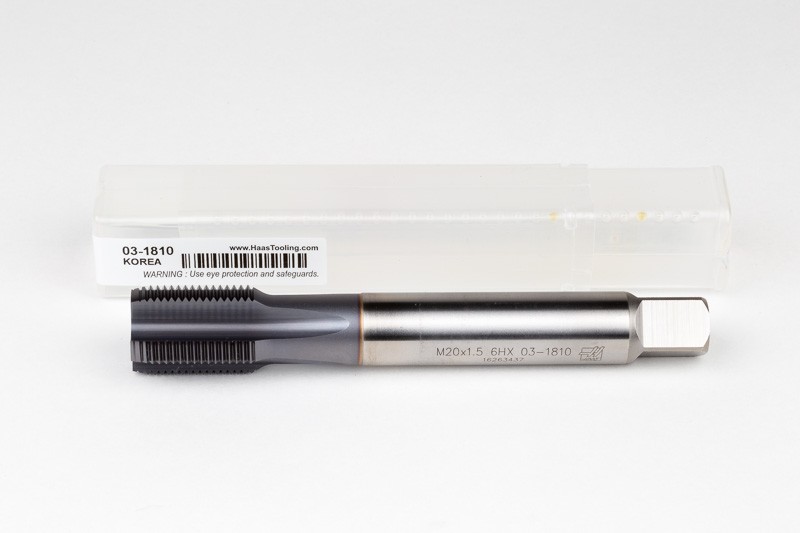

M20x1.5 MF HSS-E Straight Flute Tap, 16mm Shank x 25mm Thread Length, 2XD, Mod. Bottoming, 4 Flute, 6HX, TiCN Coated
Part #: 03-1810
M20 X 1.5 ST FL CAST IRON TAP
Price: $83.95 ( / unit)
Price: 1173.95 ( / unit)
Price: 349.95 ( / unit)
Price: 46.95 ( / unit)
Price: 211.95 ( / unit)
Price: 492.95 ( / unit)
$58.97
$56.02 (Save 5%)
  • Speeds & Feeds (METRIC)
ISO MATERIAL CHART
Thread Series MF - Metric Fine
Thread Size M20x1.5
Primary Workpiece Material K - Cast Iron
Secondary Workpiece Material N - Aluminum
Tap Type Straight Flute
Shank Type Square
Material HSS-E
Coating TiCN
[TP] Thread Pitch 1.5 mm
Tap Drill Diameter 18.5 mm
[ØDC] Cutting Diameter 20.0 mm
[ØDMM] Shank Diameter 16.0 mm
[L2] Chamfer Length 2P - 3P
[L1] Thread Length 25.0 mm
[LU] Usable Length 50.0 mm
[OAL] Overall Length 125.0 mm
[SS] Square Size 12.0 mm
[NOF] Number of Flutes 4
[FHA°] Helix Angle 0
Length / Diameter 2 X D
Thread Class 6HX
Through Spindle Coolant No
Weight 0.4 lbs \ 0.2 kg
