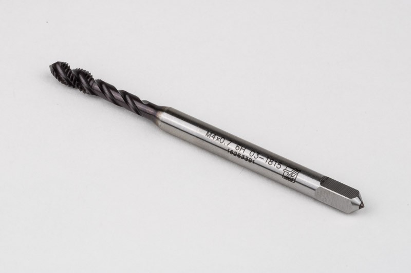

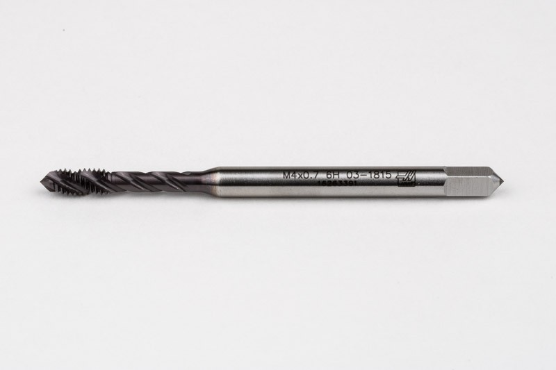

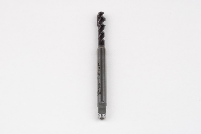

M4x0.7 M HSS-PM Spiral Flute Tap, 4.5mm Shank x 7mm Thread Length, 2.5XD, Mod. Bottoming, 3 Flute, 6H, TiAlN Coated
Part #: 03-1815
M4 X 0.7 SP FL TI & NI ALLOY TAP
Price: 14.95 ( / unit)
Price: 198.95 ( / unit)
Price: 59.95 ( / unit)
Price: 7.95 ( / unit)
Price: 35.95 ( / unit)
Price: 83.95 ( / unit)
11.97
  • SPEEDS & FEEDS (INCH)
  • SPEEDS & FEEDS (METRIC)
ISO MATERIAL CHART
Thread Series M - Metric
Thread Size M4x0.7
Primary Workpiece Material S - High Temp Alloys, P - Steel
Tap Type Spiral Flute
Shank Type Square
Material HSS-PM
Coating TiAlN
[TP] Thread Pitch 0.7 mm
Tap Drill Diameter 3.3 mm
[ØDC] Cutting Diameter 4.0 mm
[ØDMM] Shank Diameter 4.5 mm
[L2] Chamfer Length 2P - 3P
[L1] Thread Length 7.0 mm
[LU] Usable Length 21.0 mm
[OAL] Overall Length 63.0 mm
[SS] Square Size 3.4 mm
[NOF] Number of Flutes 3
[FHA°] Helix Angle 40
Length / Diameter 2.5 X D
Thread Class 6H
Through Spindle Coolant No
