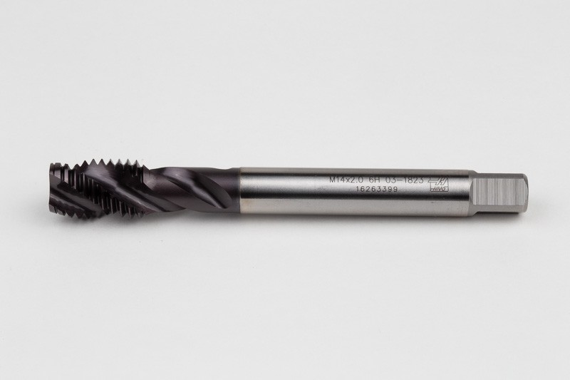

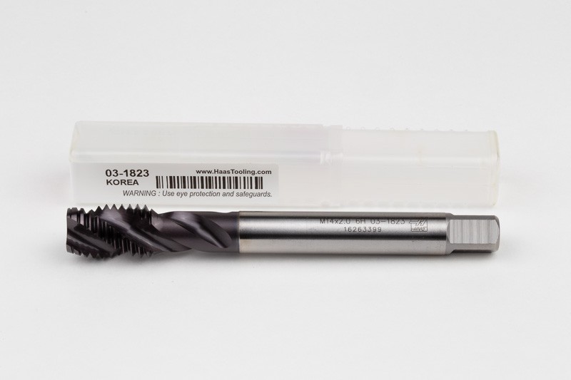

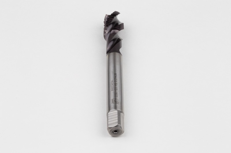

M14x2.0 M HSS-PM Spiral Flute Tap, 11mm Shank x 20mm Thread Length, 2.5XD, Mod. Bottoming, 3 Flute, 6H, TiAlN Coated
Part #: 03-1823
M14 X 2 SP FL TI & NI ALLOY TAP
Price: 49.95 ( / unit)
Price: 673.95 ( / unit)
Price: 200.95 ( / unit)
Price: 26.95 ( / unit)
Price: 121.95 ( / unit)
Price: 282.95 ( / unit)
39.97
  • SPEEDS & FEEDS (INCH)
  • SPEEDS & FEEDS (METRIC)
ISO MATERIAL CHART
Thread Series M - Metric
Thread Size M14x2.0
Primary Workpiece Material S - High Temp Alloys, P - Steel
Tap Type Spiral Flute
Shank Type Square
Material HSS-PM
Coating TiAlN
[TP] Thread Pitch 2.0 mm
Tap Drill Diameter 12.0 mm
[ØDC] Cutting Diameter 14.0 mm
[ØDMM] Shank Diameter 11.0 mm
[L2] Chamfer Length 2P - 3P
[L1] Thread Length 20.0 mm
[LU] Usable Length 44.0 mm
[OAL] Overall Length 110.0 mm
[SS] Square Size 9.0 mm
[NOF] Number of Flutes 3
[FHA°] Helix Angle 40
Length / Diameter 2.5 X D
Thread Class 6H
Through Spindle Coolant No
Weight 0.2 lbs \ 0.1 kg
