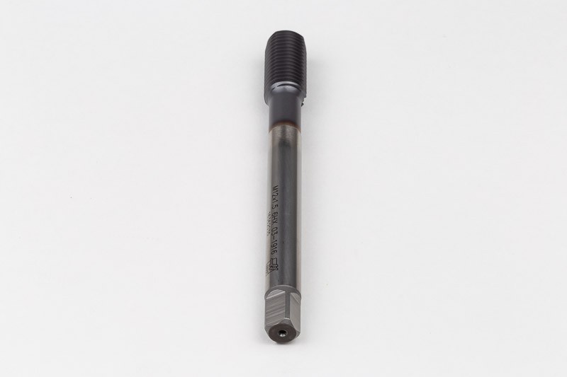

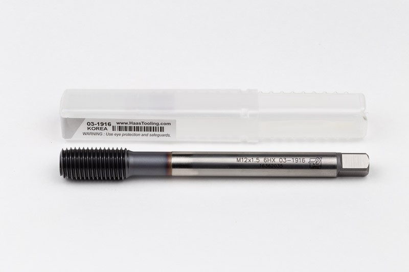

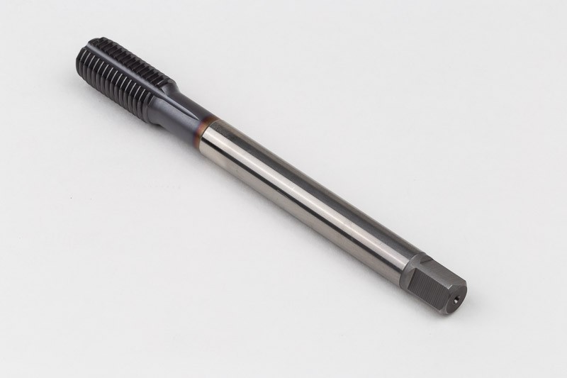

M12x1.5 MF HSS-PM Roll Tap, 9mm Shank x 22mm Thread Length, 3XD, Mod. Bottoming, 6HX, TiCN Coated
Part #: 03-1916
M12 X 1.5 ROLL TAP BTM 6HX T-15
Price: 52.95 ( / unit)
Price: 848.95 ( / unit)
Price: 252.95 ( / unit)
Price: 33.95 ( / unit)
Price: 152.95 ( / unit)
Price: 356.95 ( / unit)
39.97
774.97
230.97
30.97
139.97
325.97
  • Roll Tap Size Chart
ISO MATERIAL CHART
Thread Series MF - Metric Fine
Thread Size M12x1.5
Primary Workpiece Material M - Stainless Steel, N - Aluminum, P - Steel
Tap Type Roll Tap
Shank Type Square
Material HSS-PM
Coating TiCN
[TP] Thread Pitch 1.5 mm
Tap Drill Diameter 11.25 mm
[ØDC] Cutting Diameter 12.0 mm
[ØDMM] Shank Diameter 9.0 mm
[L2] Chamfer Length 2P - 3P
[L1] Thread Length 22.0 mm
[LU] Usable Length 40.0 mm
[OAL] Overall Length 110.0 mm
[SS] Square Size 7.0 mm
[FHA°] Helix Angle 0
Length / Diameter 3 X D
Thread Class 6HX
Through Spindle Coolant No
