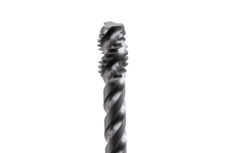

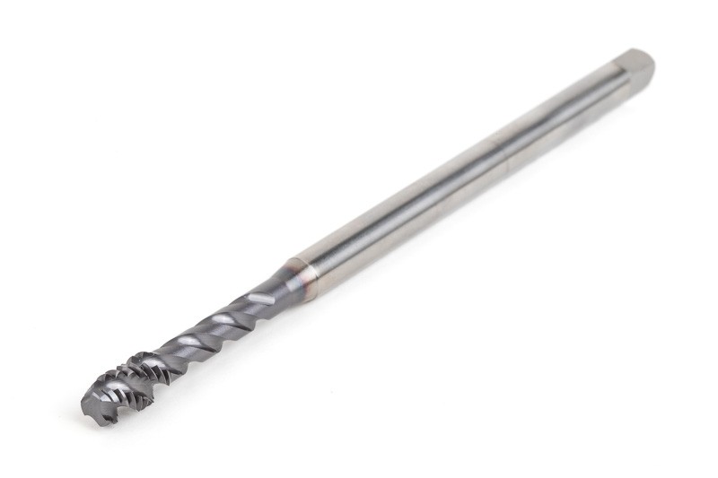

5/16"-18 UNC HSS-E Spiral Flute Ext. Tap, 0.318" Shank x 0.445" Thread Length, 2.5XD, Mod. Bottoming, 3 Flute, H4, TiCN Coated
Part #: 03-2110
TAP 5/16-18 6" H4 SF MM TICN
Price: 29.95 ( / unit)
23.97
ISO MATERIAL CHART
Thread Size 5/16"-18
Primary Workpiece Material N - Aluminum, M - Stainless Steel, P - Steel
Tap Type Spiral Flute
Shank Type Square
Material HSS-E
Coating TiCN
[TPI] Threads per Inch 18 tpi
Tap Drill Diameter 0.26 in
[ØDC] Cutting Diameter 0.3125 in
[ØDMM] Shank Diameter 0.318 in
[L2] Chamfer Length 2P - 3P
[L1] Thread Length 0.445 in
[LU] Usable Length 1.689 in
[OAL] Overall Length 6.0 in
[SS] Square Size 0.238 in
[NOF] Number of Flutes 3
[FHA°] Helix Angle 40
Length / Diameter 2.5 X D
Thread Class H4
Through Spindle Coolant No
