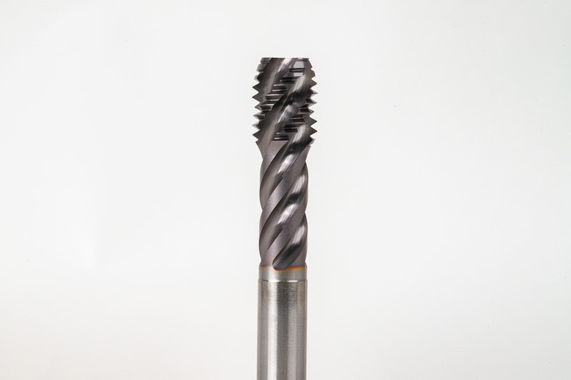

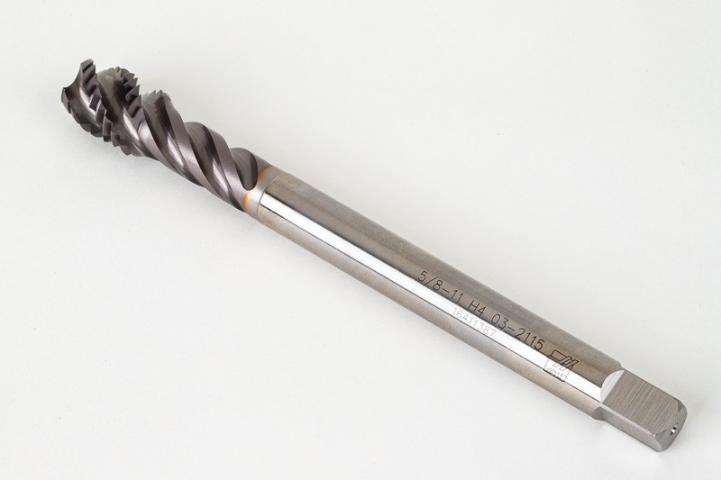

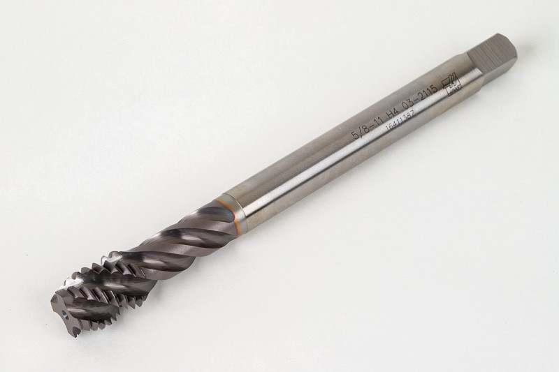

5/8"-11 UNC HSS-E Spiral Flute Ext. Tap, 0.48" Shank x 0.728" Thread Length, 2.5XD, Mod. Bottoming, 4 Flute, H4, TiCN Coated
Part #: 03-2115
TAP 5/8-11 6" H4 SF MM TICN
Price: $72.95 ( / unit)
$51.97
ISO MATERIAL CHART
Thread Size 5/8"-11
Primary Workpiece Material M - Stainless Steel, P - Steel, N - Aluminum
Tap Type Spiral Flute
Shank Type Square
Material HSS-E
Coating TiCN
[TPI] Threads per Inch 11 tpi
Tap Drill Diameter 0.531 in
[ØDC] Cutting Diameter 0.625 in
[ØDMM] Shank Diameter 0.48 in
[L2] Chamfer Length 2P - 3P
[L1] Thread Length 0.728 in
[LU] Usable Length 2.126 in
[OAL] Overall Length 6.0 in
[SS] Square Size 0.36 in
[NOF] Number of Flutes 4
[FHA°] Helix Angle 40
Length / Diameter 2.5 X D
Thread Class H4
Through Spindle Coolant No
Weight 0.3 lbs \ 0.1 kg
