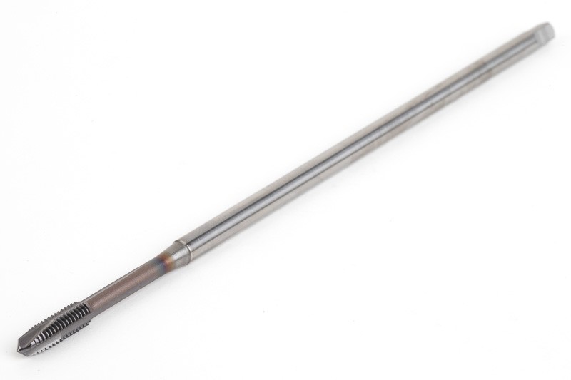

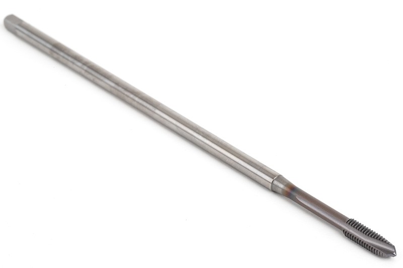

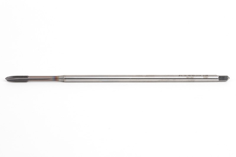

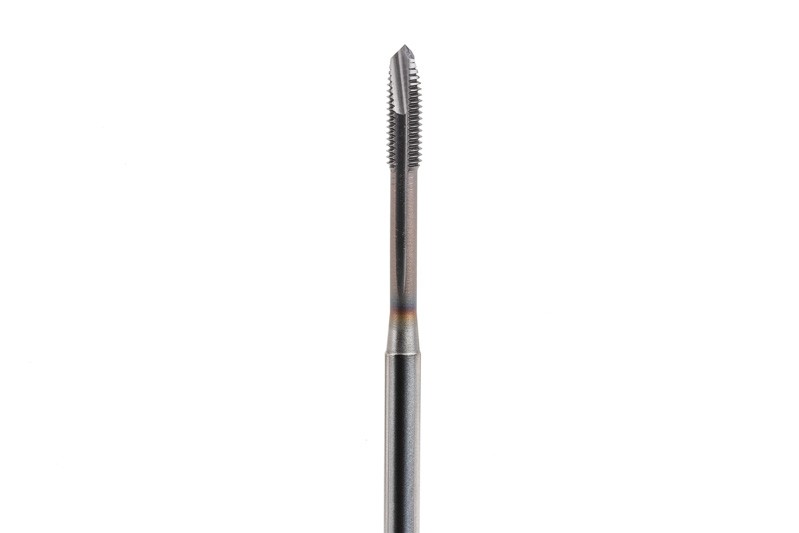

#10-32 UNF HSS-E Spiral Point Ext. Tap, 0.194" Shank x 0.492" Thread Length, 3XD, Plug, 3 Flute, H5, TiCN Coated
Part #: 03-2124
TAP 10-32 6" H5 SP MM TICN
Price: 25.95 ( / unit)
19.97
ISO MATERIAL CHART
Thread Series UNF - Unified Natl. Fine
Thread Size #10-32
Primary Workpiece Material N - Aluminum, M - Stainless Steel, P - Steel
Tap Type Spiral Point
Chamfer Type Plug
Shank Type Square
Material HSS-E
Coating TiCN
[TPI] Threads per Inch 32 tpi
Tap Drill Diameter 0.161 in
[ØDC] Cutting Diameter 0.19 in
[ØDMM] Shank Diameter 0.194 in
[L2] Chamfer Length 4P - 5P
[L1] Thread Length 0.492 in
[LU] Usable Length 1.303 in
[OAL] Overall Length 6.0 in
[SS] Square Size 0.152 in
[NOF] Number of Flutes 3
[FHA°] Helix Angle 0
Length / Diameter 3 X D
Thread Class H5
Through Spindle Coolant No
