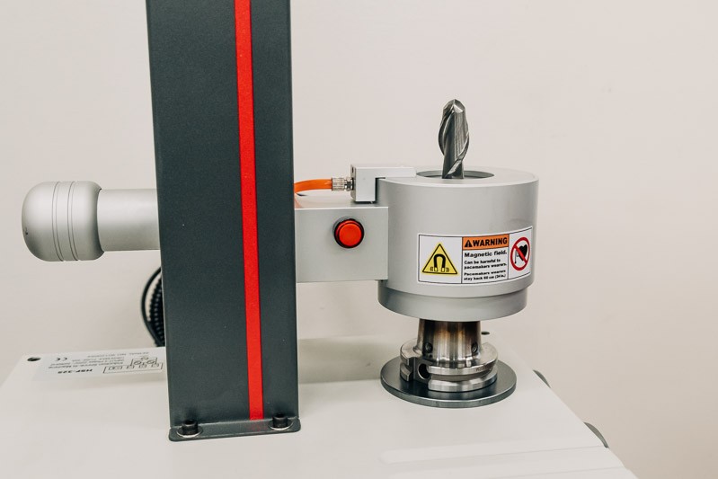

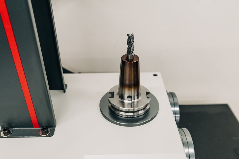

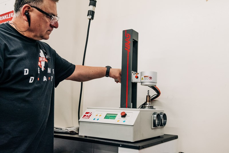

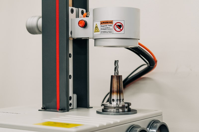

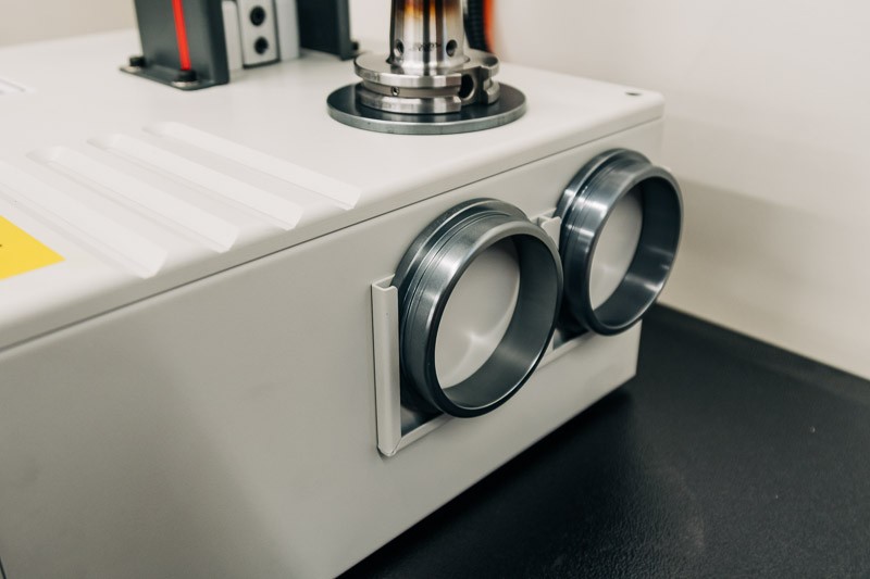

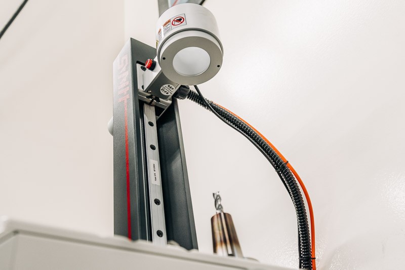

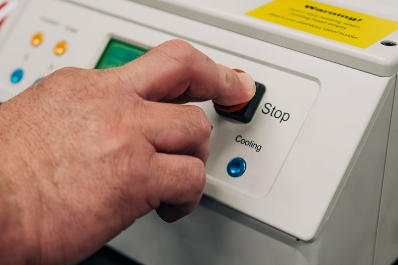

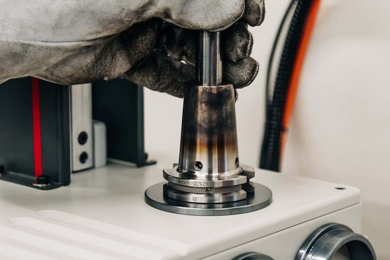

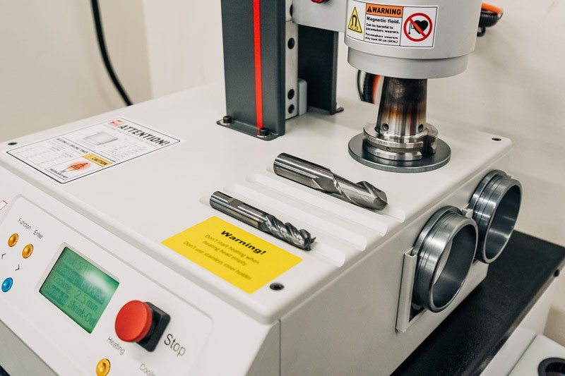

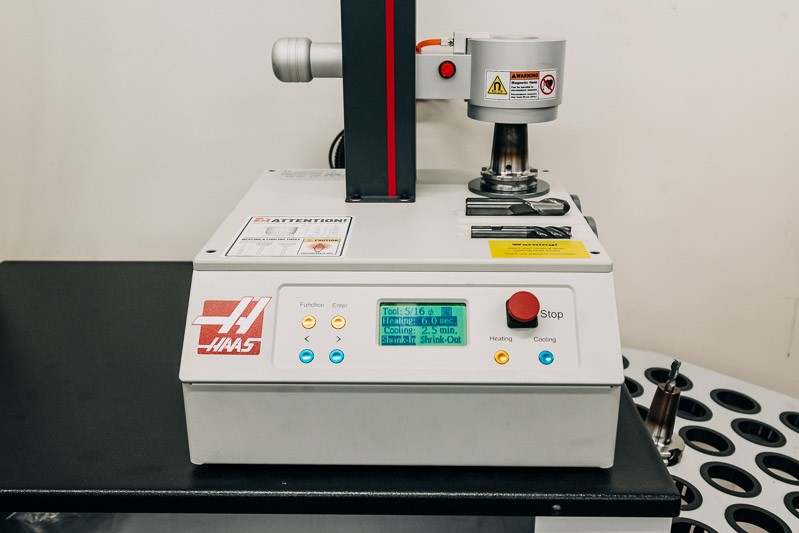

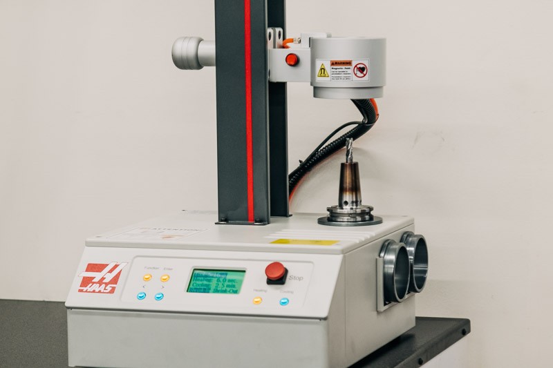

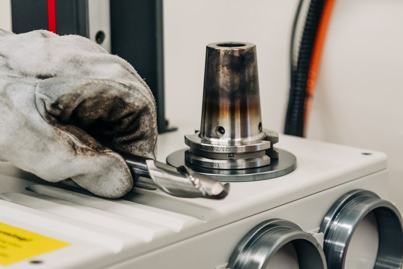

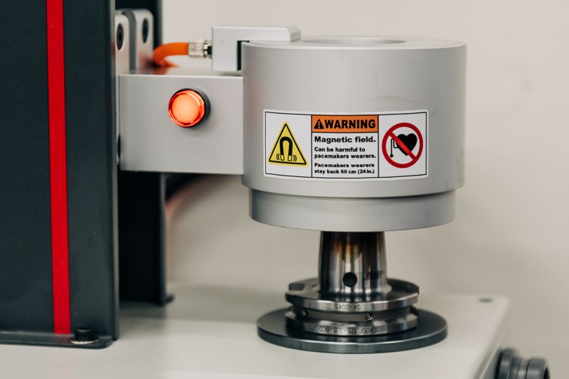

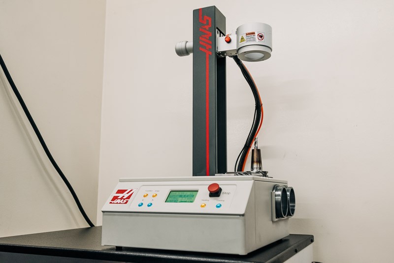

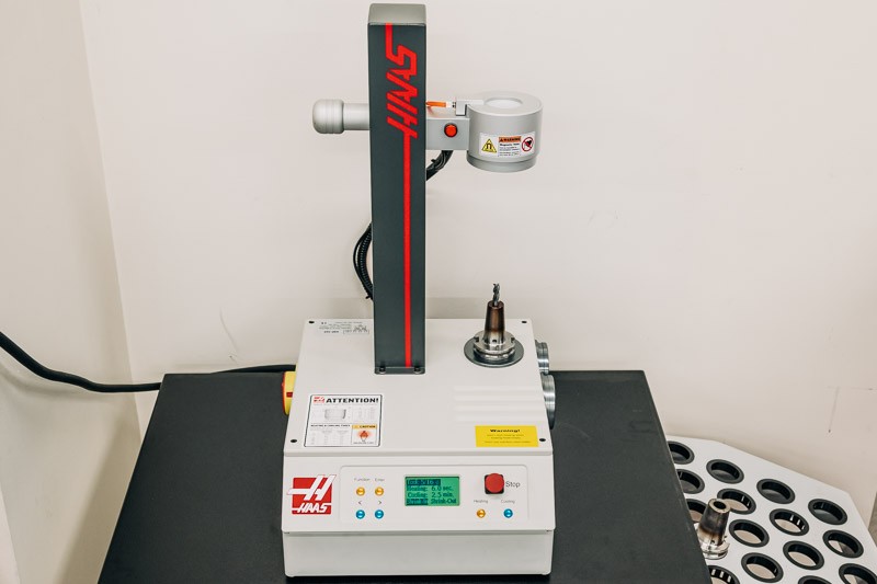

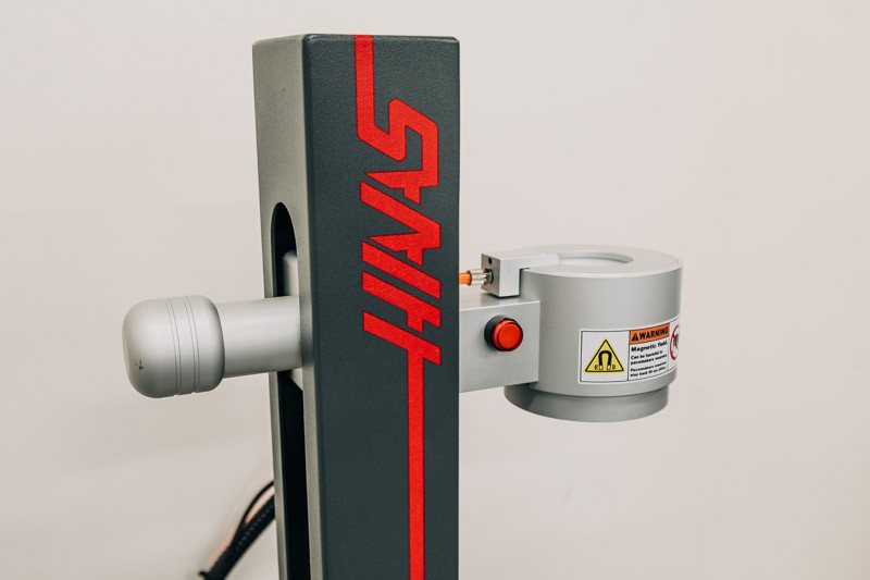

  • Interchangeable tool sleeves are easy to change when heating different taper toolholders
  • Fast heating – the eddy current induces heat from the high-frequency magnetic field, for short cycle times and easy operation
  • Higher efficiency – the process is timed to apply enough heat to the toolholder to remove cutting tools, without overheating
  • Cooling unit uses shop air for ease of connectivity and use
  • Clamping range for tool diameters 10 mm to 32 mm
  • Haas shrink-fit holders are available in a wide range of diameters
  • 12-month parts warranty from ship date, supported by your local Haas Factory Outlet; on-site installation, training, service labor, and travel charges will apply
  Benefits of Shrink Fit Tooling
  • Very low runout (< 0.0025mm TIR)
  • Very accurate
  • Very high grip force
  • Small nose diameters for better part access
  • Quick tool changeovers
  • Low maintenance
Applications
  • High-volume production
  • High-accuracy machining
  • High spindle speeds and feedrates
  • Long-reach applications
  • Better part access for 5-axis machining
Due to continuous product improvement, specifications may be subject to change without notice, and actual product appearance may differ.
Type Shrink Fit
Taper ISO40, ISO50, ISO30
Country of Origin Taiwan
Technical Specifications
HSF-325 Height [A] 26.50 in \ 675.00 mm
HSF-325 Length [B] 15.00 in \ 380.00 mm
HSF-325 Width [C] 16.00 in \ 405.00 mm
Table Height [D] 36.0 in \ 915.0 mm
Table Overall Length [E] 49.5 in \ 1257.0 mm
Table Top Length [F] 36.0 in \ 915.0 mm
Table Top Width [G] 24.0 in \ 610.0 mm
Induction Head ID 1.375 in \ 35.00 mm
Heating Range Min 0.393 in \ 10.00 mm
Heating Range Max 1.000 in \ 25.00 mm
Heating Process Induction
Shrinking Period 3-5 Seconds
Cooling Process Shop air attached to head
Cooling Air Pressure Range 2-5kgf/cm³
Cooling Period up to 10 minutes
Power Supply 400 AC 50/60HZ, 3 phase + ground terminal
Max Power Consumption 10,000 Watts
Rated Amps 30A
Display Type LCD
Holder Support HSK50/HSK63/HSK80/BT40/BT50(OPTION)
Included Accessories a. 3 Tool adapters (holder supports)
b. 8 pieces tool pick springs: 4mm×2, 6mm×2,                  8mm×2, 10mm×2
c. Power input cable, 2 meters
d. User’s manual
Optional Accessories a. Table (09-0042)
Shipping Weight 58lb \ 26kg
Shipping Dimensions Inches (L x W x H) 20" x 23" x 15"
Shipping Dimensions mm (L x W x H) 508 x 584 x 381mm
Country Of Origin Taiwan
