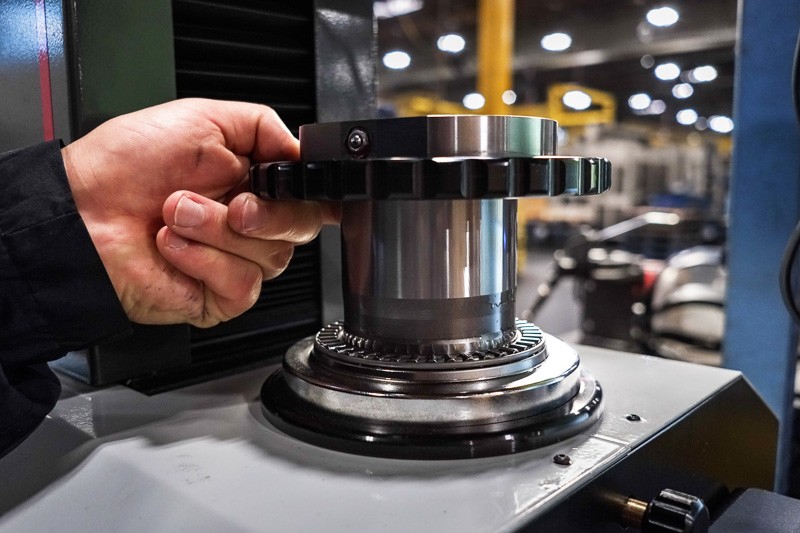

  • Interchangeable Between 30, 40, 50, and HSK63A Taper Sleeves

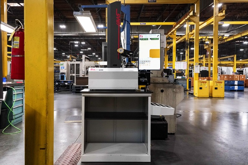

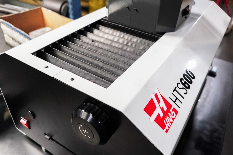

HTS600
  • Maximum X-Axis Travel: 15.748” (400 mm)
  • Maximum Z-Axis Travel: 23.622” (600 mm)
  • 10,000 Tool Memory
  • 100 Machine Origins

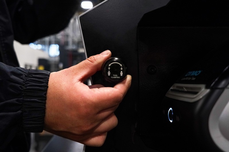

  • Pneumatic Axis Clamping
  • Pneumatic Tool Interlocking System
  • Standard 40 Taper Tool Sleeve
  • 22” Monitor
  • Table-top Unit

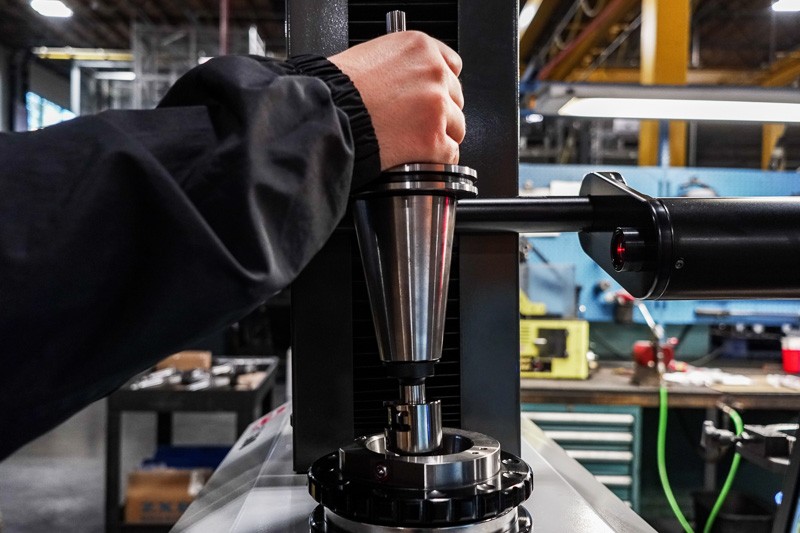

Never make a mistake when manually typing in an offset value again . . . and don’t pay extra for the convenience.

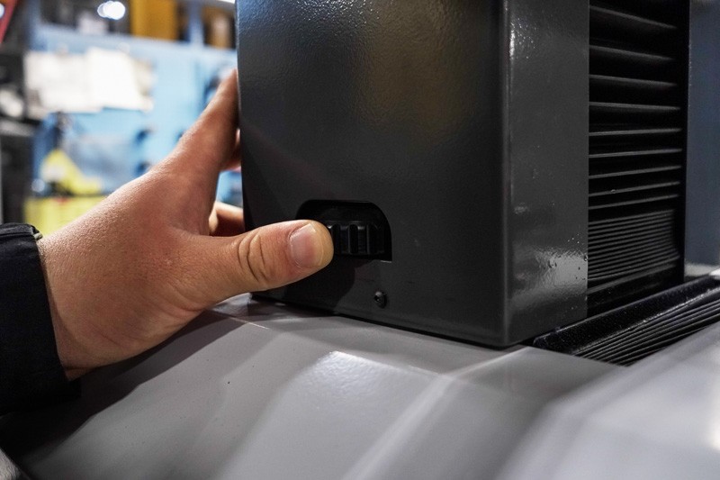

The Haas HTS600 now features an updated pneumatic X- & Z-axis clamping system that consistently and reliably locks both axes in place, enhancing the overall precision of the unit during measurement. Even when working with taller tools, the perfect balance of the support column allows for smooth movement throughout the travel, with minimal effort.
The Haas HTS600 Tool Presetter comes complete with a high-precision 40-taper tool sleeve capable of holding CT40, BT40, SK40, DIN40, etc. Take full advantage of the precision ground spindle taper sleeve by utilizing the pull stud attachment along with the pneumatic system to create a wringing effect between the taper sleeve and the taper of the tool holder. When the tool holder is clamped down correctly, the wringing effect reduces errors related to parallax, misalignment, or positioning of surfaces ensuring that the measurement taken is as close to the true value as possible. Optional interchangeable tool sleeves include 30, 50, and HSK63A tapers that can be purchased separately. Each tool sleeve has a reference notch for ease of calibration.
The package also includes a heavy-duty table with storage shelf, and a tool tray capable of holding eighteen 40-taper toolholders.
The HTS600 connects to your local area network (LAN), and the built-in software includes post-processors for Classic and Next Generation Haas controls, as well as dozens of other control types. The Haas post-processors format the tool measurement data into files that can be transferred to the Haas machine over the network, or written to a USB memory device to load directly into a machine control.
However, the preferred method is to use the provided thermal printer and the Haas industrial data matrix scanner. The HTS600 package includes everything you need to print a label for each tool, with offset data imbedded in a data matrix code, similar to a QR code.
The HTS600 software formats the measured tool data and other tool information into a data matrix code. The connected thermal printer then prints a label for each tool. Use the Tool File Wizard or the Tool Scan Wizard feature on Haas NGC controls (software version 100.20.000.1200 or later) and the included wireless industrial data matrix scanner to scan the tool data from each label, and update the tool offsets in the control as each tool is being loaded into the Haas machine.
The Haas Wireless Industrial Data Matrix Scanner uses 2.4GHz wireless operation utilizing a USB receiver. It also comes with a USB cable for wired connection to the Haas control, and for recharging the built-in 2000mAh battery.
The included thermal printer prints the tool data to the provided labels as a data matrix code, with the information embedded. Direct thermal printing eliminates the need for costly ink or toner, and provides professional quality prints at 300 x 600 dpi. Printing is fast and efficient, and utilizes standard DYMO brand labels.
The Haas HTS600 is a fully equipped, sturdy, and easy-to-use tool presetter at an amazing price. With its user-friendly Windows-based operating system, measuring tool geometry and getting the values into your Haas CNC are easy and intuitive.

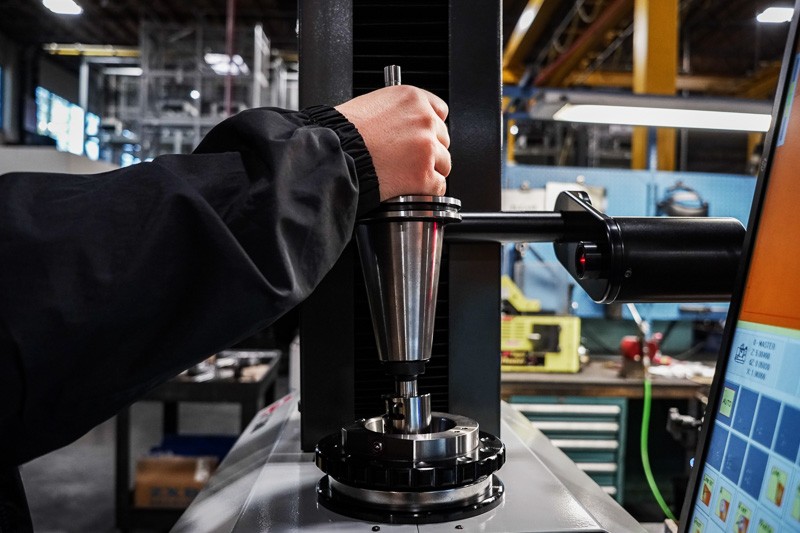

The HTS600 is a complete tool presetting solution that includes everything you need to start dramatically reducing your setup times – right out of the box. The Haas Tool Presetter moves the tool measurement function out of your machine – so it can continue making chips (and money) – and into the shop, where the hourly rate is lower.
