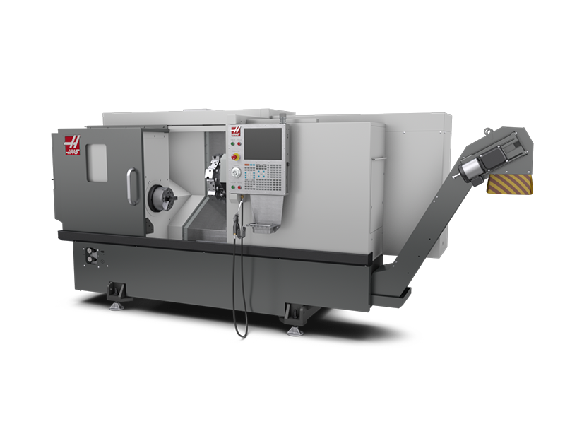

Y-Axis CNC Lathe with 11" x 32.5" max capacity and 1.75" bar capacity
The ST-10LY-EU is a specially configured version of our long-bed ST-10LY that we’re offering to the European market, at a special price. It provides double the Z-axis travel and turning length of the standard ST-10Y for machining longer parts, while maintaining superior cutting performance, and a compact footprint.
INCLUDED OPTIONS:
  ✓ 6000-rpm Live Tooling Upgrade
  ✓ Automatic Tool Presetter
  ✓ Belt-Type Chip Conveyor
  • 12-Station BMT45 turret
  • Extended Z-axis travel for machining longer parts
  • Standard manual tailstock with hydraulic quill
  • Extended tool pocket in the bulkhead provides clearance for long tools
  • Ideal for high-volume, high-production environments
THIS MODEL IS ONLY AVAILABLE IN EUROPE
See Available Stock
Current Lead Time
  • 6.5" Chuck Size
  • 1.75" Bar Capacity
  • 6k RPM
  • 15 hp Power

Standard Features
  • 6000-rpm Spindle
  • 6000-rpm Speed Upgrade for Live Tooling
  • 4000-rpm Live Tooling with 12-Station BMT45 Turret and C Axis
  • Automatic Tool Presetter
  • Variable Flow Coolant
  • Belt-Type Chip Conveyor, Lathe
  • 30-Gallon Coolant Tank
  • Control Widescreen Monitor
  • Ethernet Interface
  • WiFi Connection for the Haas Control
  • Power Surge Protection
  • Early Power-Failure Detection Module
  • Advanced Tool Management
  • Media Display M-Code; M130
  • HaasConnect: Remote monitoring
  • HaasDrop
  • Visual Part Programming System
  • Rigid Tapping
  • Spindle Orientation
  • User-Definable Macros
  • Standard Program Memory, 1 GB
  • Stainless Steel Way Covers
  • Phone Charging Stand
  • BMT45 Driven Toolholder Kit
  • BMT45 Metric Standard Toolholder Kit
  • Manual Tailstock with Hydraulic Quill
  • 6.5" Hydraulic Chuck, A2-5

Capacities S.A.E METRIC
Chuck Size 6.5 in 165 mm
Max Part Swing 16.5 in 419 mm
Max Cutting Diameter (with BMT45 turret) 11.00 in 279 mm
Max Cutting Length (varies with workholding) 32.5 in 826 mm
Bar Capacity 1.75 in 44 mm
Travels S.A.E METRIC
X Axis 7.88 in 200 mm
Y Axis ± 2.0 in ± 51 mm
Z Axis 32.50 in 826 mm
Feedrates S.A.E METRIC
Rapids on X 472 ipm 12.0 m/min
Rapids on Y 472 ipm 12.0 m/min
Rapids on Z 1200 ipm 30.5 m/min
Axis Motors S.A.E METRIC
Max Thrust X 2400 lbf 10676 N
Max Thrust Y 2300 lbf 10231 N
Max Thrust Z 3700 lbf 16458 N
Spindle S.A.E METRIC
Spindle Nose A2-5 A2-5
Max Rating 15.0 hp 11.2 kW
Max Speed 6000 rpm 6000 rpm
Max Torque 75.0 ft-lbf @ 1300 rpm 102.0 Nm @ 1300 rpm
Draw Tube Bore ø 1.8 in 46 mm
Spindle Bore ø 2.31 in 58.7 mm
Main Spindle C Axis S.A.E METRIC
Max Speed 60 rpm 60 rpm
Positioning (±) 0.02 ° 0.02 °
Brake Diameter 9.5 in 241 mm
Brake Holding Torque 140 ft-lbf 190 Nm
Control Type Interpolated Motion and Positioning Interpolated Motion and Positioning
Sub-Spindle S.A.E METRIC
Chuck Size 5.3 in 135 mm
Max Sync Speed w/Main Spindle 4800 rpm 4800 rpm
Chuck Throat Ø 1.30 in x 1.37 in DEEP Ø 33.0 mm x 34.8 mm DEEP
Drawbar Bore (NON-THROUGH) Ø 1.00 in x 4.50 in DEEP Ø 25.4 mm x 114.3 mm DEEP
Spindle Bore (without chuck and drawbar installed) 1.50 in 38.1 mm
Integrated Brake Torque 17 ft-lbf 23 N/m
Spindle Orientation Accuracy (Requires SO) ± 0.02 ° ± 0.02 °
Rapids (B-axis) 400 ipm 10 m/min
Tailstock S.A.E METRIC
Taper MT3 MT3
Hydraulic Quill Travel 3.8 in 95 mm
Manual Body Positioning 44.0 in 1118 mm
Max Thrust (Hyd. Quill Only) 1130 lbf 5026 N
Min Thrust (Hyd. Quill Only) 140 lbf 623 N
Turret S.A.E METRIC
Number of Tools 12 Stations 12 Stations
OD vs ID Tools Any Combination (will vary with turret) Any Combination (will vary with turret)
Boring Bar Rear Clearance (from back of turret ) 3.80 in 96.5 mm
Live Tooling S.A.E METRIC
Tooling BMT45 BMT45
General S.A.E METRIC
Coolant Capacity 30 gal 114 L
Air Requirements S.A.E METRIC
Inline Air Hose 3/8 in 3/8 in
Coupler (Air) 3/8 in 3/8 in
Spindle Speed 6000 rpm 6000 rpm
Drive System Direct Speed, Belt Drive Direct Speed, Belt Drive
Spindle Power 15.0 hp 11.2 kW
Full Load Amps (3 Phase) - Low 40 A 40 A
Domestic Pallet 158.0 in x 70.0 in x 81.0 in 401 cm x 178 cm x 206 cm
Export Pallet 158.0 in x 70.0 in x 81.0 in 401 cm x 178 cm x 206 cm
Weight 10000 lb 4536.0 kg
