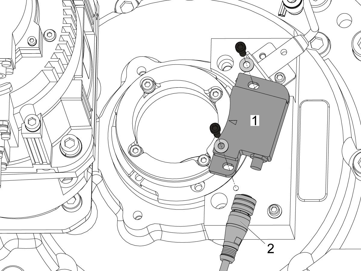

Remove the C-Axis bottom cover.

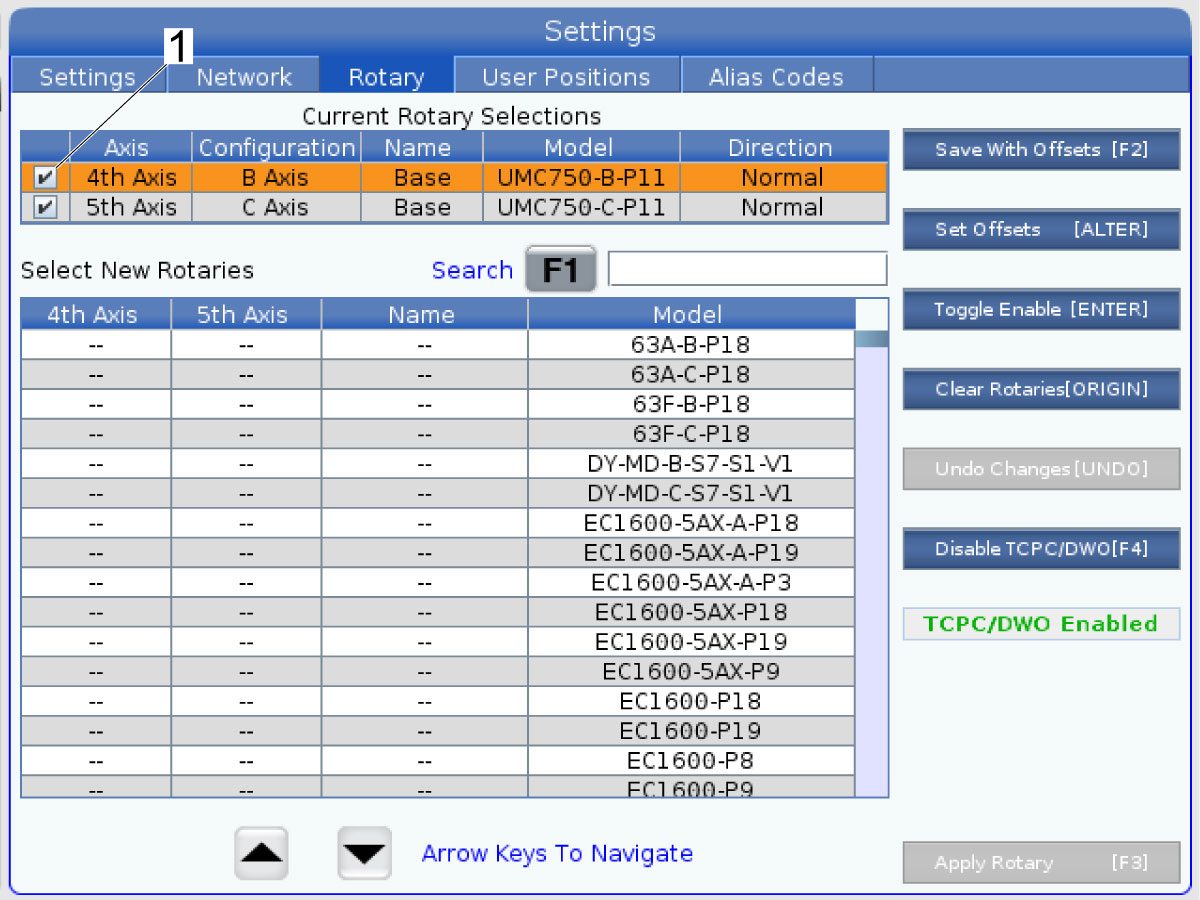

Press [SETTING].
Navigate to the Rotaty tab.
Un-Check the 4th Axis.

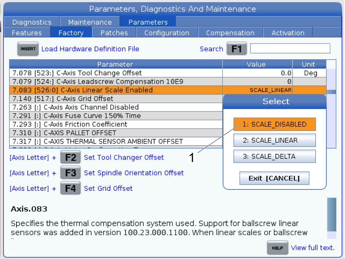

Press [DIAGNOSTIC].
Navigate to Parameters > Factory.
Set 7.083 C-Axis Linear Scale Enabled to "Scale Disabled".

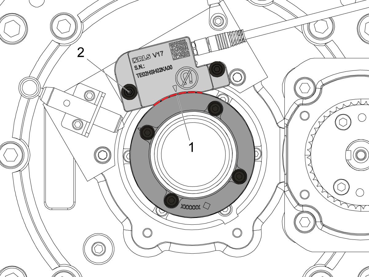

Power off the machine.

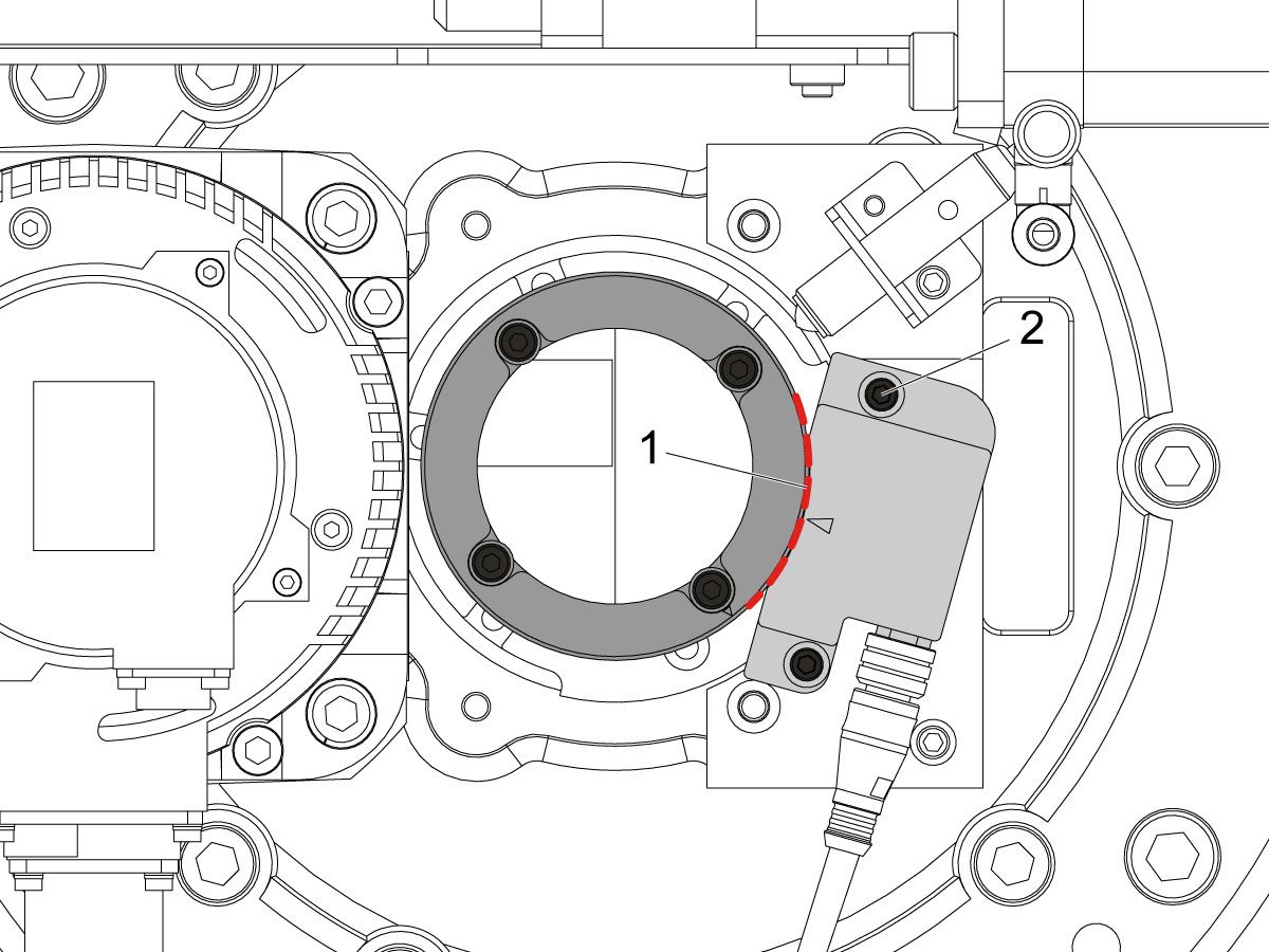

Uninstall the encoder read-head [1] by disconnecting the encoder cable [2] and removing the bolts and washers.
6
Note the Z-Pulse orientation before removing the encoder ring hub.

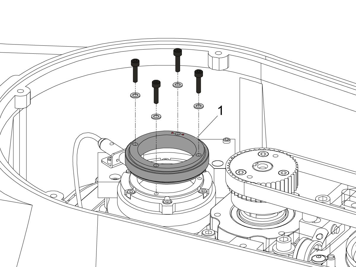

Uninstall the encoder ring hub [1] by removing the screws and washers mounting the encoder ring hub to the taper-lock.
7
Mount and loosely install the encoder ring hub [1] from the service kit with the provided hardware, SHCS 10-32 X 3/4 (x4) and WASHER #10 FLAT (x4).
Verify the Z-Pulse is in the same location as the ring that was uninstalled.
 Note: Do not torque mounting screws yet.
8
Turn on the machine.
Zero return all axis.
 Warning: Do not place the Mag Base anywhere near the Encoder.
Check and document the runout on the OD of the scale encoder ring hub using the upper-most diameter, as shown.
Adjust as necessary. TIR must be 0.0005" or less.
Torque the 4 bolts of the encoder ring hub to 30 in-lbf in the star pattern.
After torquing, double check the runout to verify the ring hub has not shifted.
9

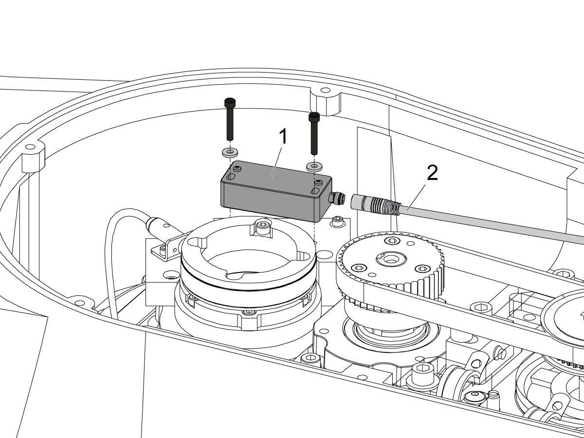

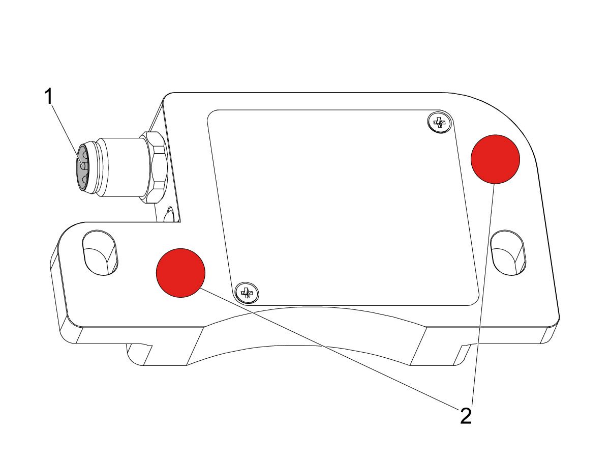

Clean the back surface of the encoder read-head and the mounting surface.
Add a small amount of silicone dielectric grease to encoder cable connection [1]. Grease should be a thin layer, but cover all the pins.
Apply two small drops of anti-oxidant (99-2130) to the mounting surface on the read head in the locations shown [2].
10
Connect the encoder cable [4] to the encoder read-head.
Insert cable by carefully lining up electrical pins with cable connector.
Install the encoder read-head [1] from the service kit with the provided hardware,  SHCS 8-32 x 1/2 bolts (x2) [2] and Washer .17ID x .4OD (2x) [3].
11
Set the gap between the scale ring and read-head as shown [1] using the appropriate mylar shim (0.008").
 Note: Do not use a metal shim.
Starting on the left side of the read-head [2], torque the two read-head mounting bolts to 20 in-lbf.
After torquing, double check the gap with the shim to verify the read-head has not shifted.
12

Press [SETTING].
Check the 4th Axis.

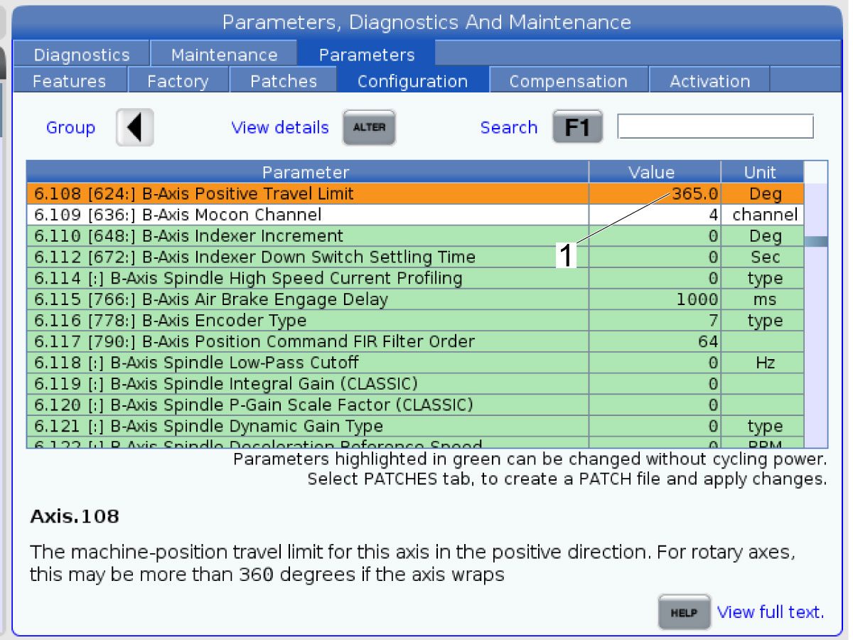

Press [DIAGNOSTIC].
Navigate to Parameters > Configuration > Axis > B > Travel Limits.
Change: 6.108 B-Axis Positive Travel Limit from 180 to 110.
15
Press [DIAGNOSTIC].
Set 7.083 C-Axis Linear Scale Enabled to "Scale Linear".
Power cycle the machine.

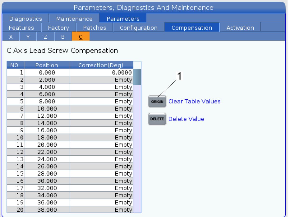

Clear the Compensation table for the C-Axis.
Press [DIAGNOSTIC].
Navigate to Parameters > Compensation > C.
Press [ORIGIN].
To update compensation table values for the C-Axis a laser calibration is required. The calculated compensation values will then be entered into the C-Axis Compensation Table.

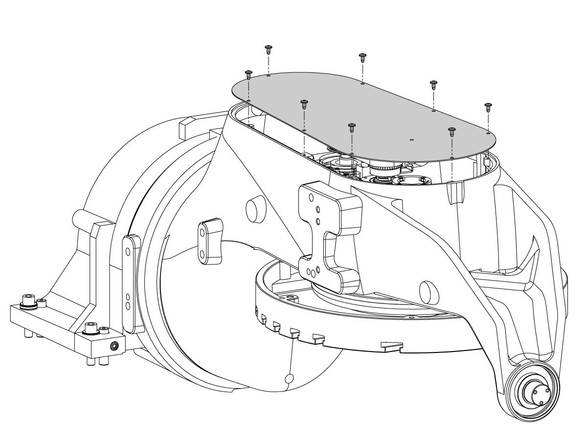

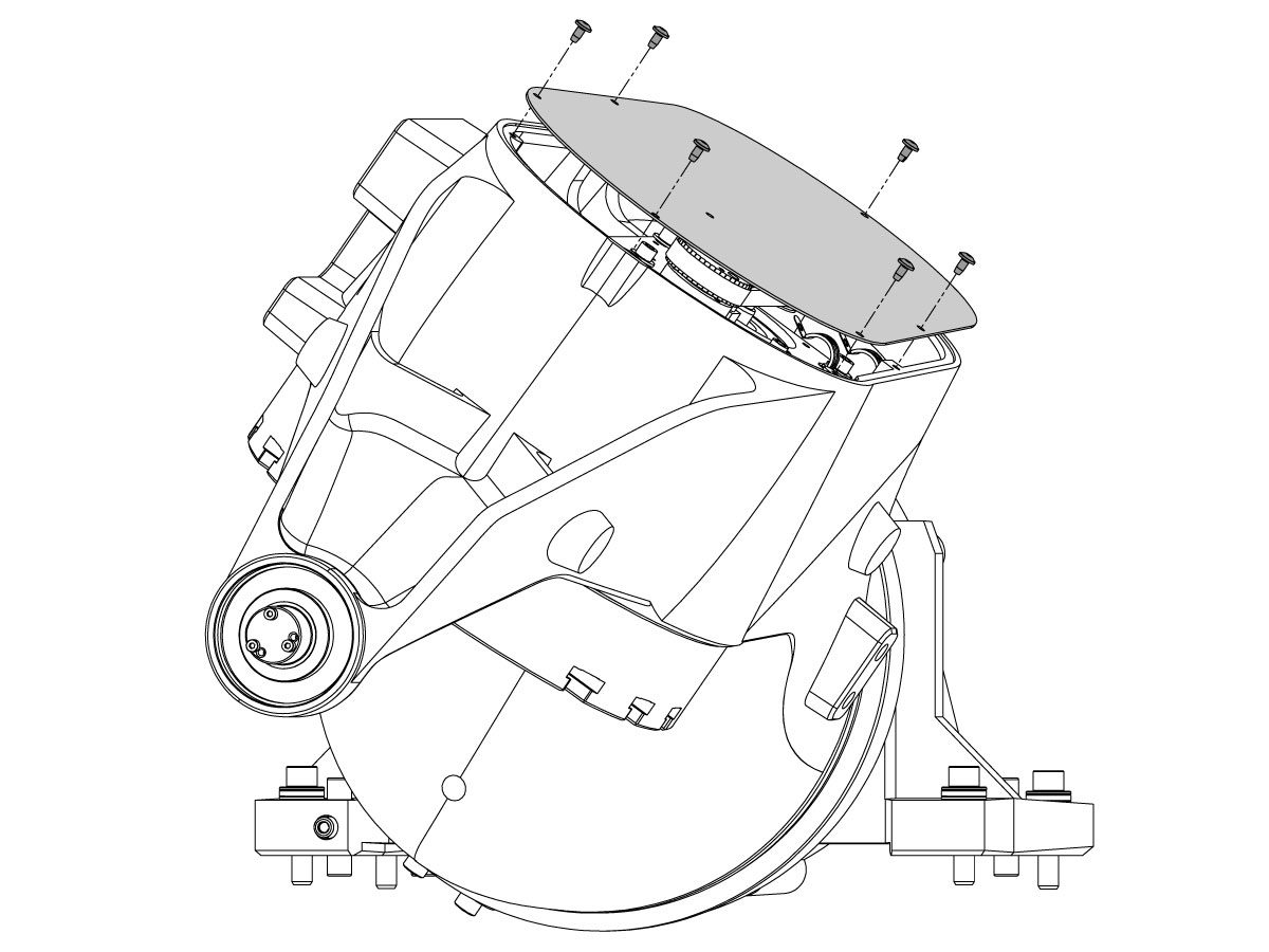

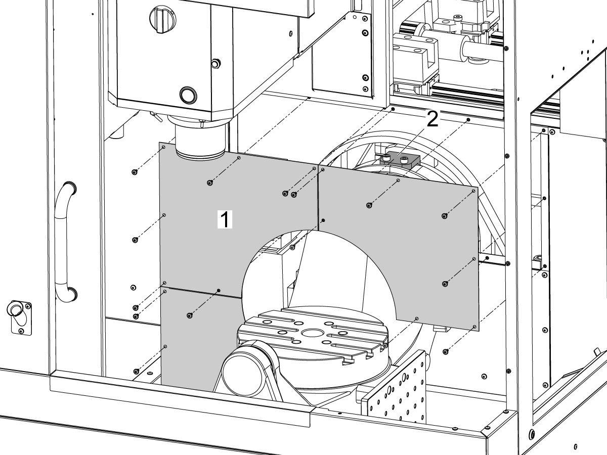

B-Axis Encoder Ring Replacement
 Note: These step apply only to the UMC-500/SS B-Axis.
: Warning: Only certified service personnel should perform this procedure. Reorientation of Z-pulse or Trip-Flag will require laser calibration to populate rotary compensation tables with new, correct, values.
Zero-return all Axis.
Press [EMERGENCY STOP].
Remove the bulkhead sheet metal [1] to access the B-Axis hard stop [2].
Rotate the B-Axis approximately 100 degrees, or until there is enough room to access the hard stop [1].
Remove the B-Axis hard stop [1].
Remove the two rear sheet metal panels [1] to access the B-Axis components.
Insert a service key and enter service mode.
Press [DIAGNOSTIC].
Navigate to Parameters > Factory > 6.021.
Change: 6.021 B-Axis Check Travel Limit from TRUE to FALSE .

Press [DIAGNOSTIC].
Set 6.083 B-Axis Linear Scale Enabled to "Scale Disabled".

9
10
11
 Note: If the Z-Pulse is in the wrong location the B-Axis will not zero return correctly and can damage the cables and hoses.

14
15
Connect the encoder cable [1] to the encoder read-head.
Install the encoder read-head [2] from the service kit with the provided hardware,  SHCS 8-32 x 1/2 bolts (x2) [4] and Washer .17ID x .4OD (2x) [3].
16

19
Press [DIAGNOSTIC].
Change: 6.021 B-Axis Check Travel Limit from FALSE to TRUE.
Rotate the B-Axis back to zero when done.
20
Press [DIAGNOSTIC].
Set 6.083 B-Axis Linear Scale Enabled to "Scale Linear".

Install the bulkhead sheet metal [1] once the B-Axis hard stop [2] has been installed.
23
Install the two rear sheet metal panels [1].

Clear the Compensation table for the B-Axis.
Press [DIAGNOSTIC].
Navigate to Parameters > Compensation > B.
Press [ORIGIN].
To update compensation table values for the B-Axis a laser calibration is required. The calculated compensation values will then be entered into the B-Axis Compensation Table.

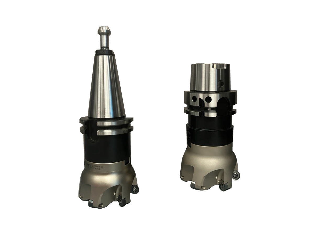

When replacing the platter on your UMC, the replacement platter will need to be re-machined to become square with the rest of the machine. The following tools and NC code are required to properly finish the platter replacement.
Required Tools Kit for Platter Replacement Based on Spindle Type Service kit number
UMC PLATTER CUTTING KIT CT40 EK-0034
UMC PLATTER CUTTING KIT BT40 EK-0035
UMC PLATTER CUTTING KIT HSK63A EK-0036
UMC PLATTER CUTTING KIT CT50 EK-0037
UMC PLATTER CUTTING KIT BT50 EK-0038

Put the shell mill listed above into Tool 1 in the machine. Set the tool length geometry offset for the shell mill using a tool setter or by using your WIPS.

Remove the rear panels of the enclosure.
Remove the rotary shields [1] thru [4] in the sequence shown.

UMC B and C Axis Rotary Scale Encoder
Inspect the B or C-axis ground cable that is attached to the encoder mount plate.  Make sure is fasten to the encoder mount plate.  Verify the other end of the cable is connected to chassis.
If the machine does not have a ground cable installed. Verify the encoder mount has [1] 8-32 UNC location for the ground screw.
Install the following  :
33-8001  GND to SP Encoder 16FT (C axis)
33-6055 GND to SP Encoder 13FT (B axis)
If needed;
20-7278A - MNT NCE/HOME SW B AXIS UMC
20-7279A - MNT NCE/HOME SW C AXIS UMC
Note: Do not loosen the read head screws, doing this will require the machine to be lazer compensated.
