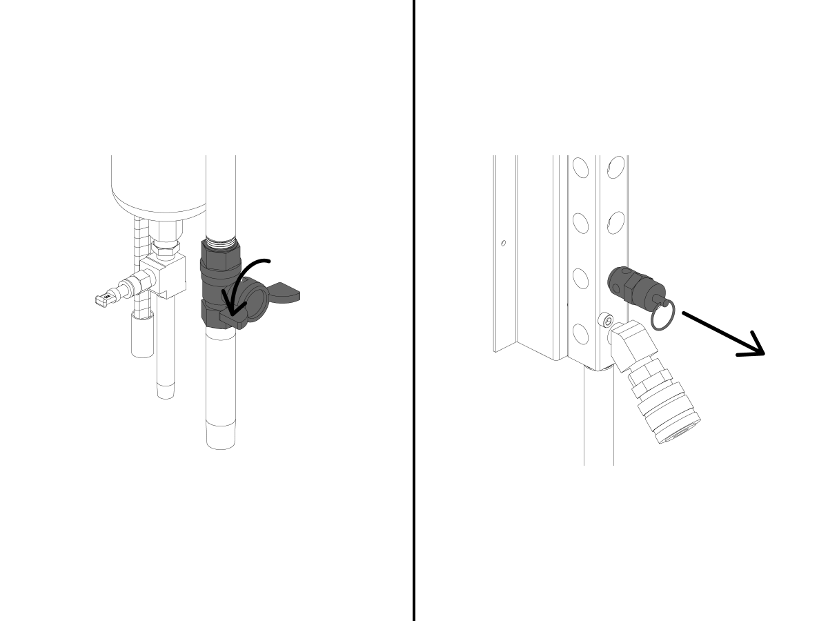

  • Rotate the ball valve shown to cut off air the machine.
Note: The wings of the valve should be perpendicular to the pipe.
  • Purge excess air pressure from the machine by pulling and holding the ring on the purge valve until you no longer hear air escaping.

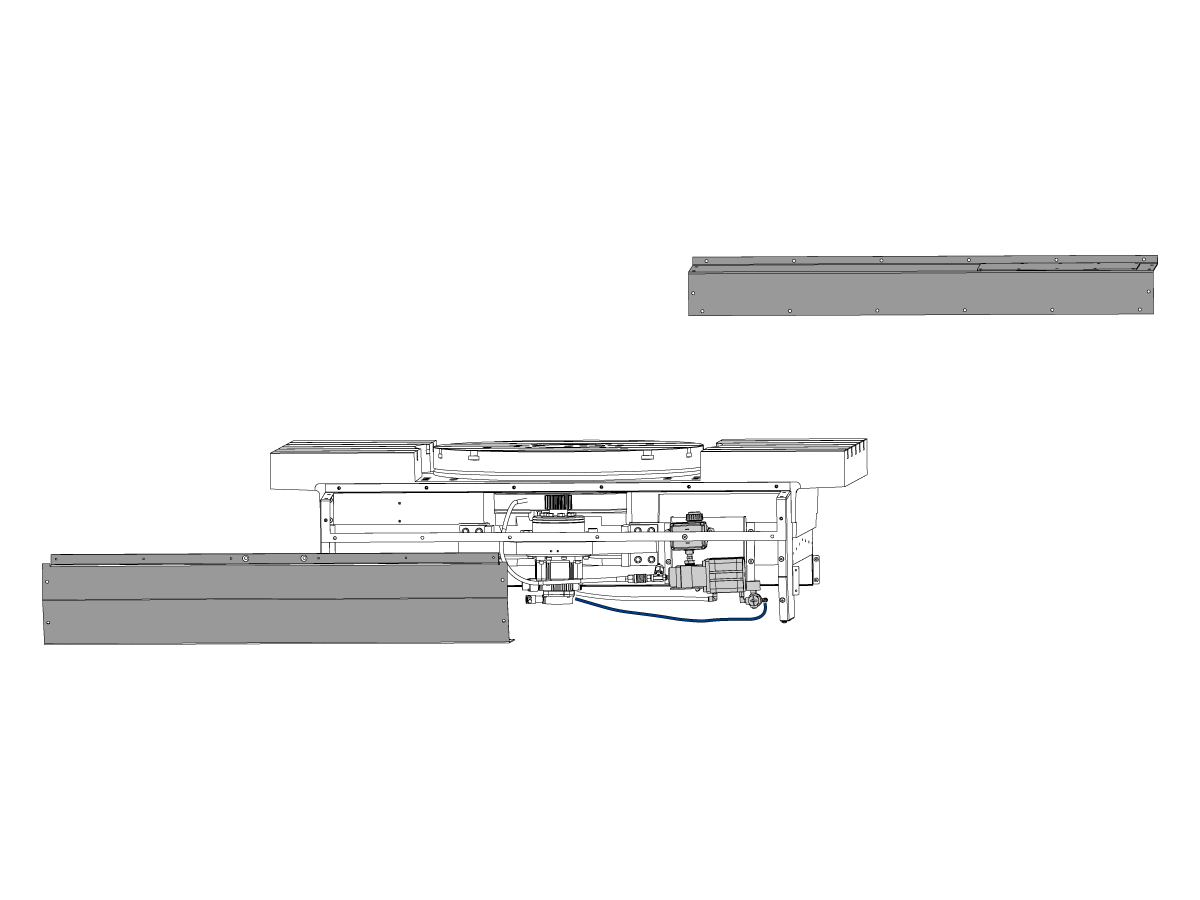

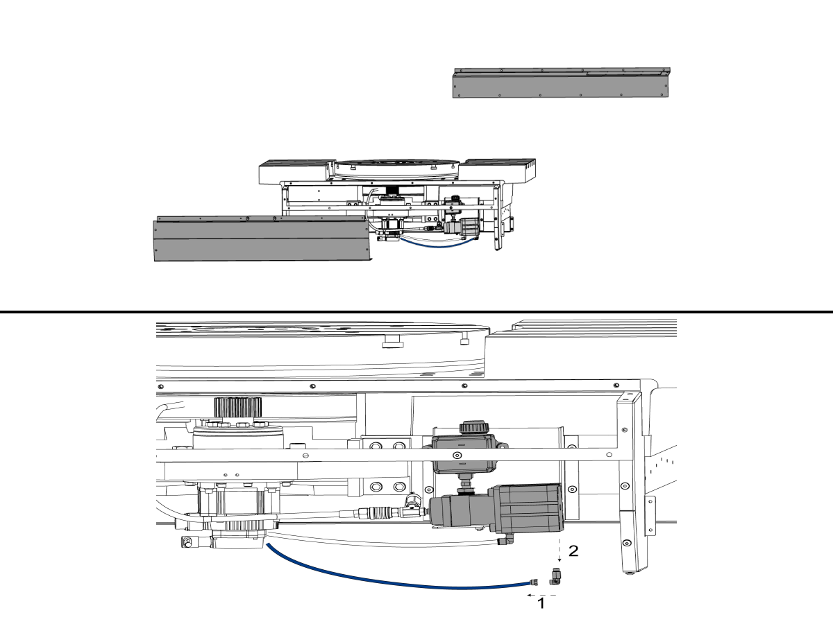

Remove the upper and lower shord cover from the front of the table to expose the brake booster.
Remove the Blue Air Line [1] from the B-Axis booster
Remove  the adapter and 90° elbow fitting [2] from both brake boosters.

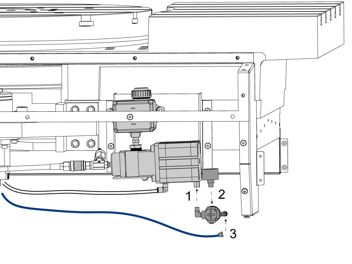

  • Brake Booster Regulator kit [1] will come with the gauge [2] removed.
  • Install Regulator kit [1] on the Brake boosters.
  • install the gauge [2] onto the regulator kit, followed by the Blue air line{3}.
Note: The fitting for Brake Retract line may need to moved for clearance when installing Regulator kit.
