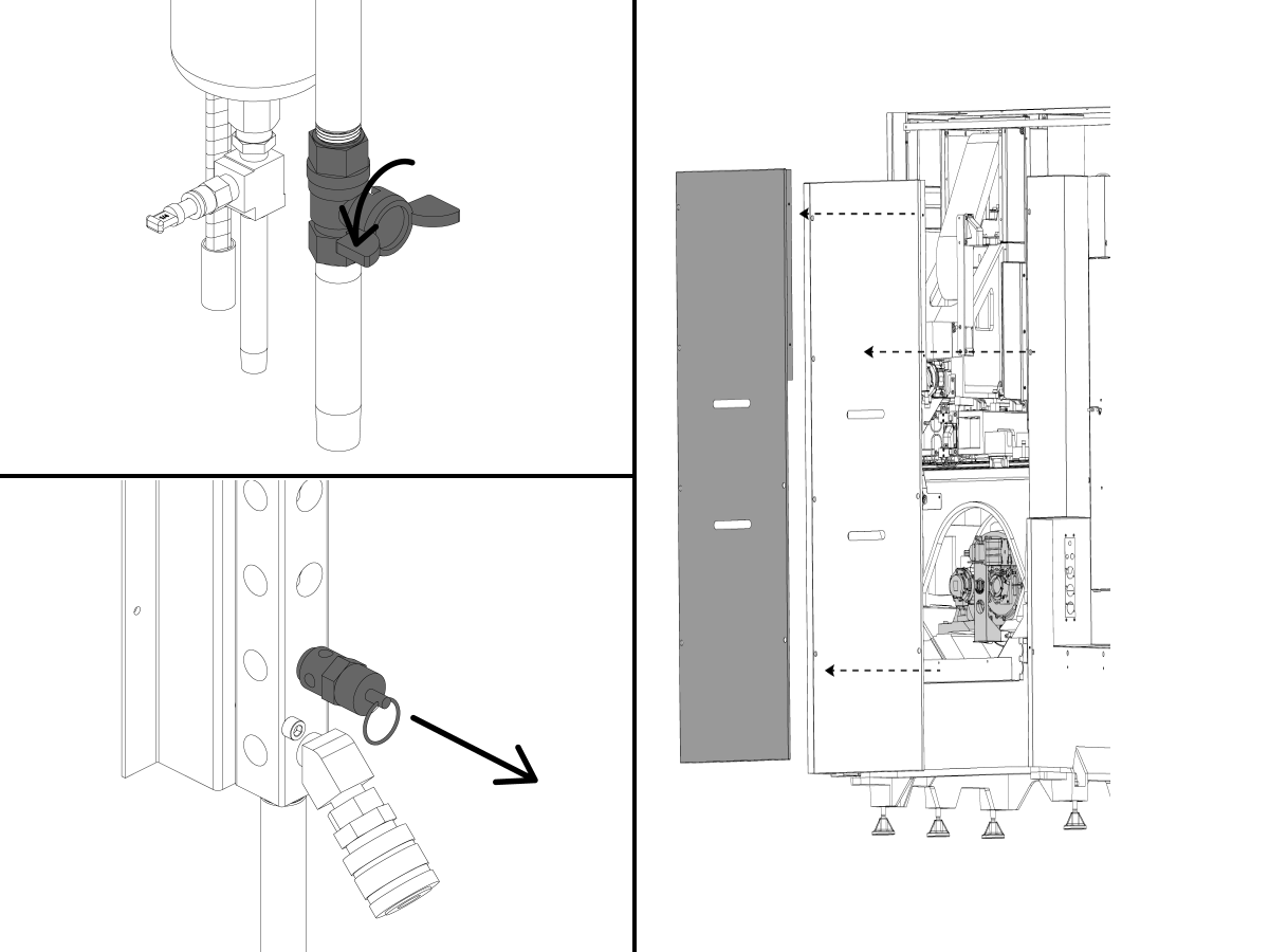

  • Press the Emergency Stop
  • Rotate the ball valve shown to cut off air the machine.
Note: The wings of the valve should be perpendicular to the pipe.

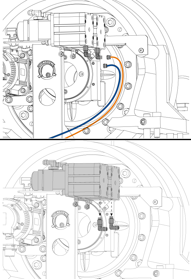

  • Remove the center rear panel to gain access to the Brake booster.
Remove the Blue Air Line from the B-Axis booster and the Orange line from the  C-Axs booster.
Remove  the adapter and 90° elbow fitting from both brake boosters.

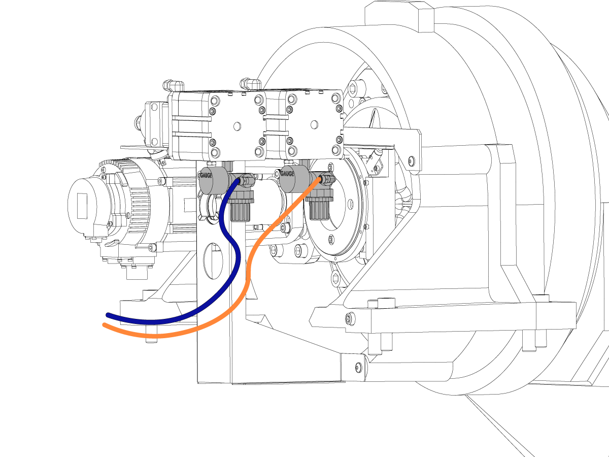

  • Brake Booster Regulator kit will be pre assembled as shown
  • Install Regulator kit on the Brake boosters
Note: The fitting for Brake Retract line may need to moved for clearance when installing Regulator kit.
Install the Blue Air Line to the B-Axis booster and the Orange line from the  C-Axis booster.
  • Rotate the ball valve shown to open air the machine
Note: The wings of the valve should be parallel to the pipe.
  • From the rear of the machine adjust the brake regulators to 70 PSI.
  • Install the rear panel
  • Release the Emergency Stop
  • Test the B and C axis brake function properly.
