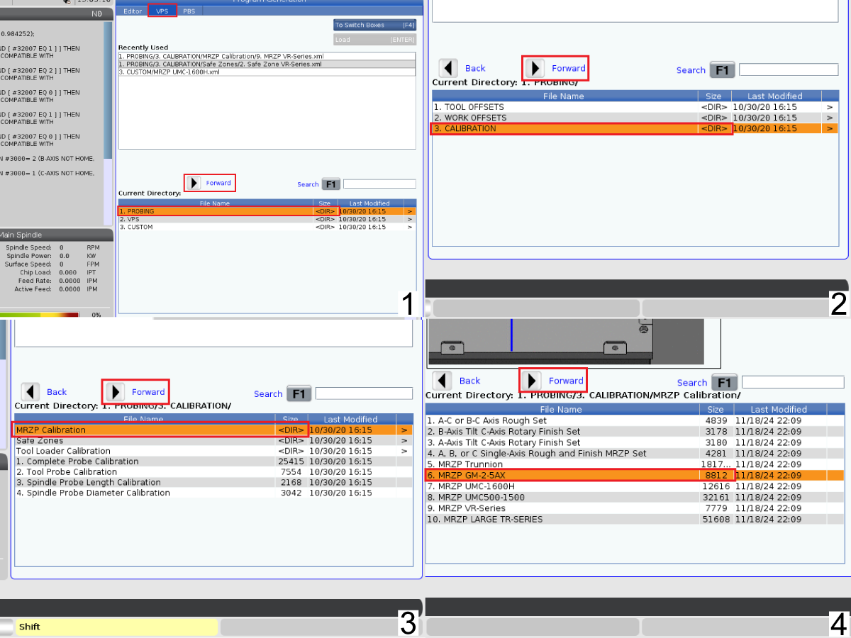

Press [EDIT] and go to the VPS tab. Once there using the direction buttons highlight  the probing directory and press [RIGHT ARROW].
Once there highlight CALIBRATION and press [RIGHT ARROW].
Highlight MRZP CALIBRATION  and press [RIGHT ARROW].
Highlight MRZP SAFE ZONE GIMBAL HEADS and press [RIGHT ARROW].
Input the ball diameter measurement and follow the probe position description at the bottom of the window.
 NOTE: With B and C-Axis at 0, the probe should be 0.25" above the sphere.
Press [F4] to populate the program to MDI and go over the program, before pressing  [CYCLE START].
or
Press [CYCLE START] to run the MRZP and Safe Zone program in MDI immediately .

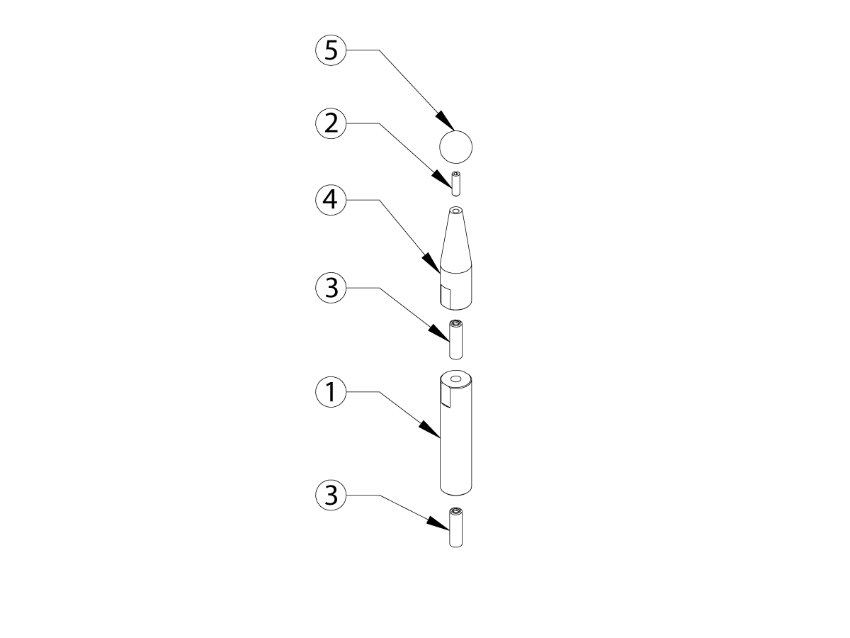

Build the MRZP tool in the configuration shown.
[1] MRZP BASE BALL MOUNT SHAFT
[2] SSS M6 X 20 CUP PT
[3] SSS 3/8-16 1 1/4  CUPT PT
[4] PROBE BALL MOUNT SHAFT
[5] PROBE BALL MRZP
Updated

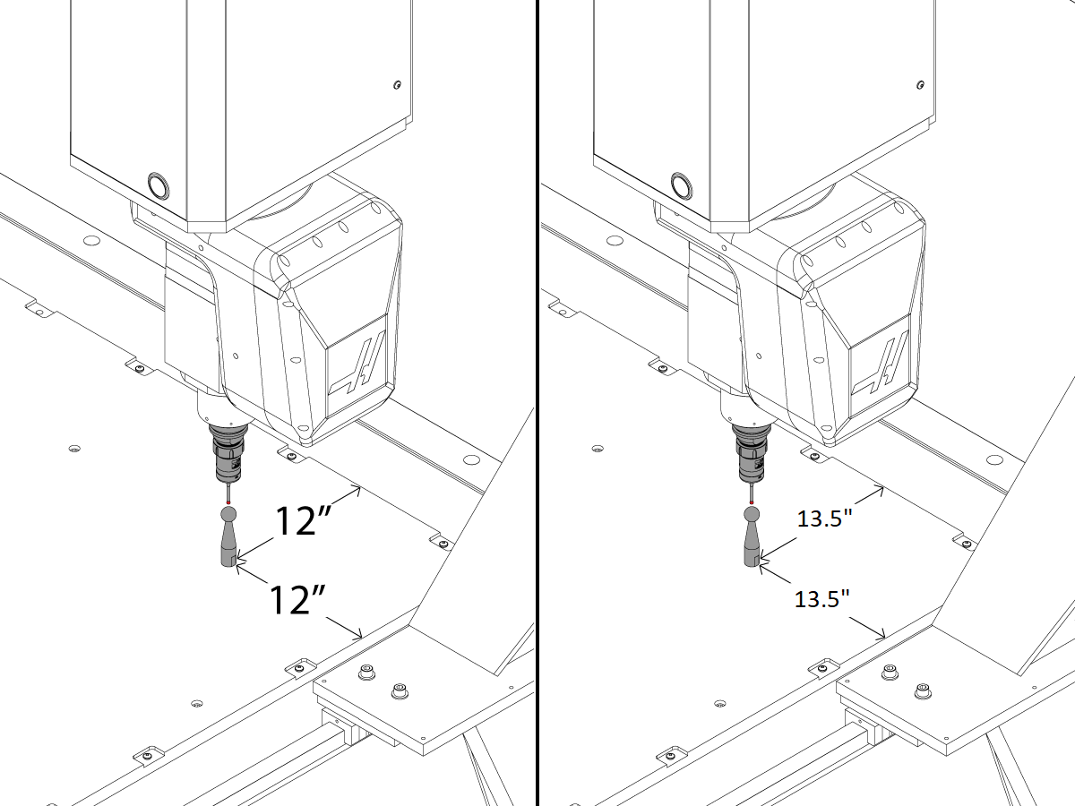

Mount the calibration sphere into the threaded hole in the table located 12’’ for the X+ side of the table and 12’’ from Y- side of the table [1].
Machine built after 08/2021 the threaded hole is now located 13.5’’ for the X+ side of the table and 13.5’’ from Y- side of the table [2] using the tall (4’’) post. The top of the calibration sphere should be 8.35’’ above the table.

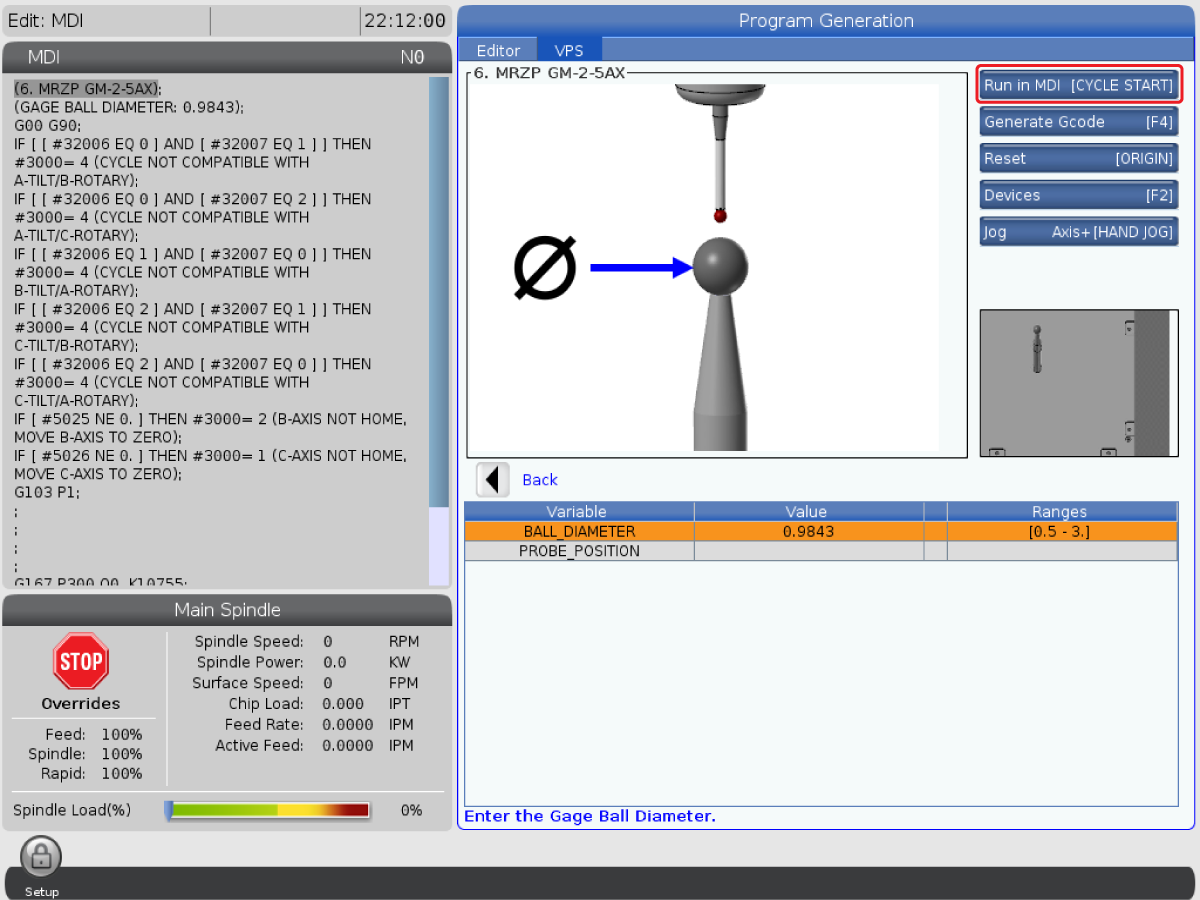

or
Press [CYCLE START] to run the MRZP program in MDI immediately .

The MRZP program will populate the values that are found into the settings page using the code shown in the picture.
G167 provides the ability to write to settings, P code [1] is the setting number the program is writing to, Q code [2] is the value of the Macro Variable the P code setting will be populated with, and the K code [3] essentially means it will keep these values in the setting once the program is over.
Verify settings 300-305 are populated.

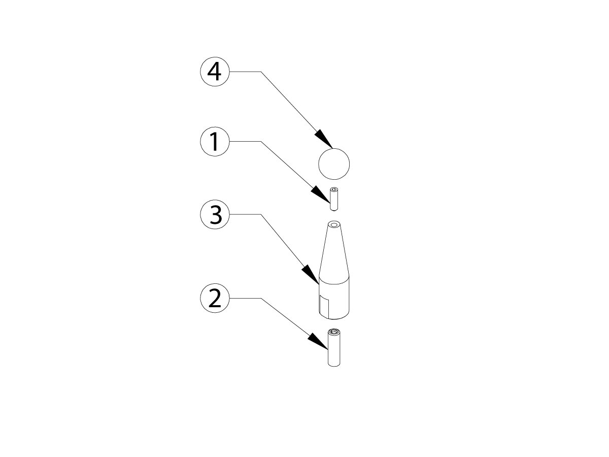

Build the Safe Zone tool in the configuration shown.
[1] SSS M6 X 20 CUP PT
[2] SSS 3/8-16 1 1/4  CUPT PT
[3] PROBE BALL MOUNT SHAFT
[4] PROBE BALL MRZP
Updated
Mount the calibration sphere into the threaded hole in the table located 12’’ for the X+ side of the table and 12’’ from Y- side of the table [1] using the short tapered post. The top of the calibration sphere should be 4.35’’ above the table.
Machine built after 08/2021 the threaded hole is now located 13.5’’ for the X+ side of the table and 13.5’’ from Y- side of the table [2] using the short tapered post. The top of the calibration sphere should be 4.35’’ above the table.

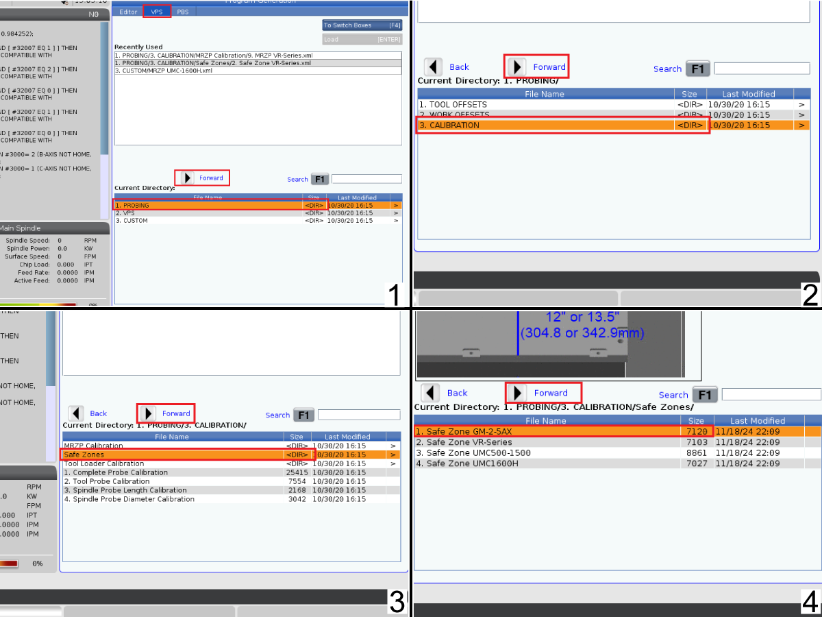

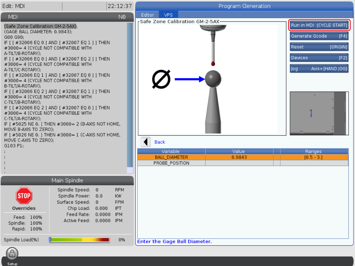

Highlight SAFE ZONES and press [RIGHT ARROW].
Highlight SAFE ZONE GM-2-5AX and press [RIGHT ARROW].
NOTE: With the B and C axes at 0, the probe should be 0.25" above the sphere.
or
Press [CYCLE START] to run the Safe Zone program in MDI immediately.
