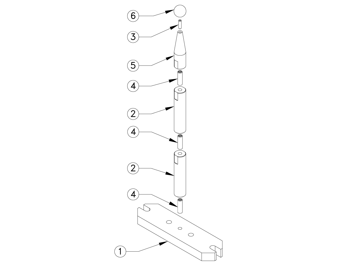

Build the MRZP/Safe Zone tool in the configuration shown.
[1] MRZP PROBE MOUNT BASE PLATE LRG
[2] MRZP BASE BALL MOUNT SHAFT
[3] SSS M6 X 20 CUP PT
[4] SSS 3/8-16 1 1/4  CUPT PT
[5] PROBE BALL MOUNT SHAFT
[6] PROBE BALL MRZP

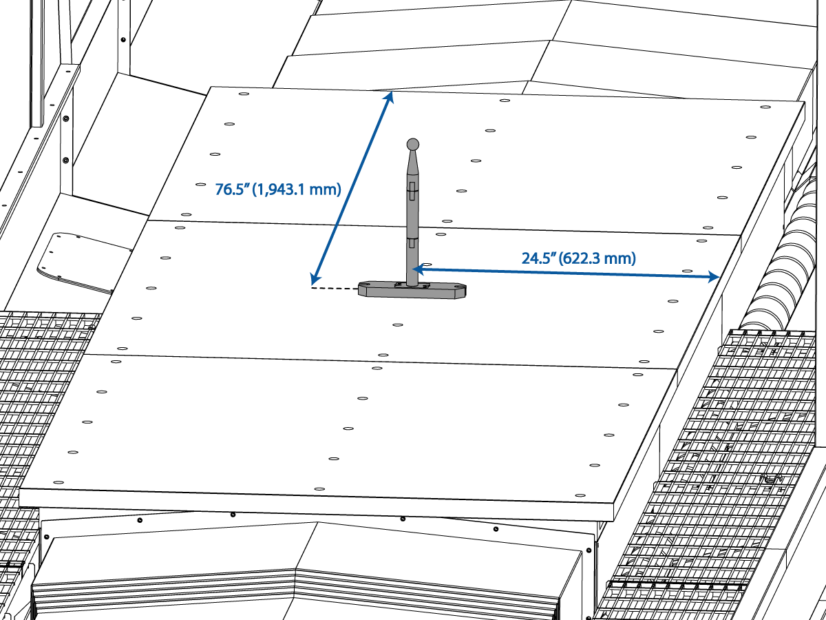

Place the straight sphere assembly in the center of the middle table parallel to the Y-Axis and 24.5" from the right edge of the table and 76.5" from the back of the table.
 Note: The table has threaded holes in the center use to secure the MRZP/Safe Zone tool.
