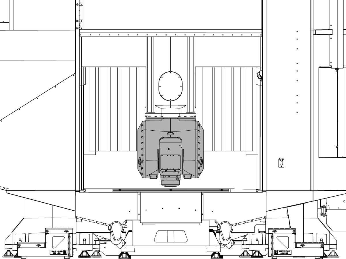

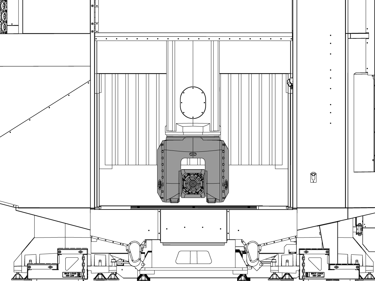

Safe Zones
Max travels for the Z-axis are determined by the B position.
The image shows the Z-max travel at B=0, the machine will be able to move to this position before registering a safe zone limit has been reached.

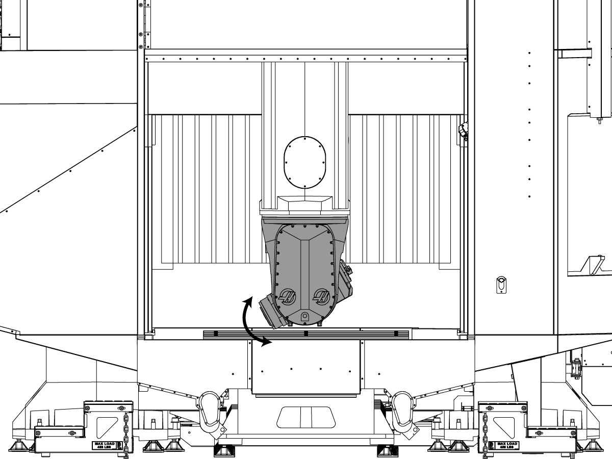

If B is rotated to its 90 degree position the Z-axis max travel  will change so that the B-axis casting does not crash into the table.
The image showns the position where this max travel limit is located.
NOTE: All other movement is taken into consideration for safe zones, if the user tries to rotate the B-axis while in its max travel limit they will receive a restricted zone reached message.
Possible Crash Zones
The HDC head can crash into the table at any non-zero position if the B-axis is commanded to move.
A zero return sequence can cause the head to crash as it will rotate the B-axis first and ignore safe zones.

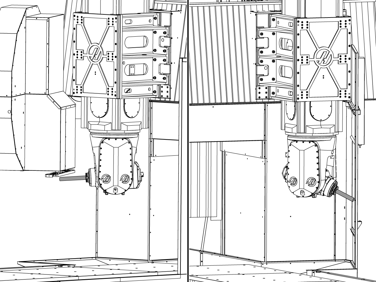

Recover a Tool After Power Loss
The Vector Jog feature allows the operator to jog the machine along the vector of the current spindle orientation. Vector jogging can be used at any time. It is especially useful for recovering a tool if the machine loses power while machining a part.
To recover a tool after power loss during machining press [POWER UP]. The Zero Return popup will appear.
Type [V] [J] and press [HANDLE JOG] . Jogging in the positive direction will move the tool away from the part along the current spindle vector. Jogging in the negative direction will move the tool towards the part along the current spindle vector.
The Tap Recovery feature will automatically make use of vector jogging to recover taps form non vertical holes.
Note: GM Machine shown in image for illustrative purposes.

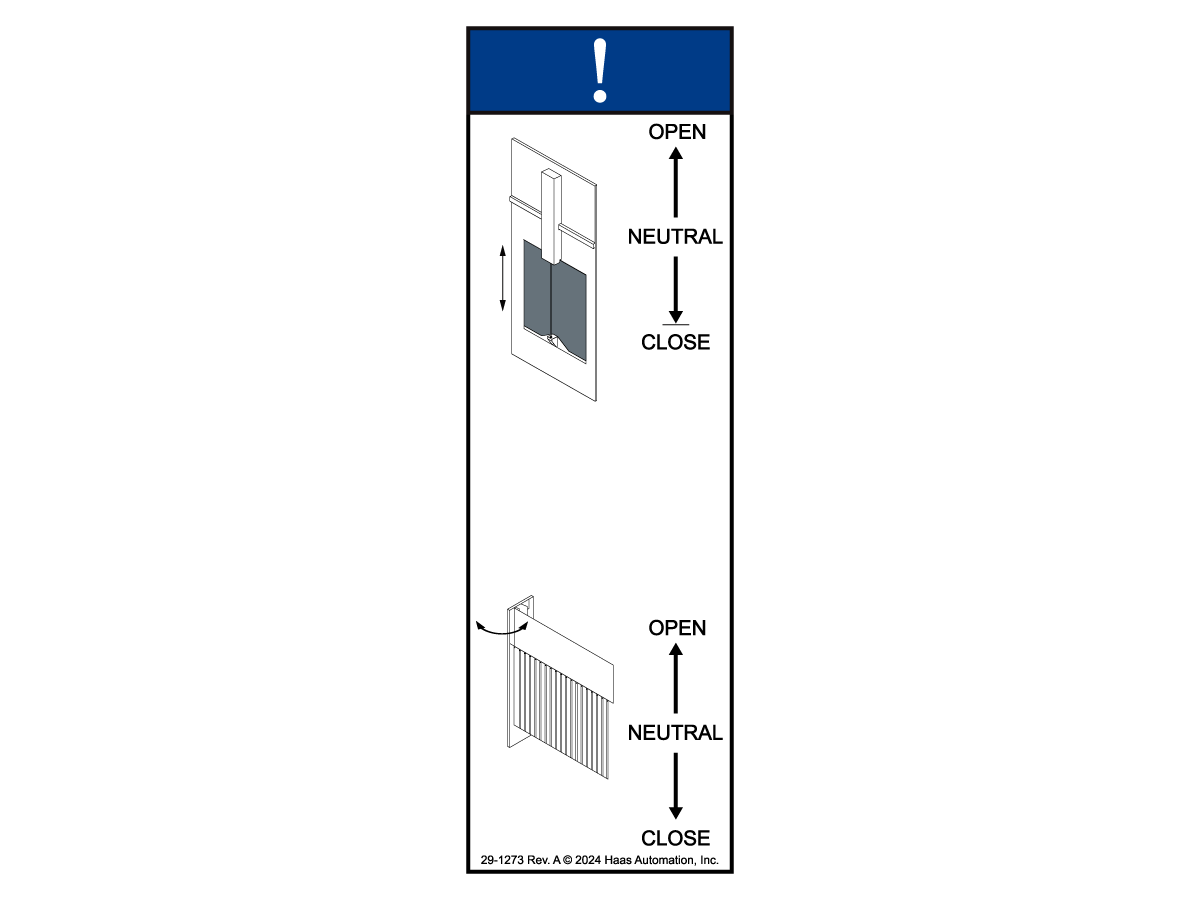

6.6 HDC-3-5AX - Auto Window/Chip Curtain
Under Construction
Follow the instructions on the decal to operate the Auto Window and Chip Curtain.
 Note: Leave the Chip Curtain switch in the open or closed position. Leaving the switch in the neutral position will cause the Curtain to slam.
