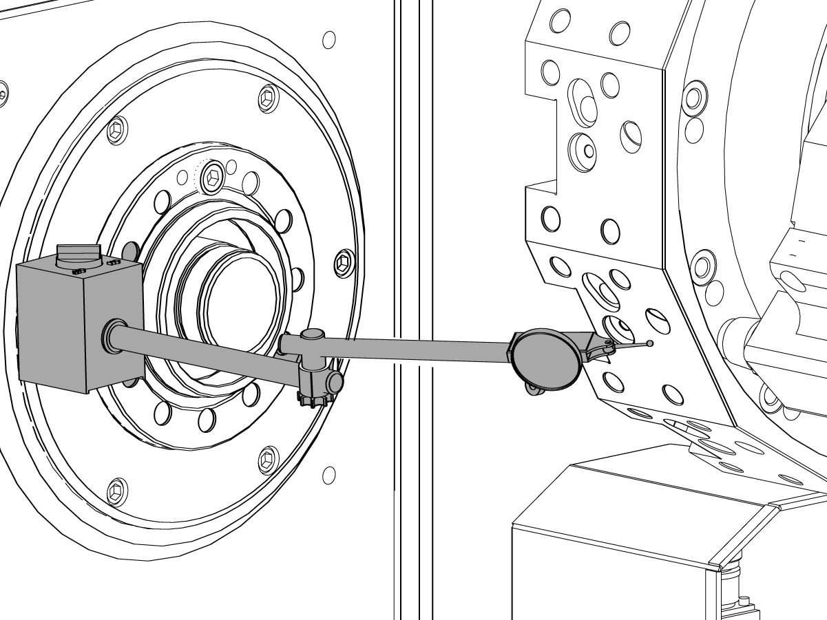

Attach a dial indicator to the spindle
Handle jog the turret into position so that the turret just starts to deflect the indicator
Using 0.001" Jog increments, jog the turret an additional 0.015"
Zero the indicator
Jog the X Axis 0.010" (0.25 mm) in the positive (+) direction.
Jog the X Axis 0.010" (0.25 mm) in the negative (-) direction.
Record the difference between these two values:
  • the indicator value
  • the X-Axis position on the control
The backlash should not exceed 0.0002" (0.005 mm)
Perform a manual check for backlash, by placing the machine in Emergency stop and pushing up on the turret.
Allow the turret to return to its position and note the lost motion.

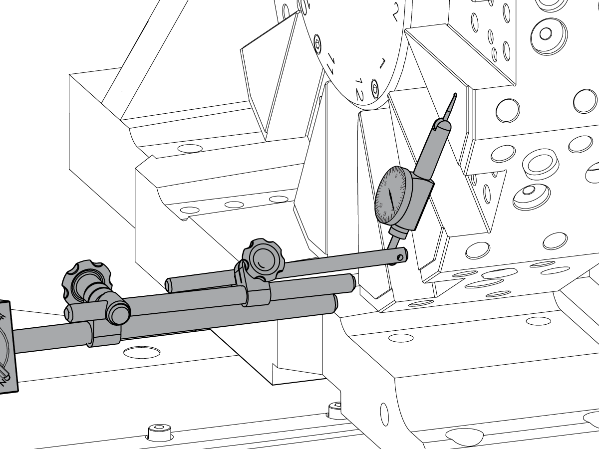

Lathe-Z-Axis Ballscrew-Backlash Test
Zero the indicator
Jog the Z Axis 0.010" (0.25 mm) in the positive (+) direction.
Jog the Z Axis 0.010" (0.25 mm) in the negative (-) direction.
  • the Z-Axis position on the control
The Backlash should not exceed 0.0002" (0.005 mm)
With the servos engaged.  Perform a manual check for backlash, pushing fore and aft on the turret.
