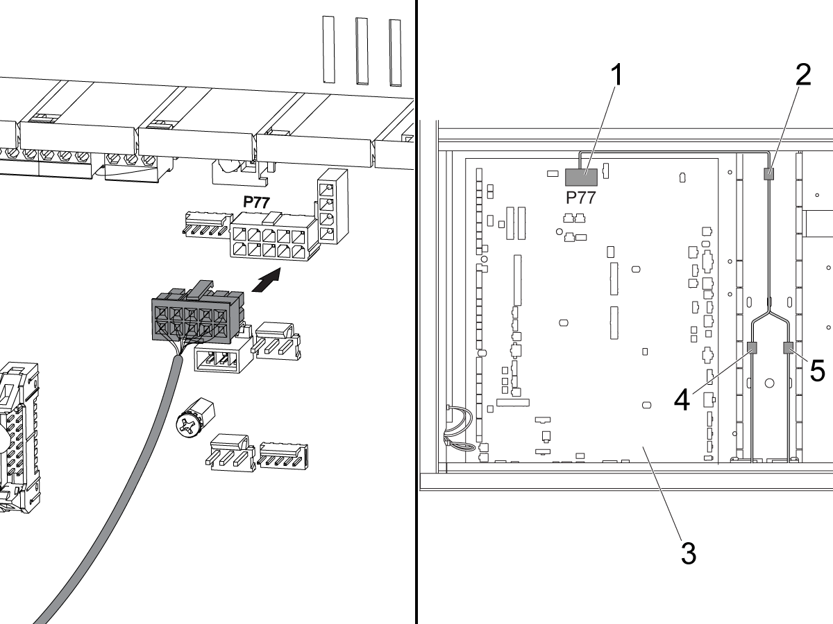

For lathes made before February 2013, disconnect the Lathe Tool Probe (LTP) cable [2] from connector P22 [3] on the I/O PCB.
For lathes made after February 2013, disconnect the LTP cable [2] from P77 [4] on the I/O PCB.
For I/O PCBs with version AC or after:
  • Connect the control cable 33-0619A to P77 on the I/O PCB.
For I/O PCBs with version AB or before:
  • Connect a cable adapter 33-0333[1] to P77 on the I/O PCB [3].
  • Connect the control cable 33-0619A[2] to the other end of the cable adapter [1].
  • Put the cable adapter [1] and control cable [2] through the cable channel.
For all I/O PCB versions:
connect the LTP cable [4] to the 10-pin connector of the control cable [2]. Connect the OMI cable [5] to the 6-pin connector of the control cable [2].
