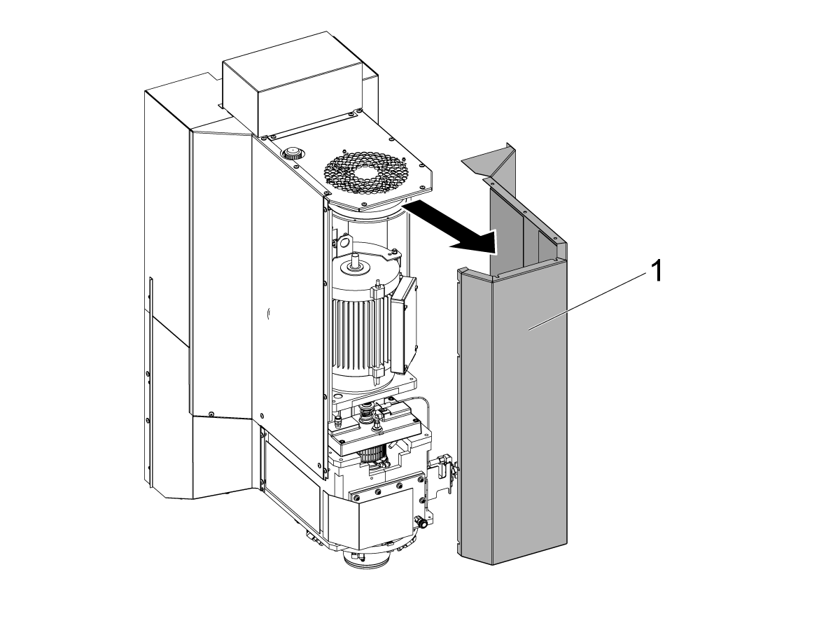

Lower the spindle head so that the head cover [1] can be easily accessed.
Unfasten and remove the spindle head cover [1].

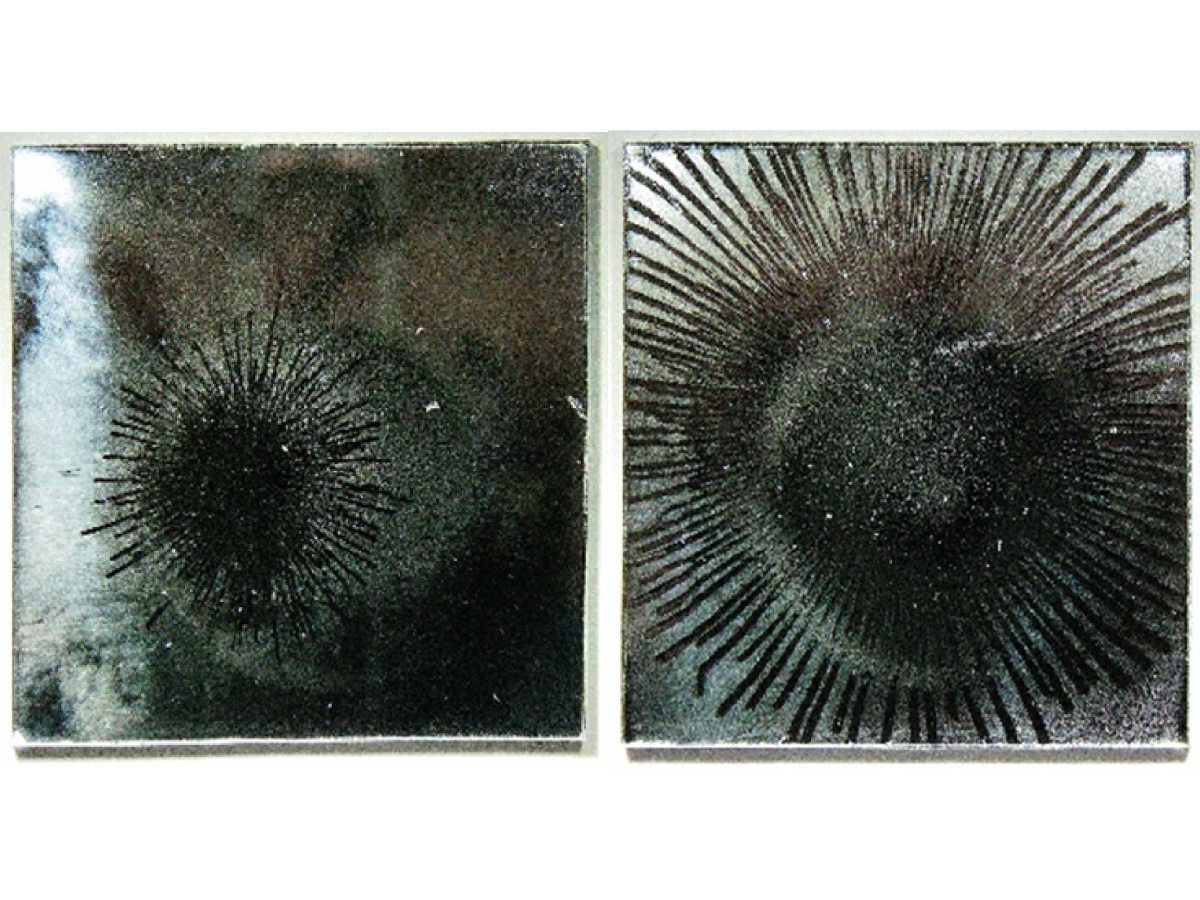

Once each test is complete, label the mirror with the time interval or trial number. Take a photo of each sample.
Oil on the mirror will indicate a positive result. A longer test duration will result in a larger oil splatter, if it does not re-evaluate to verify. If the issue persists reference the folowing Spindle Minimum Lubrication System - Troubleshooting Guide.
Examples of a positive result are shown. This means that the spindle is receiving oil when the lubrication cycle is engaged.
