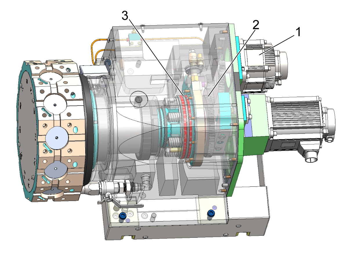

  1. Servo Motor
  2. Internal Gears
  3. Quad-Ring

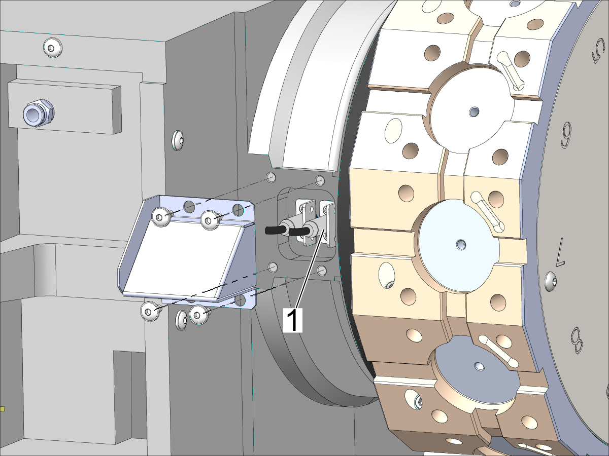

  1. Turret Home Switch
  2. Turret Clamp/Unclamp Switch

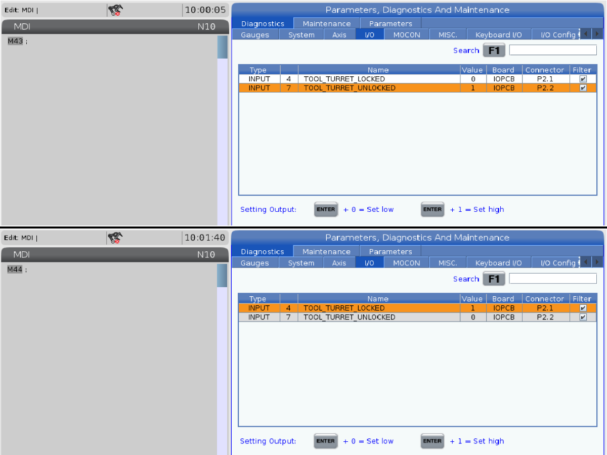

Clamp/Unclamp Proximity Sensor
Navigate to the Diagnostic screen on the pendant. Go to the I/O tab. Use an M43 (Unclamp) M44 (Clamp) code in MDI mode to troubleshoot the clamp/unclamp switch.
Check that Input 4 Tool Turret Locked and Input 7 Tool Turret Unlocked change states when the turret is commanded to unclamp/clamp.
Test the sensor by placing a screwdriver in front of the sensor. Make sure the inputs change states.
If the input does not change, jump the cable connector on the turret connector bracket. If the input changes, replace the sensor.

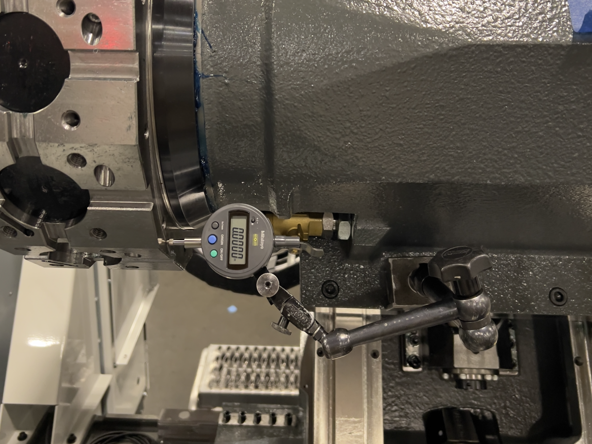

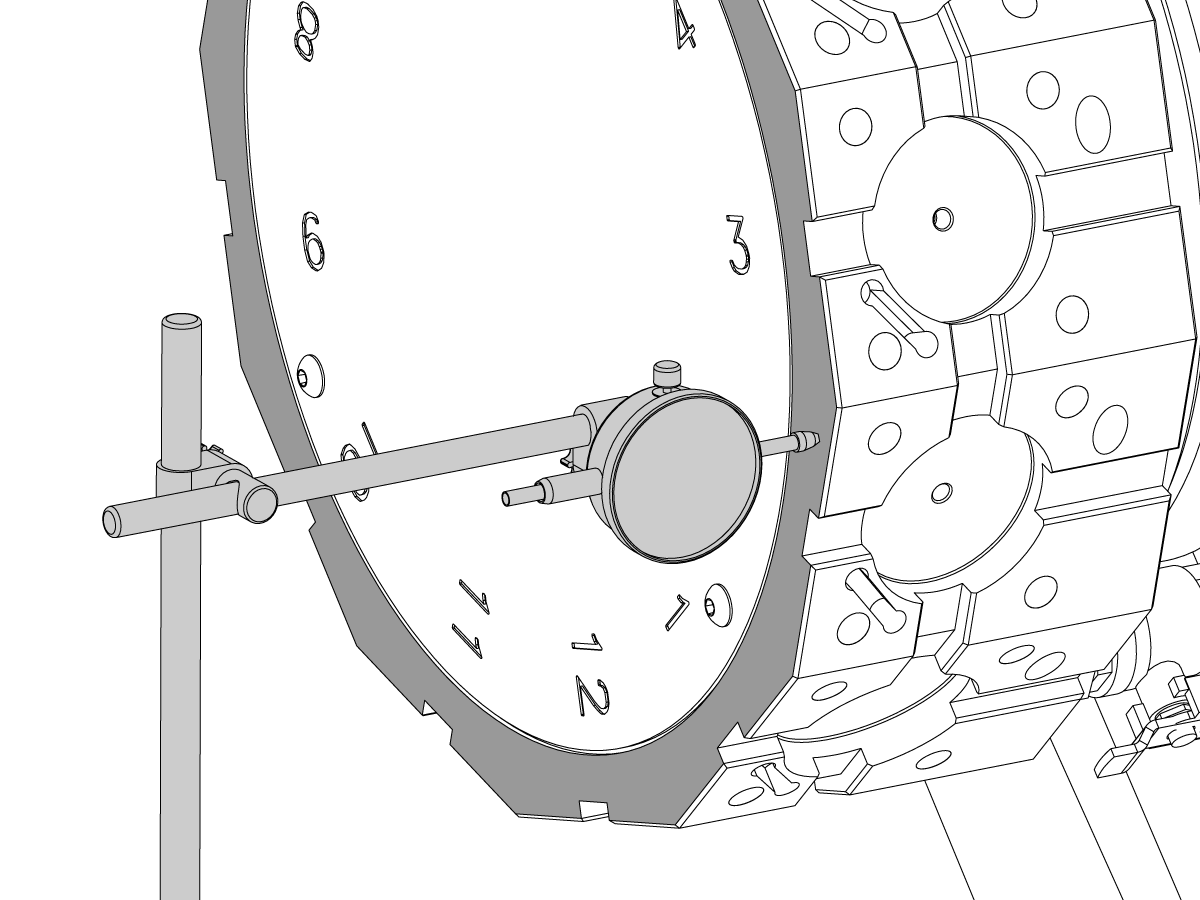

If you commanded an M43 (Unclamp) and the turret moved, but did not move far enough to clear the coupler, measure the distance the turret traveled.
Set indicator to zero when turret unclamped M43. Command the turret to clamp M44. The indicator should measure 0.160" - 0.200".
If the turret does not travel far enough, the piston shaft, gears, or spring assembly could be at fault, these components must be inspected by your local HFO.

Internal Gears
The turret's pop out and rotate function can fail because the tool changer gears are damaged. A machine crash can cause damage to the piston and gears, and must be inspected by your local HFO.

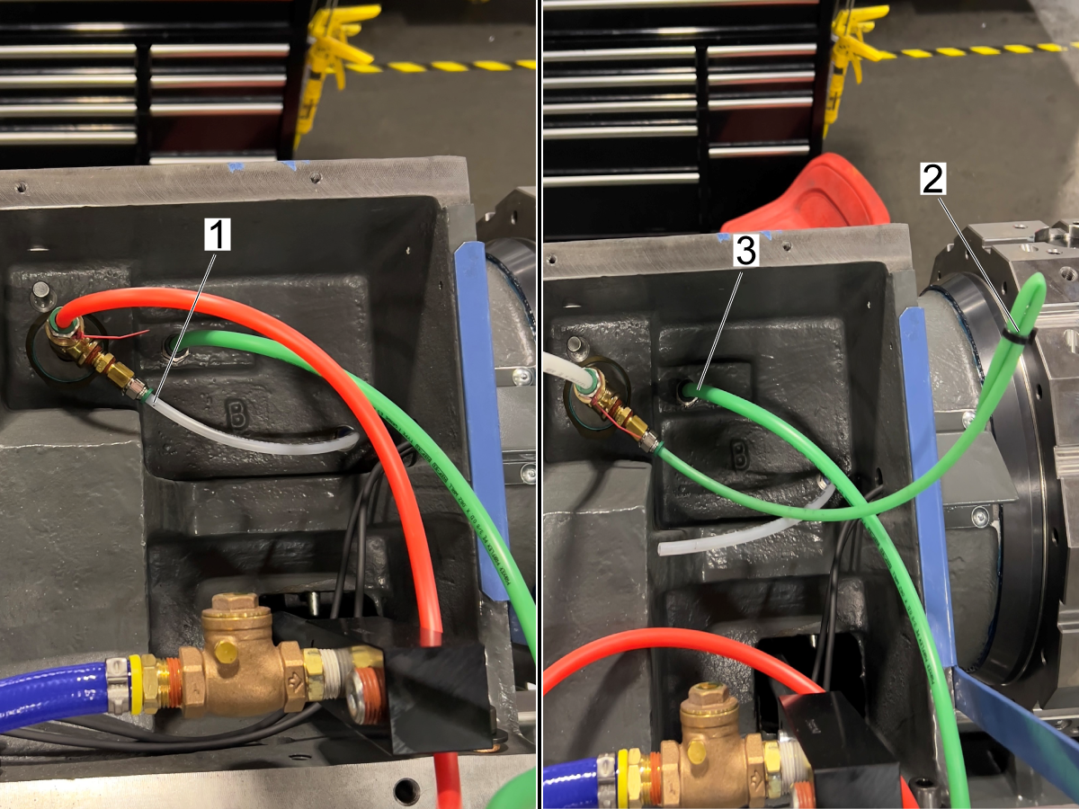

Spring Force

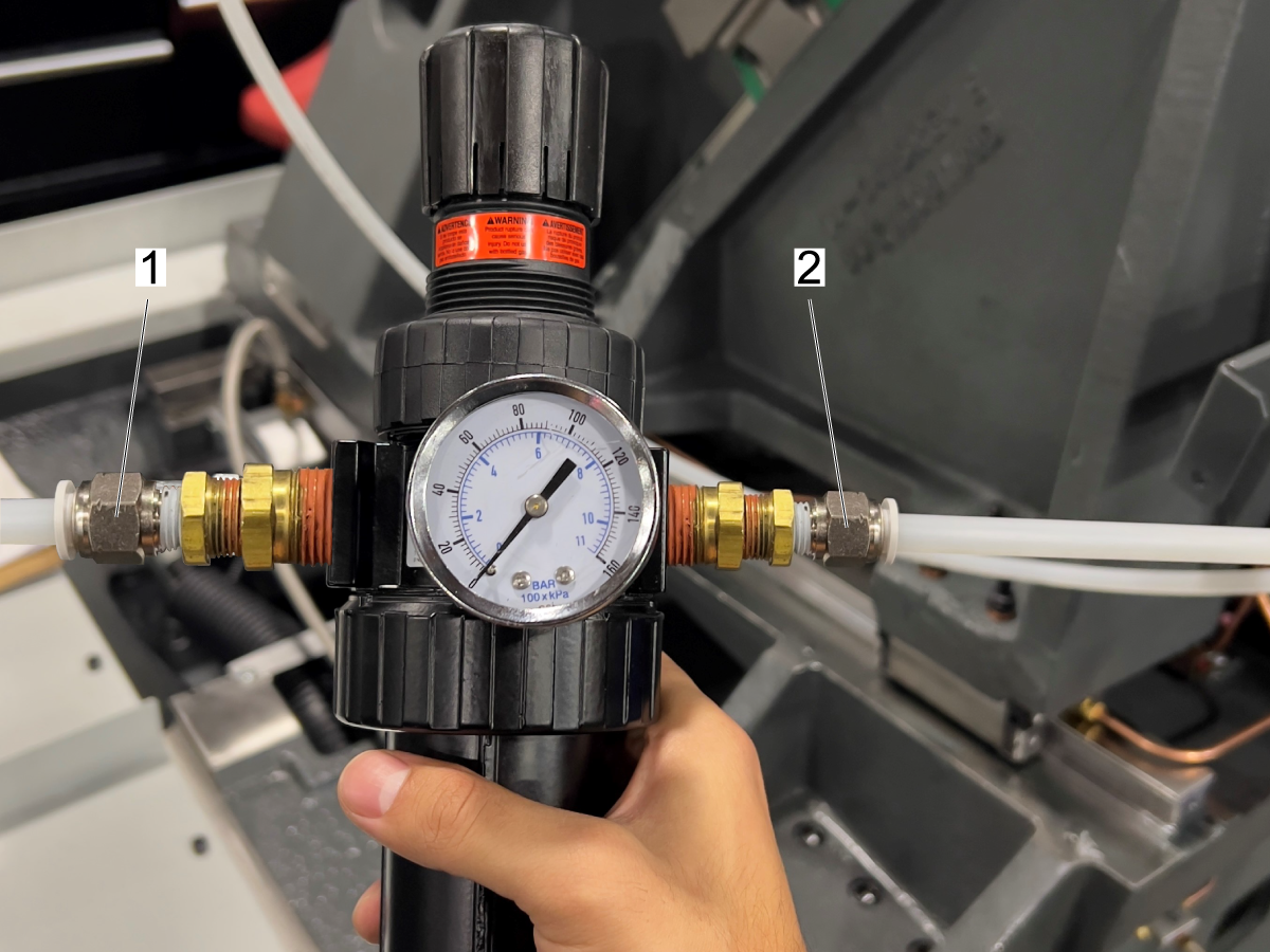

To check the clamping force due to the internal compression springs, measure the air pressure required to overcome the springs and pop the turret out. Before supplying air to the unclamp port, remove the purge air line [1] and replace it with a piece of hose clamped closed [2] to avoid misreading the air pressure.
Note: Make sure to unplug the clamp hose [3] to remove any built up pressure in the system that would add to the clamping force.
Plug the airline to the incoming port [1] of the pressure regulator and the outgoing port [2]. Connect the airline from the outgoing port [2] into the unclamping port of the indexer.
Note: The unclamping port can be seen with the red hose attached in the image above.
Set up an indicator onto the turret to measure pop out. Slowly increase the air pressure on the regulator until you see a pop out of .001” from the indicator. Record this value of the air pressure (PSI) required to overcome the clamping force of the springs.
Use this value to calculate the spring clamp force by multiplying it with the surface area of the unclamping face of the piston (21.4in2 ).
  • Spring Force = Applied Air (psi) * 21.4 in^2
The spring force should fall between 509 - 730 lbs.
If it does not, follow the BMT65/75 - Turret - Piston - Replacement procedure to replace any damaged springs.

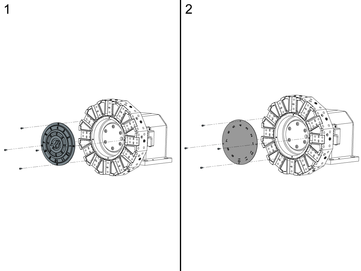

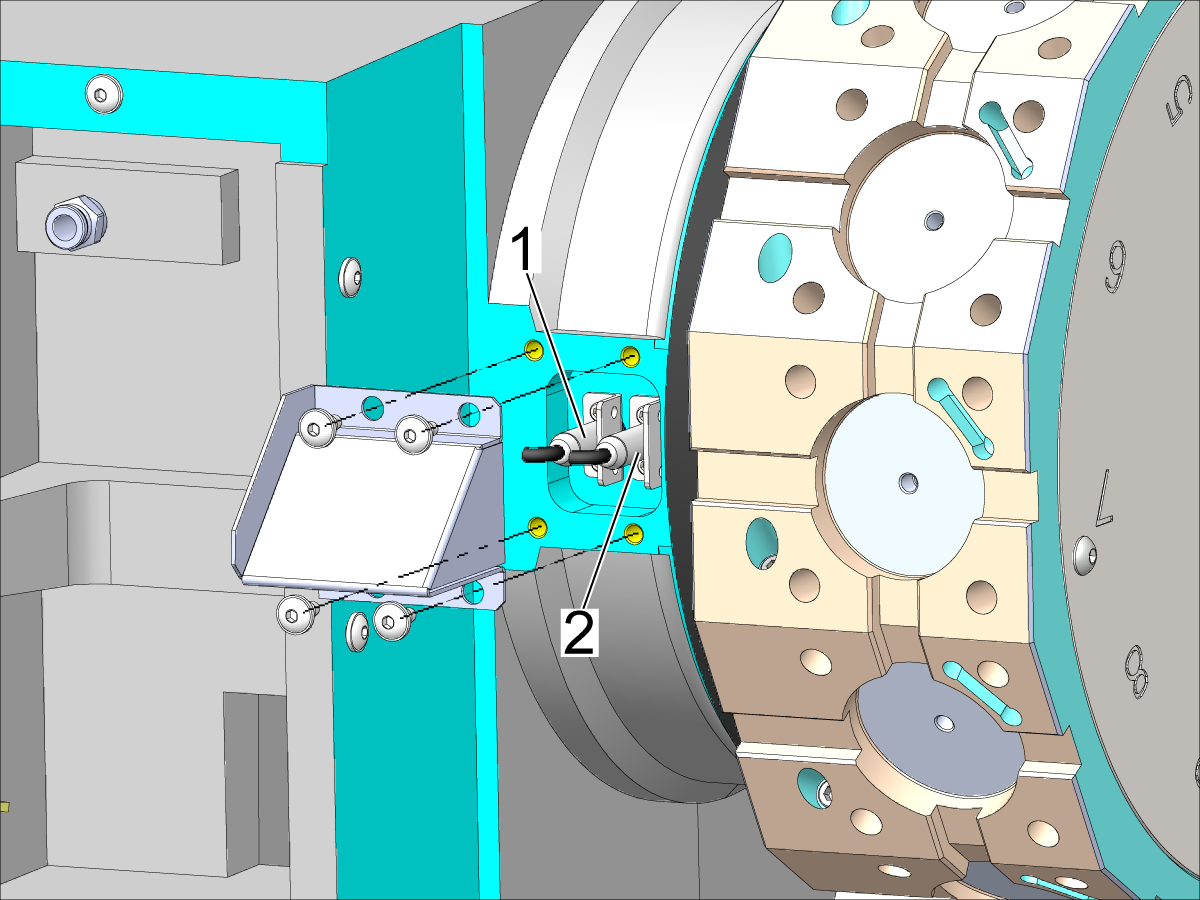

ST-40/45 BOT Front Cover
Order 93-4975 TURRET FRONT COVER FLAT ST-40/45/55.
Move turret so that it is easily accessible through the door.
E-stop the machine.
Remove the BOT Cast Cover by removing the (4) screws [1].
Install the Flat BOT Cover using the (4) screws provided in the kit [2].
