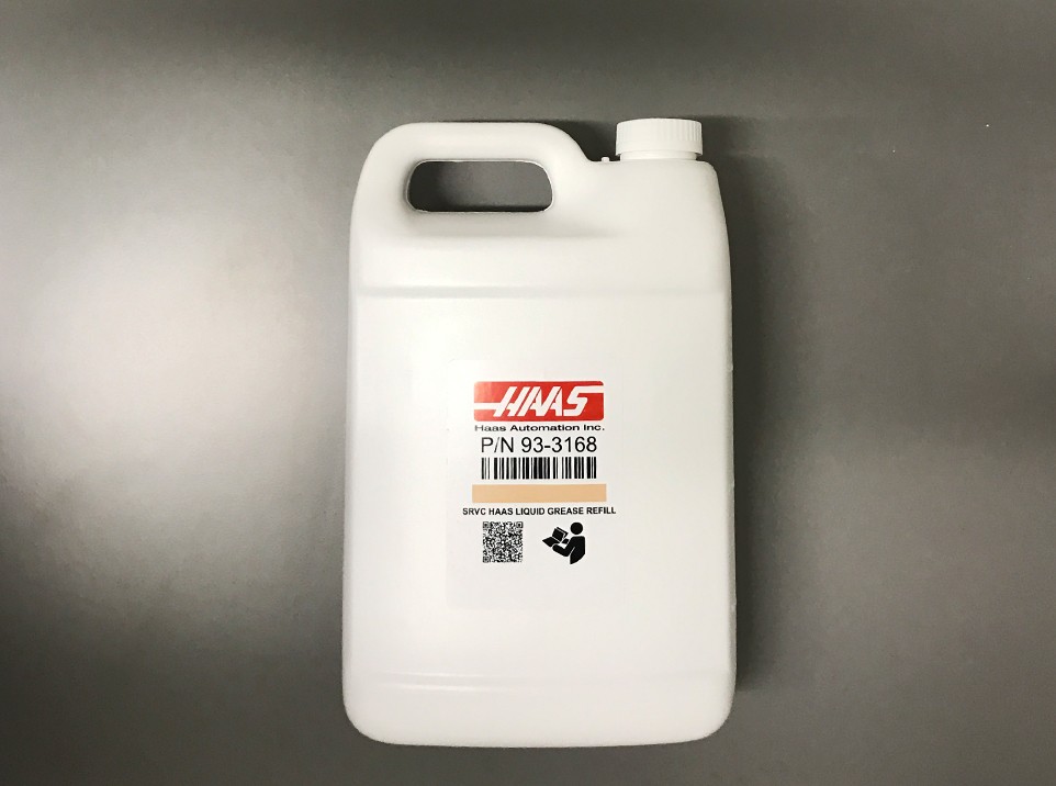

HAAS LIQUID GREASE REFILL KIT 1 GALLON (TAN COLOR) REPLACES 93-2196A
Part #: 93-3168
HAAS LIQUID GREASE (HLG) REFILL 1 GAL
ATTENTION! Haas Liquid Grease (HLG) cartridges and refills are no longer available.
To increase system performance and reliability, Haas has converted the machine axis lubrication system from grease to oil. Machines using HLG should be converted to Haas Axis Lubrication Oil, at the earliest convenience. See details above.
