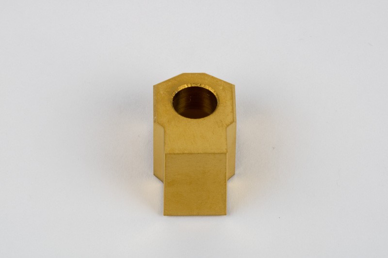

HIN, 10mm Keyway Broaching Insert, D10 Clearance Fit, Size 10, TiN Coated - Pack of 2
Part #: 02-0818
HIN-10 D10
Price: 101.95 ( / unit)
Price: 1748.95 ( / unit)
Price: 520.95 ( / unit)
Price: 69.95 ( / unit)
Price: 314.95 ( / unit)
Price: 734.95 ( / unit)
71.97
1499.97
446.97
59.97
269.97
629.97
  • Technical Details
  • Speeds and Feeds
Insert Style Keyway
Insert Size 10
Broach Width 10.0 mm
Fit Tolerance D10 - Clearance Fit
Primary Workpiece Material N - Aluminum, K - Cast Iron, P - Steel
Secondary Workpiece Material H - Hardened Materials, S - High Temp Alloys, M - Stainless Steel
Chamfer No
[CW] Cutting Width 10.098 mm
[INSL] Insert Length 18.5 mm
[W1] Insert Width 13.1 mm
[h] Insert Height 14.0 mm
[Ap] Max. Cutting Depth 6.0 mm
[S] Insert Thickness 10.0 mm
Country of Origin Italy
