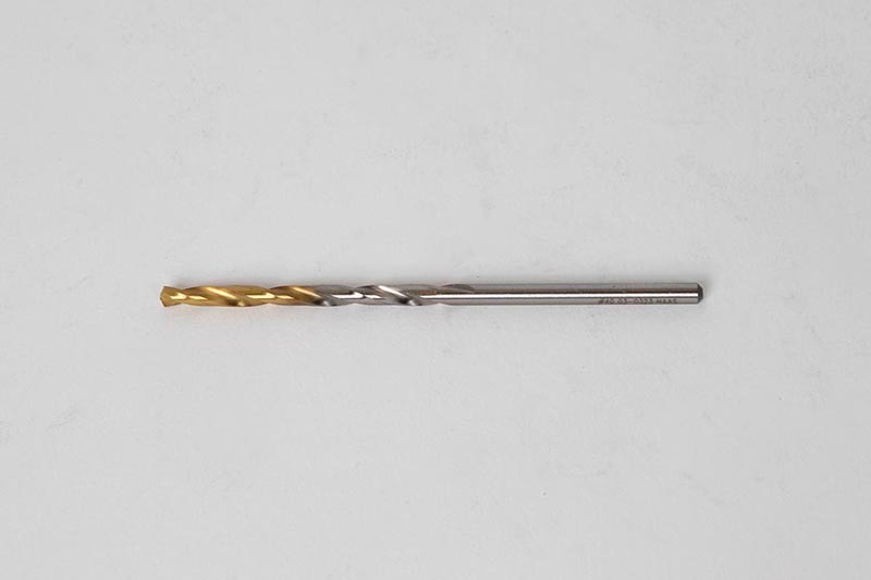

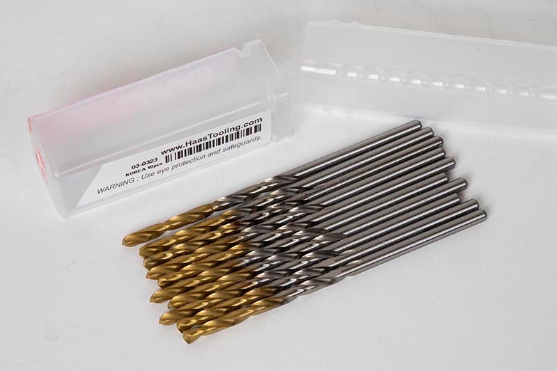

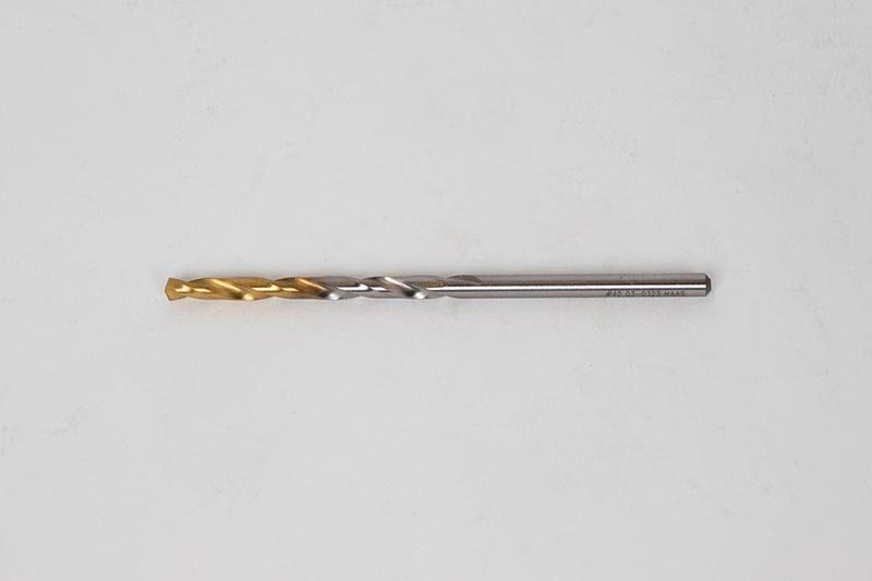

#44 Ø Cobalt Jobber Drill, 135° Point Angle x 30° Helix, 2 Flute, TiN Coated - Pack of 10
Part #: 03-0327
#44 M42 JBR DRL + TIN PVD
Price: 11.95 ( / unit)
8.97
Technical Documents
ISO Material Chart
Drill Type Number
Primary Workpiece Material M - Stainless Steel, P - Steel
Secondary Workpiece Material N - Aluminum, K - Cast Iron, S - High Temp Alloys
Material HSSCo8 (M42)
Coating TiN
[D1] Drill Diameter 0.086 in \ #44
[ØDMM] Shank Diameter 0.086 in
[LU] Usable Length 1.057 in
[LCF] Flute Length 1.125 in
[PL] Point Length 0.018 in
[OAL] Overall Length 2.125 in
[NOF] Number of Flutes 2
[SIG°] Point Angle 135
[FHA°] Helix Angle 30
Drill Length Type Jobber
Hole Tolerance h8
Cutting Direction Right
