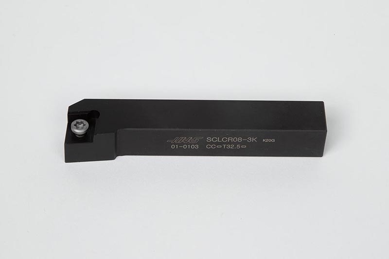

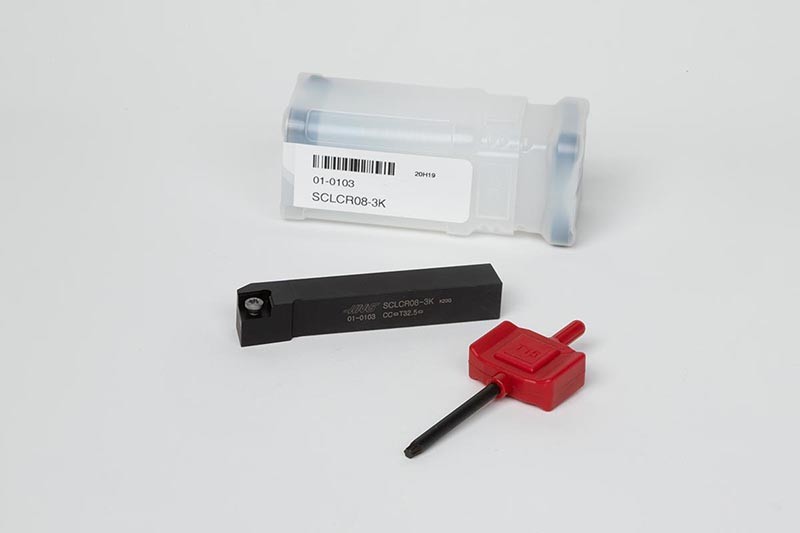

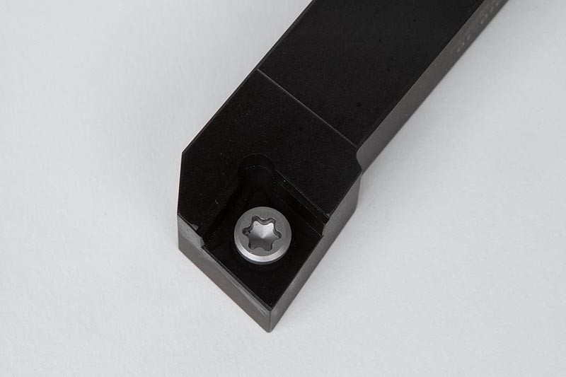

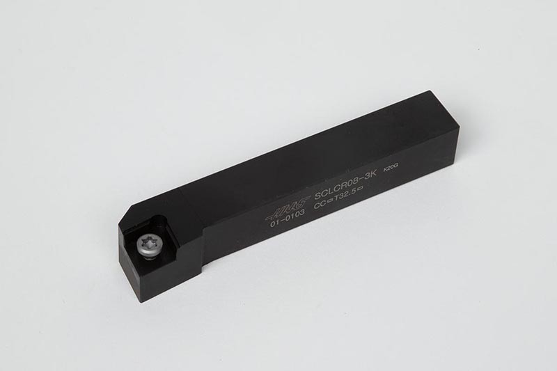

SCLCR08-3K, 1/2" Square Steel Shank External (OD) Turning Tool, Right-Hand, Screw-Lock
Part #: 01-0103
SCLCR08-3K
Price: 66.95 ( / unit)
40.97
Technical Documents
Clamping Type S - Screw-On
Tool Orientation External
Hand of Tool Right
[LH] Head Length 0.63 in
[OAL] Overall Length 3.125 in
[H1] Cutting Height 0.5 in
[H] Shank Height 0.5 in
[B] Shank Width 0.5 in
[f] Dimension 0.625 in
[°] Lead Angle 95 Degree
[D1] Insert Hole Size 0.173 in \ 4.4 mm
Machine Side Adapter Type Square Shank
Through Tool Coolant No
Weight 0.2 lbs \ 0.1 kg
