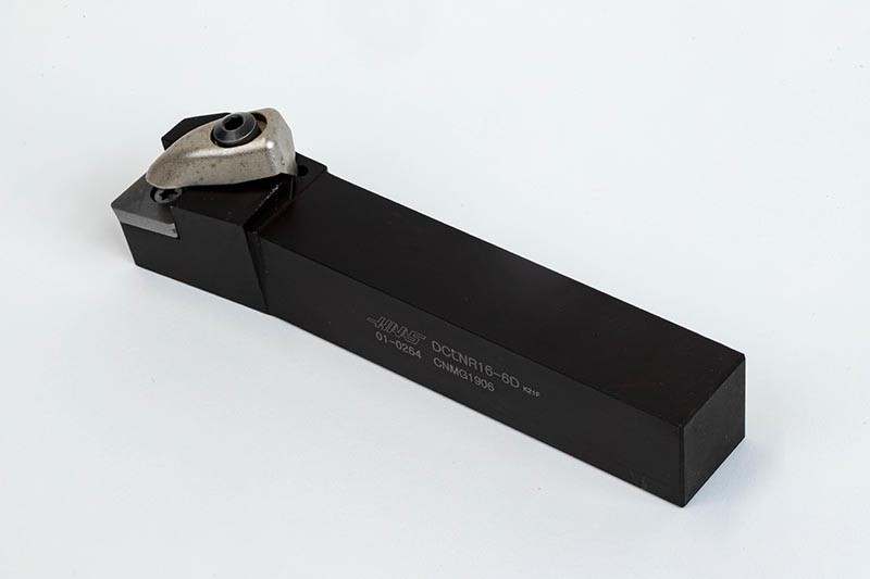

DCLNR16-6D, 1" Square Steel Shank External (OD) Turning Tool, Right-Hand, Double Clamp-Lock
Part #: 01-0264
DCLNR16-6D
Price: 76.95 ( / unit)
61.97
Clamping Type D - Double-Clamp
Tool Orientation External
Hand of Tool Right
[LH] Head Length 1.55 in
[OAL] Overall Length 6.0 in
[H1] Cutting Height 1.0 in
[H] Shank Height 1.0 in
[B] Shank Width 1.0 in
[f] Dimension 1.25 in
[°] Lead Angle 95 Degree
[IC] Inscribed Circle Diameter 0.75 in \ 19.05 mm
[D1] Insert Hole Size 0.312 in \ 7.93 mm
Machine Side Adapter Type Square Shank
Through Tool Coolant No
Weight 1.7 lbs \ 0.8 kg
