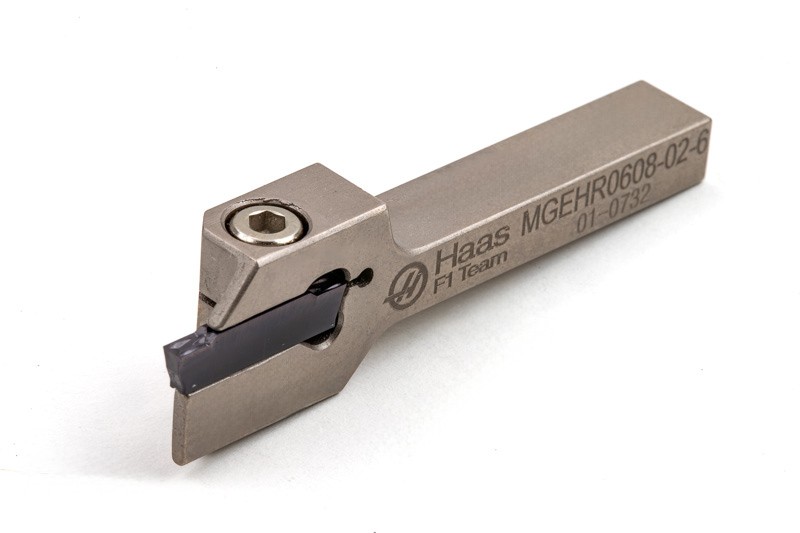

HGMN06-02, 6x8mm Rectangle Steel Shank External (OD) Grooving Tool, Right-Hand, Insert Size 2
Part #: 01-0732
