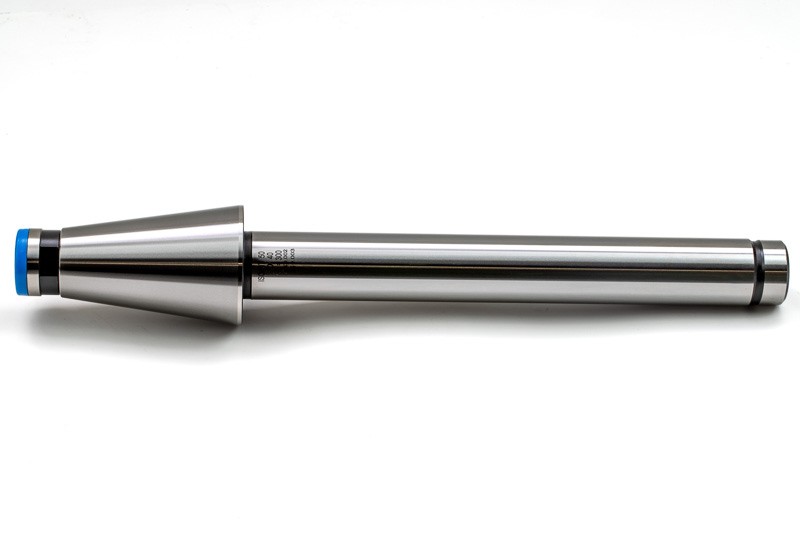

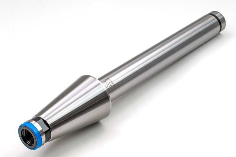

50-Taper Spindle Test Bar, M24x3.0 Thread
Part #: 04-0173
50T TEST BAR
Price: 404.95 ( / unit)

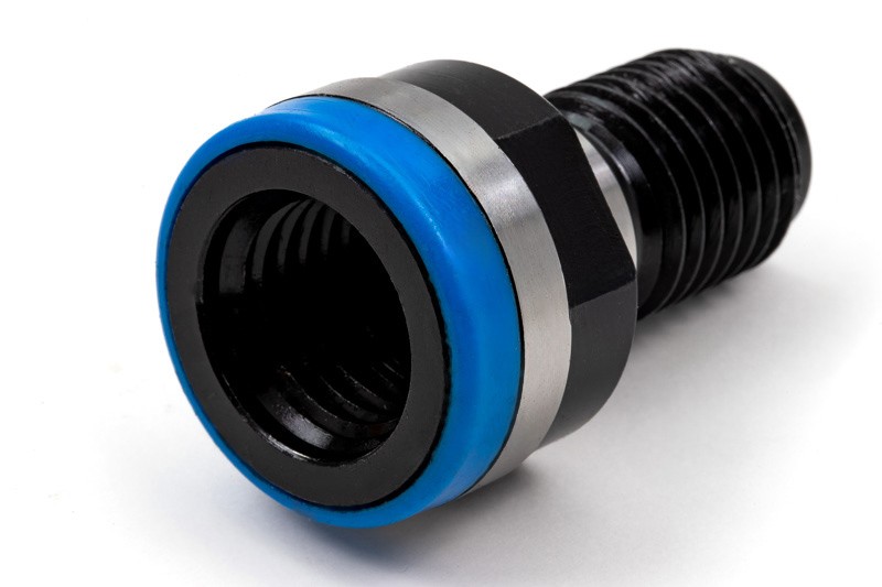

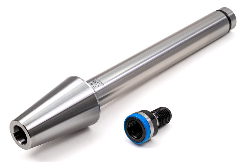

Please Note: These spindle test bars include an adapter for DIN2080 taper machines. The adapter must be removed and replaced with an SK50/DIN pull stud/retention knob before use on a Haas machine.
  • Spindle Taper Maintenance
Spindle Test Bar Details
____________________________
Spindle test bars are a quick and easy way to verify the runout and alignment of your machine’s spindle after a crash, after the machine has been moved, or as a periodic performance check. Excessive runout and axial play in a machine tool spindle are the major causes of excessive tool wear and tool breakage. Use one of our high-precision spindle test bars to verify that your spindle is running accurately, to ensure consistent parts and a stable production environment.
FEATURES AND BENEFITS:
  • Identifies potential problems with spindles and bearings
  • Helps reduce machine downtime and costly repairs

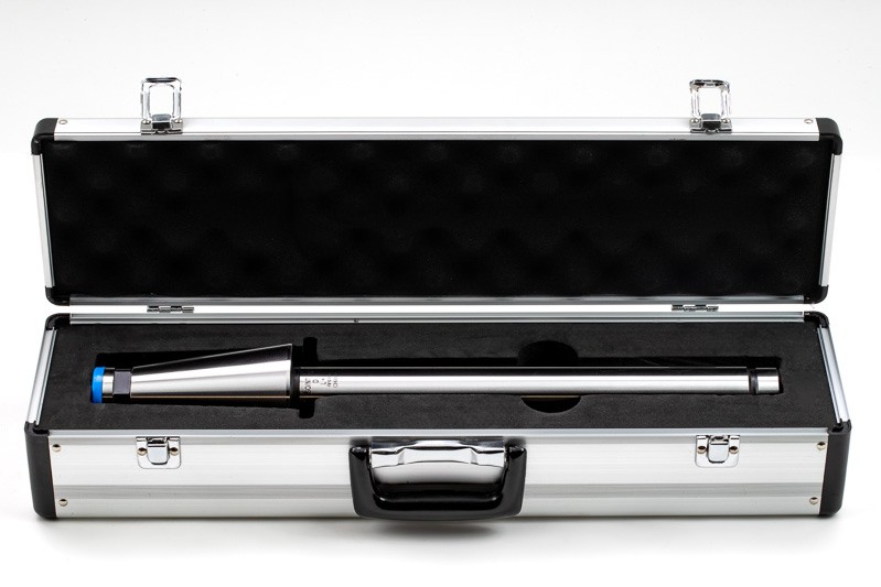

  • Includes a sturdy aluminum case to protect and store test bar
SPECIFICATIONS:
  • Runout accuracy: 0.003 mm
  • Surface roughness: Ra 0.1 μm
  • Outer diameter tolerance: ±0.005 μm
Spindle test bars are for static use only. Do not operate the spindle with the test bar installed.
Taper 50 Taper
[ØD] Arbor Diameter 1.57 in \ 40.0 mm
[L2] Length 11.81 in \ 300.0 mm
Runout 0.0001 in \ 0.003 mm
Retention Knob Thread Size M24X3.0
Weight 14.3 lbs \ 6.5 kg
