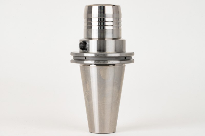

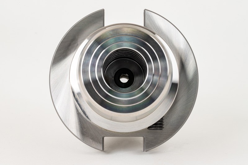

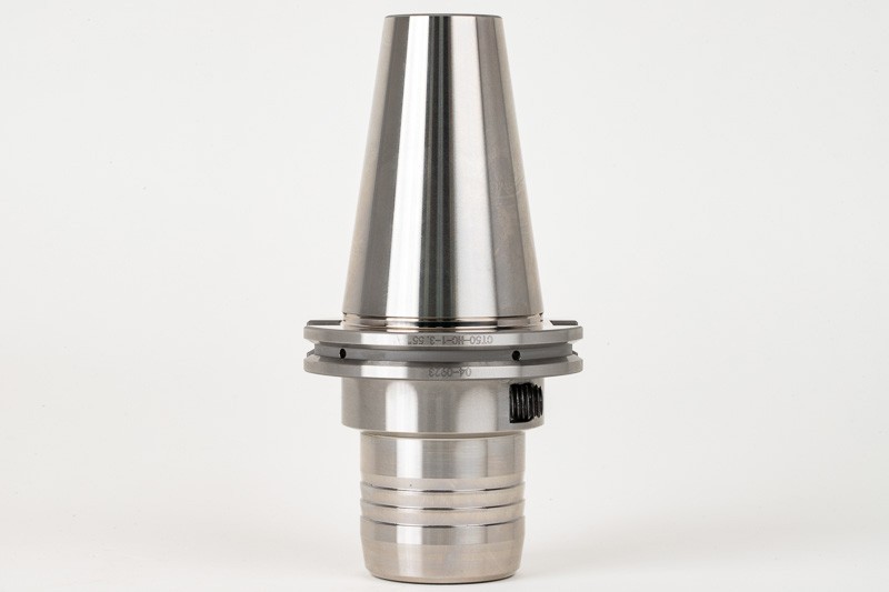

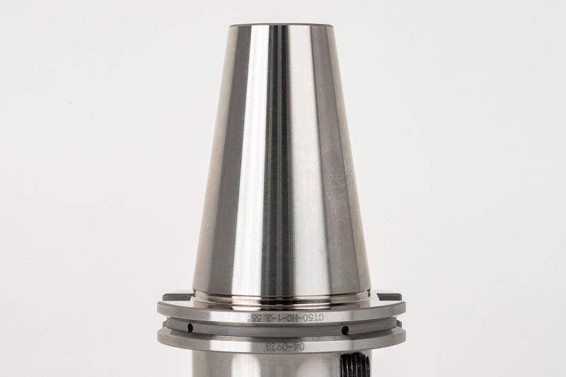

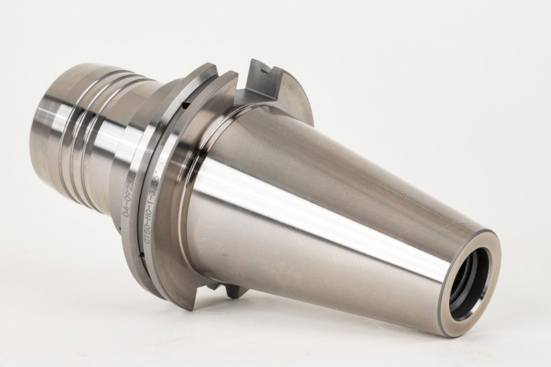

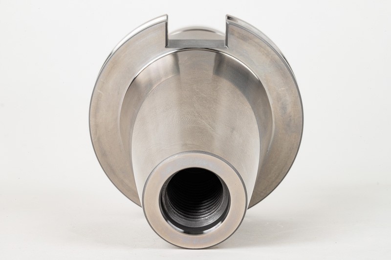

CT50 1" Hydraulic Chuck x 3.54" Gage Length TSC
Part #: 04-0923
CT50-HC-1-3.55"
Price: 398.95 ( / unit)
259.97

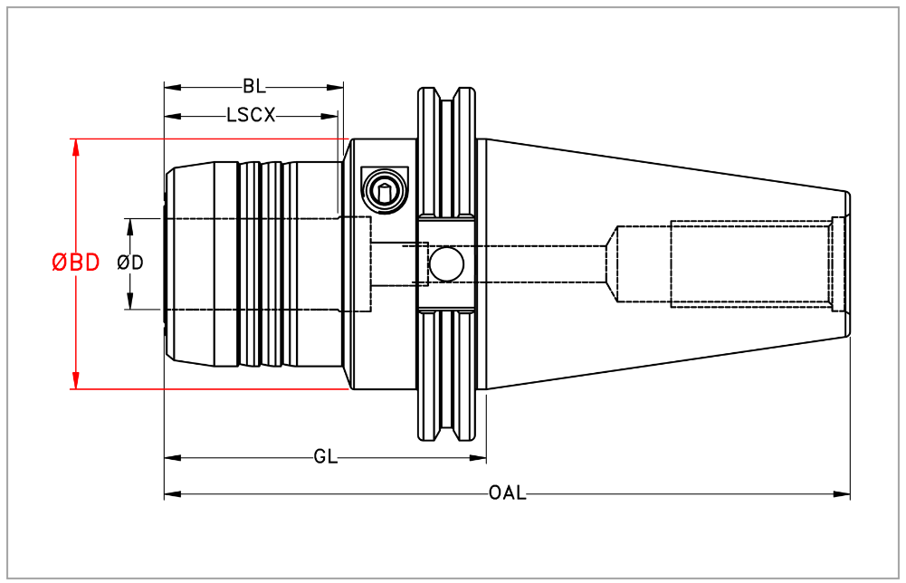

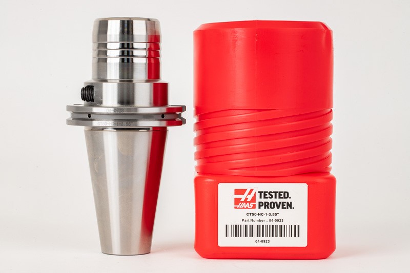

This CAT50 hydraulic milling chuck has a 1.0 in \ 1" bore diameter and a 3.543" gage length. The chuck accepts precision straight-shank collets (optional) to reduce the bore and hold smaller diameter tools. The hydraulic fluid within the chuck compresses to provide equal pressure around the cutting tool shank, providing high grip strength, low runout, and excellent damping properties. It is through-tool coolant (TSC) capable, with a 1"-8 pull stud/retention knob thread.
  • Technical Documents
NOTE: Hydraulic holders that exceed 4" (101mm) [ØBD] Body Diameter need to be defined as a "Large Tool" in the Haas Control depending on your tool changer.
Item Hydraulic Chuck
Taper CT50
[ØD] Bore Diameter 1.0 in \ 1"
[ØBD] Body Diameter 2.75 in
[GL] Gage Length 3.543 in
[BL] Body Length 1.969 in
[LSCX] Maximum Clamping Length 1.909 in
[OAL] Overall Length 7.543 in
Concentricity 0.00012”
Balanced to RPM 25000
Retention Knob Thread Size 1"-8
Through Tool Coolant Yes
Screw TS6
Spindle Drive Slots Yes
Weight 8.7 lbs \ 4.0 kg
