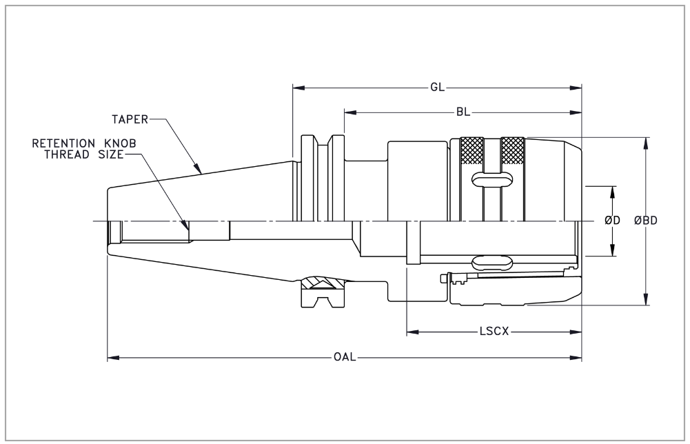

This SK40 \ DIN 69871 milling chuck has a 25mm bore diameter and a 105.5mm gage length. The chuck accepts precision straight-shank collets (optional) to reduce the bore and hold smaller diameter tools. The simple twist-lock operation provides high grip strength, low runout, and good balance. It is through-tool coolant (TSC) capable, with a M16x2.0 pull stud/retention knob thread.
Milling Chuck Instructions
Assembly
  1. Clean the inside of the milling chuck, collet, and tool.
  2. Insert the appropriate size collet and tool into the milling chuck.
  3. Tighten using the spanner wrench until the cap contacts the body of the chuck. Full-face contact must occur between the cap and the chuck body.
CAUTION
  • Never tighten the milling chuck cap without a tool inside of it — permanent damage will occur.
  • Only install smooth shank tooling into the milling chuck. Weldon flats and other side-lock style tooling will not be held with as much force and can cause the bore of the milling chuck to permanently deform.
Tool Removal
  1. Loosen the cap with the spanner wrench until the tool can be removed.
  2. Remove the tool.
  3. Loosen the cap until it’s out and continue to loosen it an additional 1 to 2 turns. This will re-align the bearings and ensure full and accurate clamping the next time the milling chuck is used.
Item Milling Chuck
Taper SK40 \ DIN 69871
[ØD] Bore Diameter 25.0 mm
[ØBD] Body Diameter 62.0 mm
[GL] Gage Length 105.5 mm
[BL] Body Length 86.4 mm
[LSCX] Maximum Clamping Length 80.0 mm
[OAL] Overall Length 173.0 mm
Concentricity 0.01 mm
Balanced to RPM 8000
Retention Knob Thread Size M16X2.0
Through Tool Coolant Yes
Spindle Drive Slots Yes
Weight 5.3 lbs \ 2.4 kg
