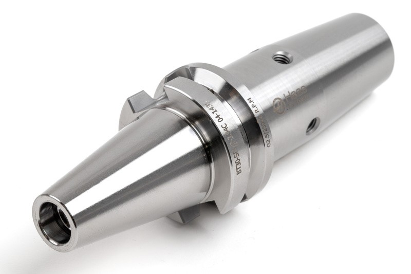

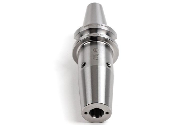

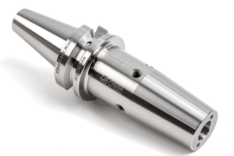

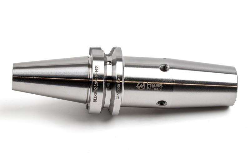

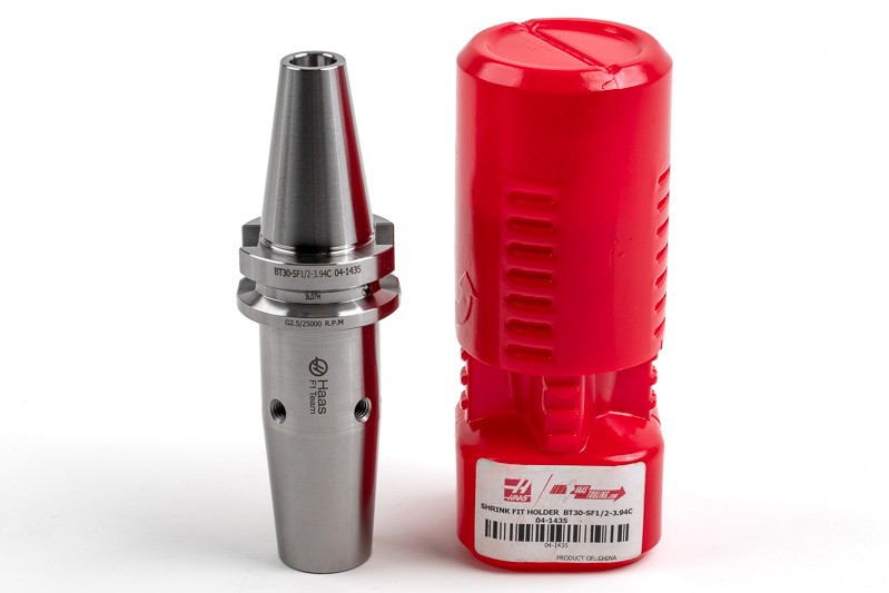

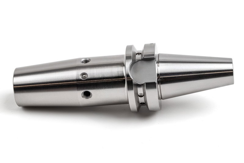

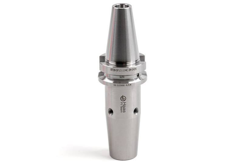

BT30 1/2" Shrink Fit Holder x 3.94 in Gage Length, TSC
Part #: 04-1435
BT30-SF-1/2-3.94C
Price: 162.95 ( / unit)
114.97
This BT30 shrink fit holder has a 0.5 in \ 1/2" bore diameter, and a 3.94" gage length. It offers very low runout (0.0001" TIR), very high grip force, and quick tool changeovers when used in conjuction with Haas shrink fit machines. It is through-tool coolant (TSC) capable, with a M12x1.75 pull stud/retention knob thread.
Taper BT30
[ØD] Bore Diameter 0.5 in \ 1/2"
[ØBD2] Minimum Body Diameter 1.063 in
[ØBD] Maximum Body Diameter 1.339 in
[GL] Gage Length 3.94 in
[OAL] Overall Length 5.84 in
[LSCN] Minimum Clamping Length 1.457 in
[LSCX] Maximum Clamping Length 1.850 in
[SIG°] Angle 4.5 °
Concentricity 0.00012”
Balanced to RPM 25000
Retention Knob Thread Size M12-1.75
Through Tool Coolant Yes
Spindle Drive Slots Yes
Weight 1.8 lbs \ 0.8 kg
