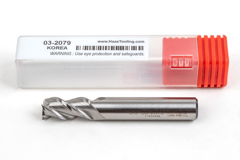

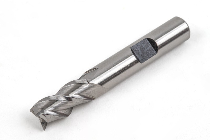

3/8" Dia. HSS End Mill, 3 Flute, Uncoated, 3/8" Weldon Shank x 3/4" LOC, Square Profile, HM2
Part #: 03-2079
EM HSS 3FL 3/8x3/8x3/4x2-1/2" WF
Price: 10.95 ( / unit)
8.97
This HM2 3-flute HSS (M2) end mill has a 0.375 in \ 3/8" cutting diameter, with a 3/8" weldon shank, 3/4" length of cut (LOC), square profile, and a 2-1/2" overall length. It is uncoated, and made to cut aluminum/non-ferrous materials. This end mill is designed to center-cut.
ISO Material Chart
[ØDC] Cutting Diameter 0.375 in \ 3/8"
Haas Milling Series HM2
Material HSS (M2)
Coating Uncoated
Corner Type Square
Shank Type Weldon
[ØDMM] Shank Diameter 0.375 in
[LOC] Length Of Cut 0.75 in
[OAL] Overall Length 2.5 in
[NOF] Number of Flutes 3
[FHA°] Helix Angle 42°
Cutting Direction Right
Center Cutting Yes
Variable Pitch No
Through Spindle Coolant No
