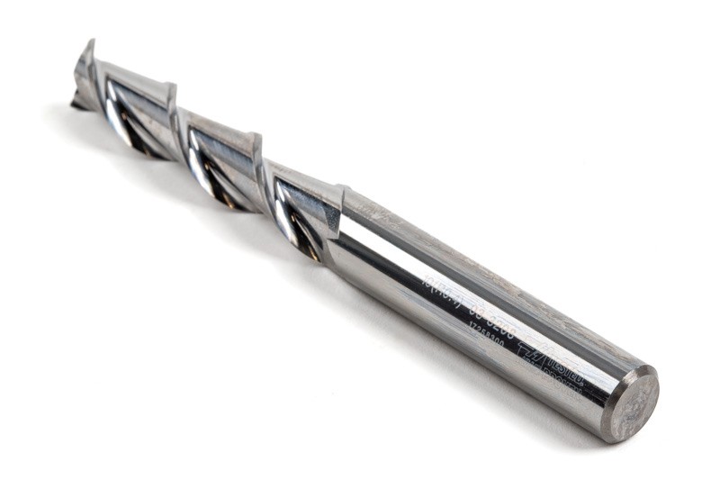

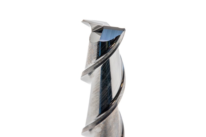

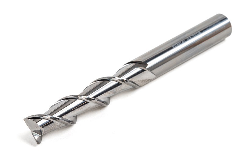

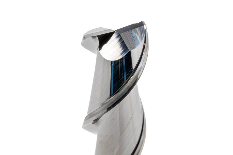

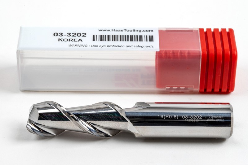

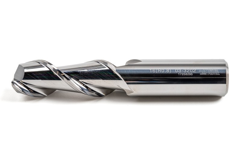

This HSAM3 2-flute carbide end mill has a 16mm cutting diameter, with a 16mm smooth shank, 40mm length of cut (LOC), 0.8mm radius, and a 90mm overall length. It is uncoated, and made to cut aluminum/non-ferrous materials. This end mill is designed to center-cut.
ISO Material Chart
[ØDC] Cutting Diameter 16.0 mm
Haas Milling Series HSAM3
Material Carbide
Coating Uncoated
Corner Type Radius
Shank Type Smooth
[ØDMM] Shank Diameter 16.0 mm
[LOC] Length Of Cut 40.0 mm
[OAL] Overall Length 90.0 mm
[NOF] Number of Flutes 2
[CHW\RE] Chamfer \ Radius Size 0.8 mm
[FHA°] Helix Angle 45°
Cutting Direction Right
Center Cutting Yes
Variable Pitch No
Through Spindle Coolant No
Weight 0.5 lbs \ 0.2 kg
