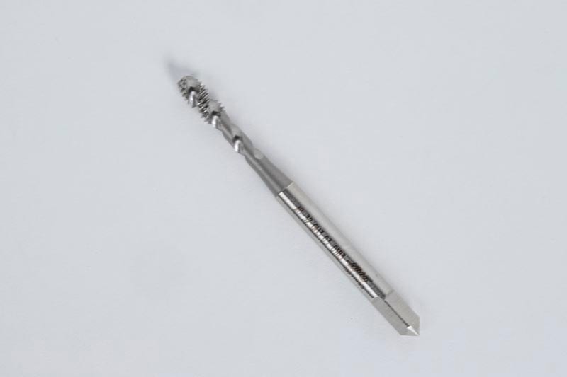

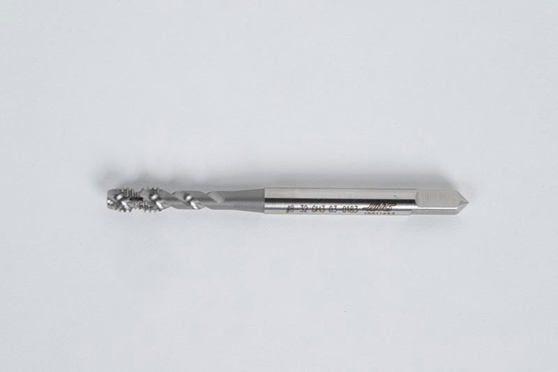

#8-32 UNC HSS-E Spiral Flute Tap, 0.168" Shank x 0.276" Thread Length, 2.5XD, Mod. Bottoming, 2 Flute, GH3, Uncoated
Part #: 03-0183
8-32 SP FL ALUMINUM TAP
Price: 10.95 ( / unit)
6.97
TECHNICAL SPECS
Thread Size #8-32
Tap Type Spiral Flute
Shank Type Square
Material HSS-E
Coating Uncoated
[TPI] Threads per Inch 32 tpi
Tap Drill Diameter 0.138 in
[ØDC] Cutting Diameter 0.164 in
[ØDMM] Shank Diameter 0.168 in
[L2] Chamfer Length 2P - 3P
[L1] Thread Length 0.276 in
[LU] Usable Length 0.752 in
[OAL] Overall Length 2.126 in
[SS] Square Size 0.131 in
[NOF] Number of Flutes 2
[FHA°] Helix Angle 50
Length / Diameter 2.5 X D
Thread Class GH3
Through Spindle Coolant No
