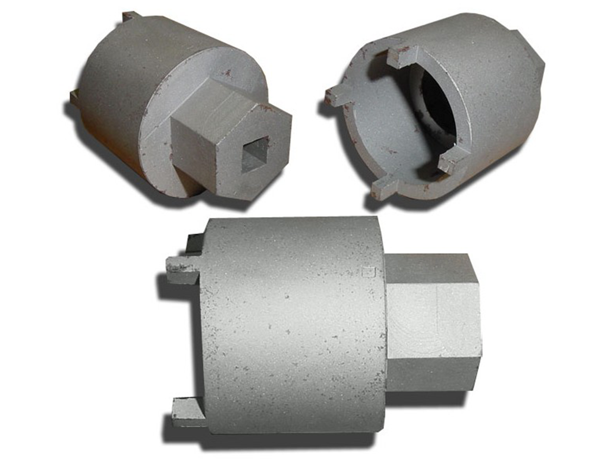

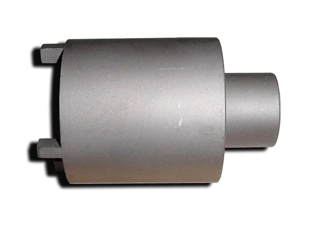

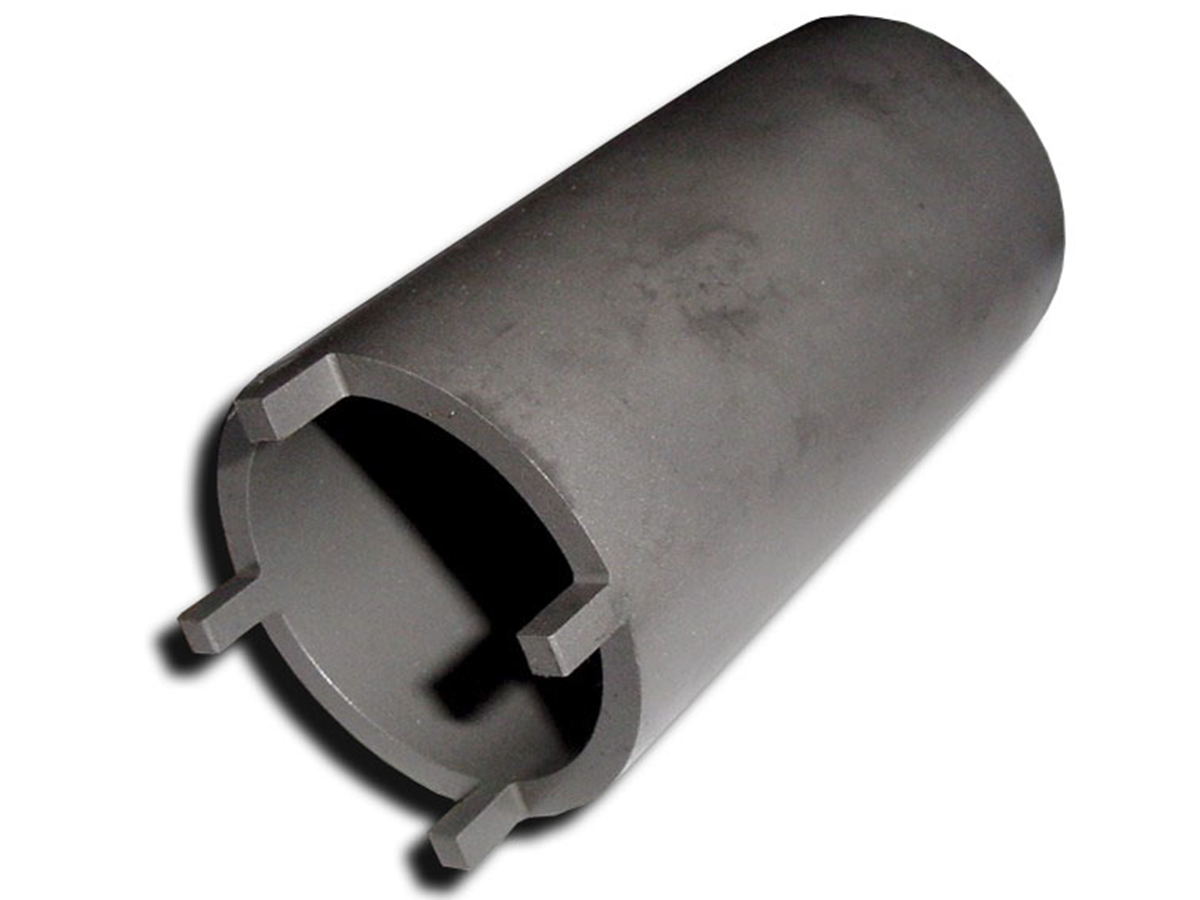

T-1069 32 mm Short Bearing Nut Wrench (Motor End) Service Van
T-0047 32 mm Long Bearing Nut Wrench (Motor End) Service Van
T-1357 Bearhug Socket BG-09 40 & 50-taper At HFO
T-1601 32 mm Collar Nut Wrench (Bearing Support End) Service Van
T-1542A 40 mm / 50 mm Bearing Nut Wrench (Motor End) At HFO
T-2098 50 mm Bearing Nut Wrench For Large Motor Housing (Z-Axis VF-6/VF-12/ST-40) At HFO
T-1555 40 mm/ 50 mm Collar Nut Wrench (Bearing Support End) At HFO

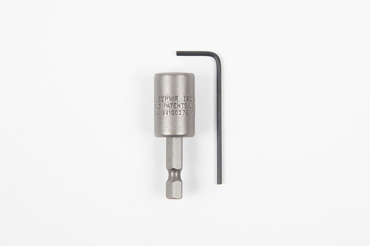

99-1089 Torque Screwdriver Tool Service Van

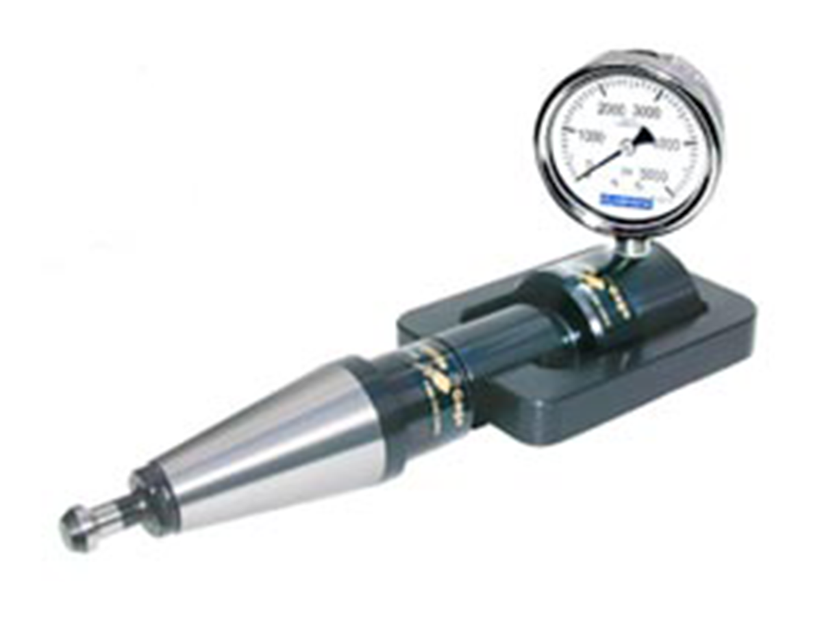

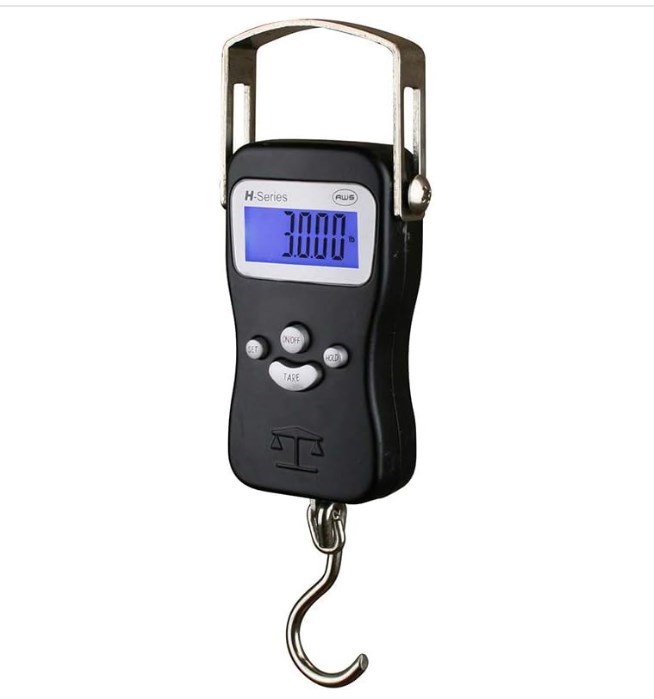

93-2772 Drawbar Force Gauge Service Van

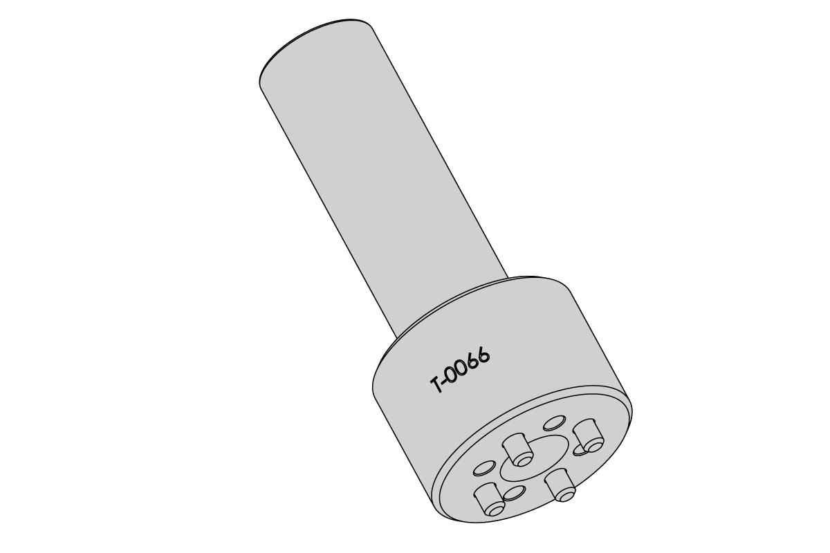

T-0066
Belted Drawbar Guide Torque Kit
At HFO

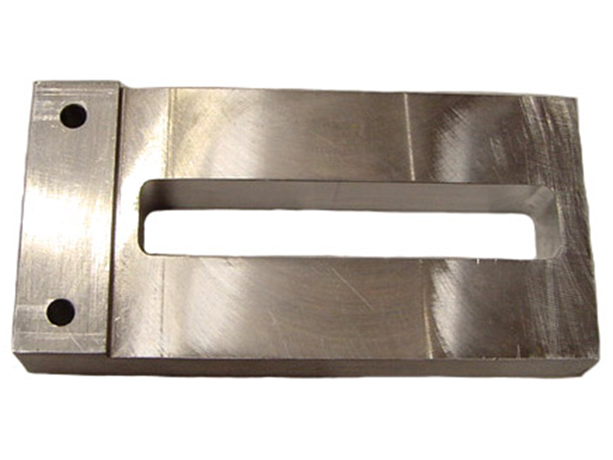

T-0060 Encoder Removal Tool Assembly 2" At HFO

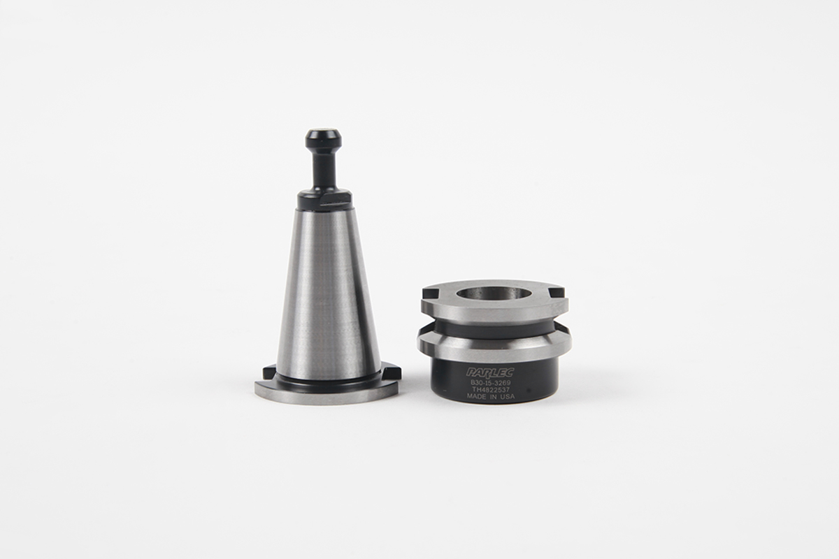

T-1224 BT-30 DT-1 Tool Changer Alignment Tool Holder Service Van
T-2173 BT-30 Tool Changer Alignment Rod Service Van

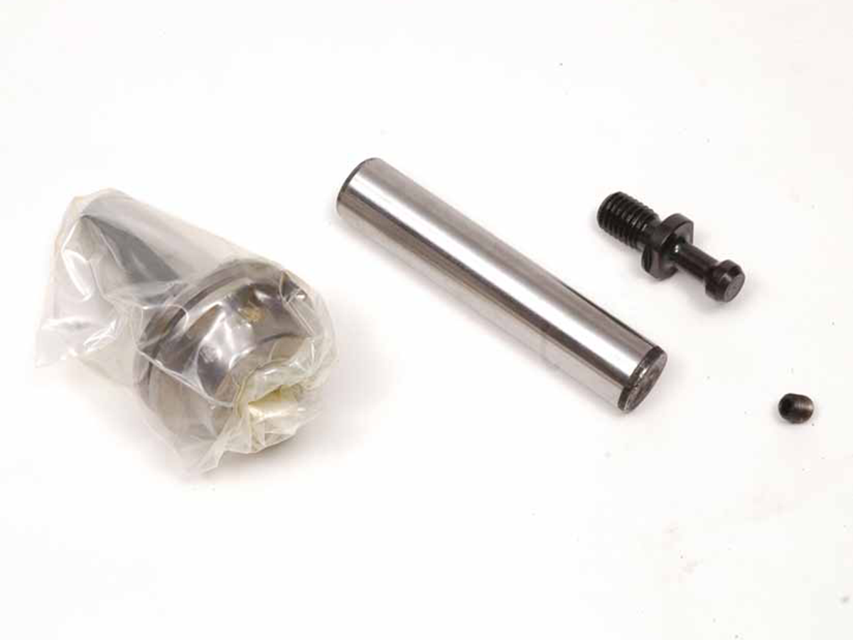

99-0619 BT-30 Tool Holder - Carousel Alignment / Parameter 64 (Comes with WIPS) Service Van

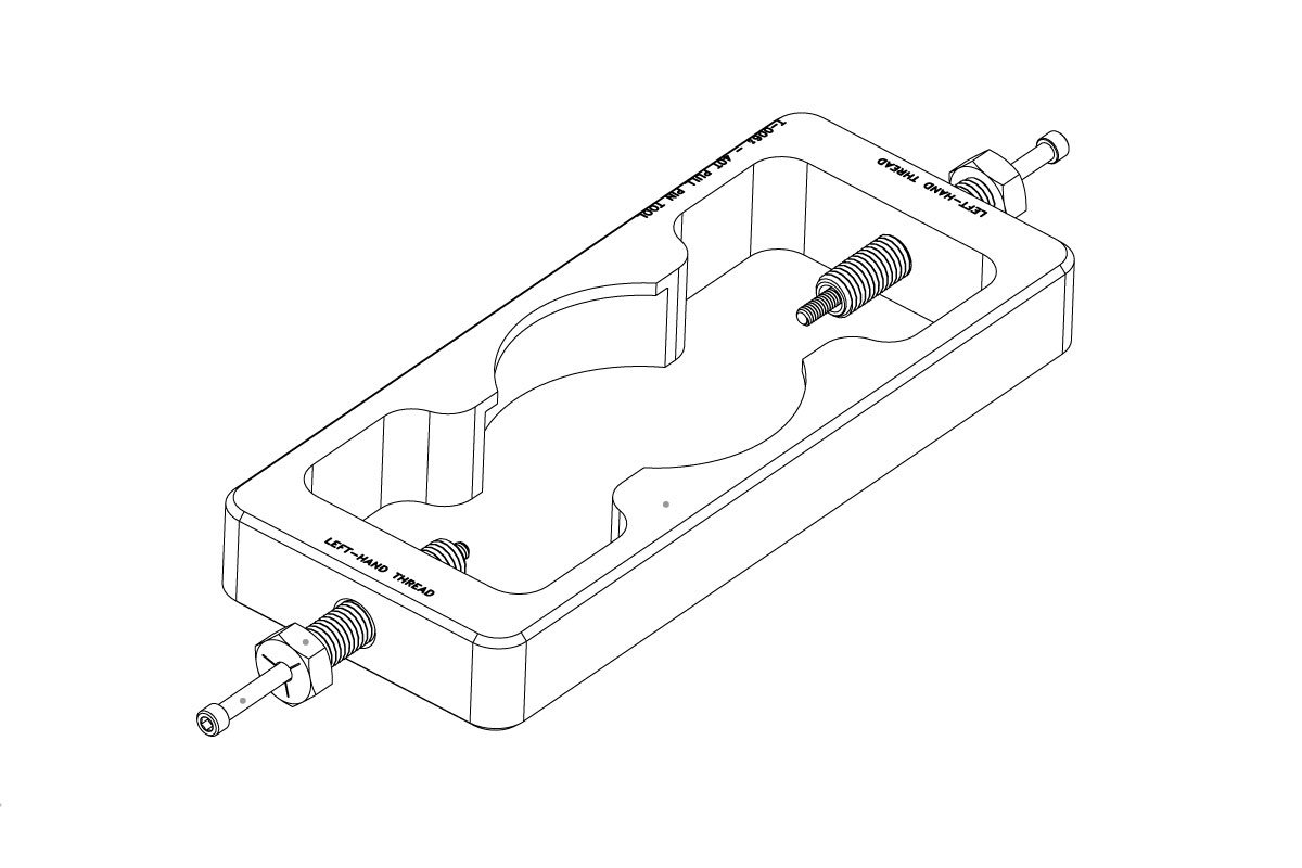

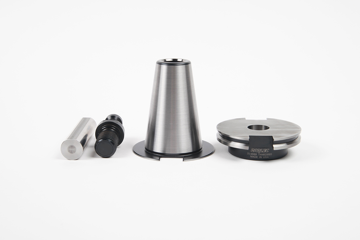

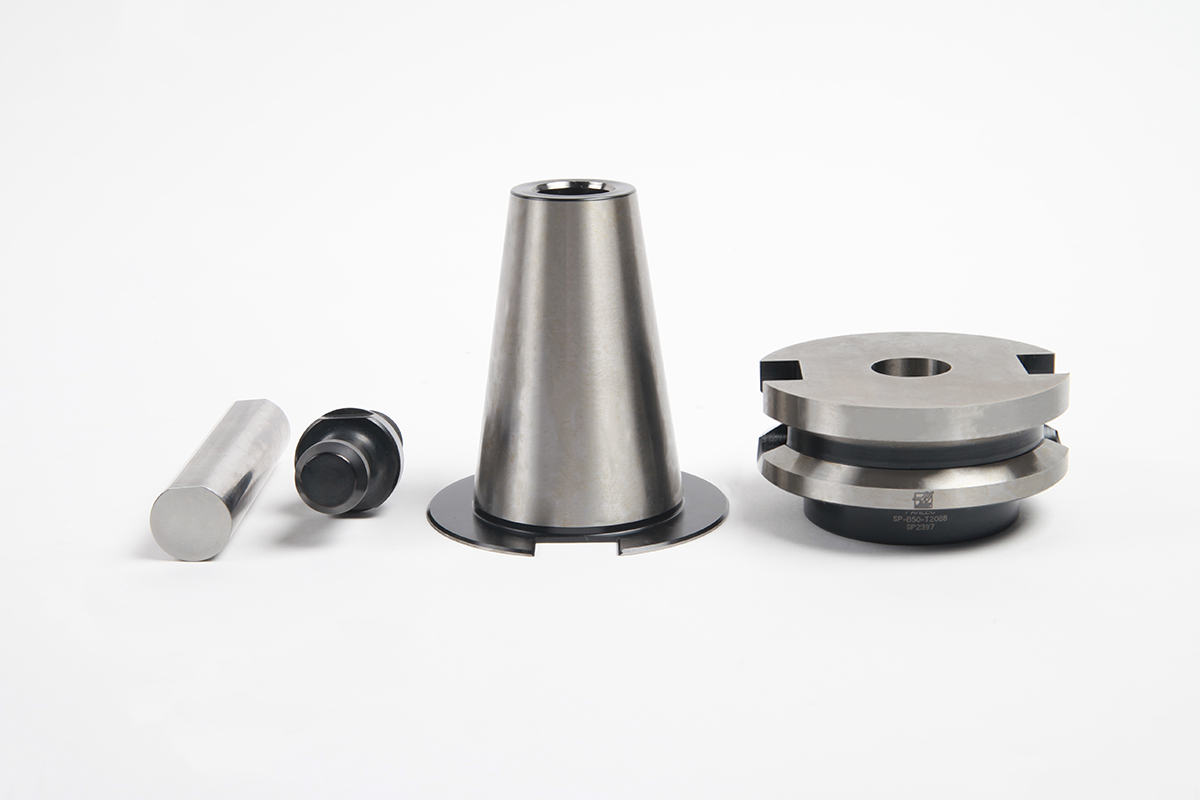

T-2086 CT 40 Taper Split Tool Service Van
T-2087 BT 40 Taper Split Tool Service Van
T-2088 BT 50 Taper Split Tool Service Van
T-2089 CT 50 Taper Split Tool Service Van

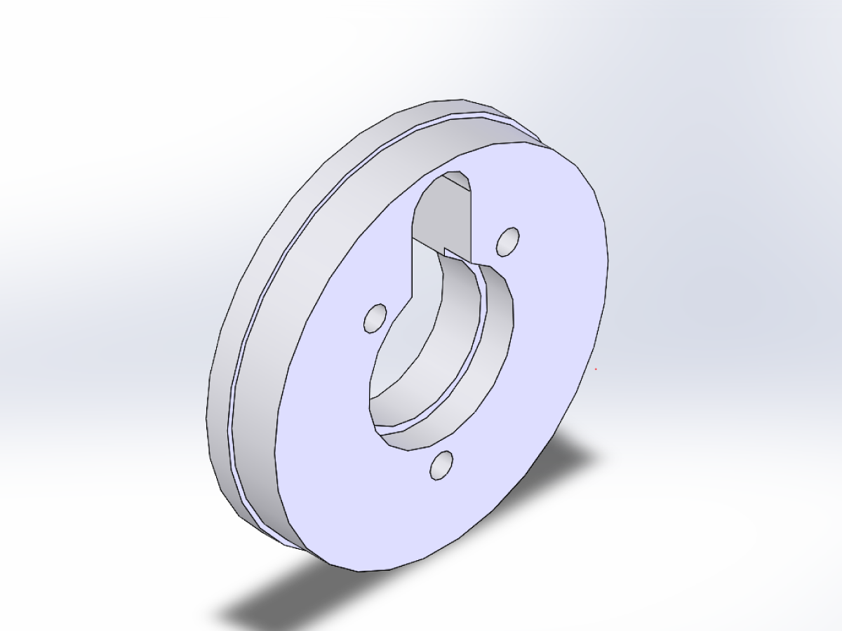

T-1635 40T Spindle Orientation Lock Tool Service Van
T-2080 50T Spindle Orientation Lock Tool Service Van

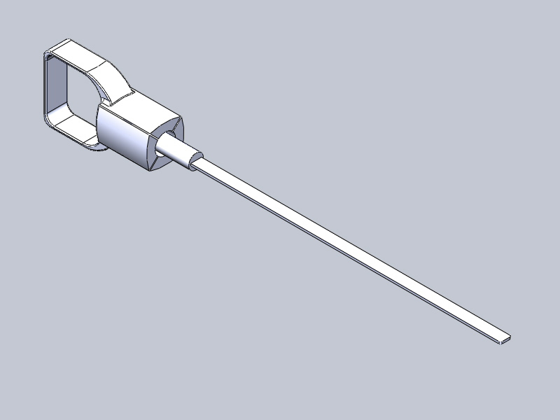

T-0144 CAMBOX OIL LEVEL DIPSTICK Service Van

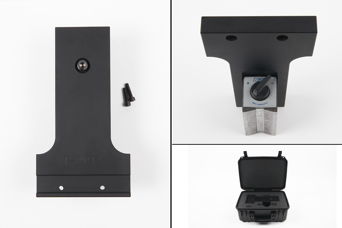

T-2181A CNC Dual Leveling Tool Service Van
T-2192 Leveling Adaptor, UMC At HFO

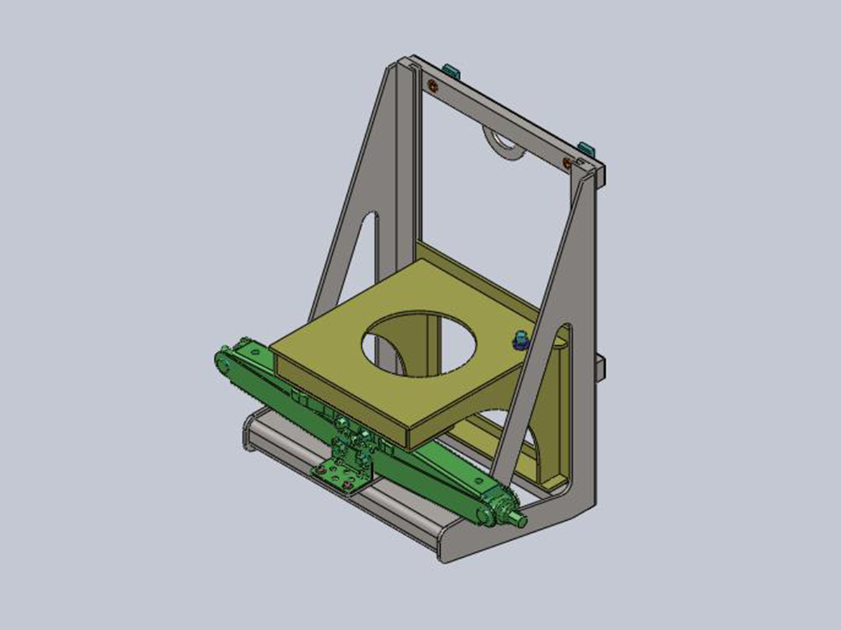

T-2194A SVC TOOL UMC750 B/C-AXIS LIFT FIXTURE At HFO

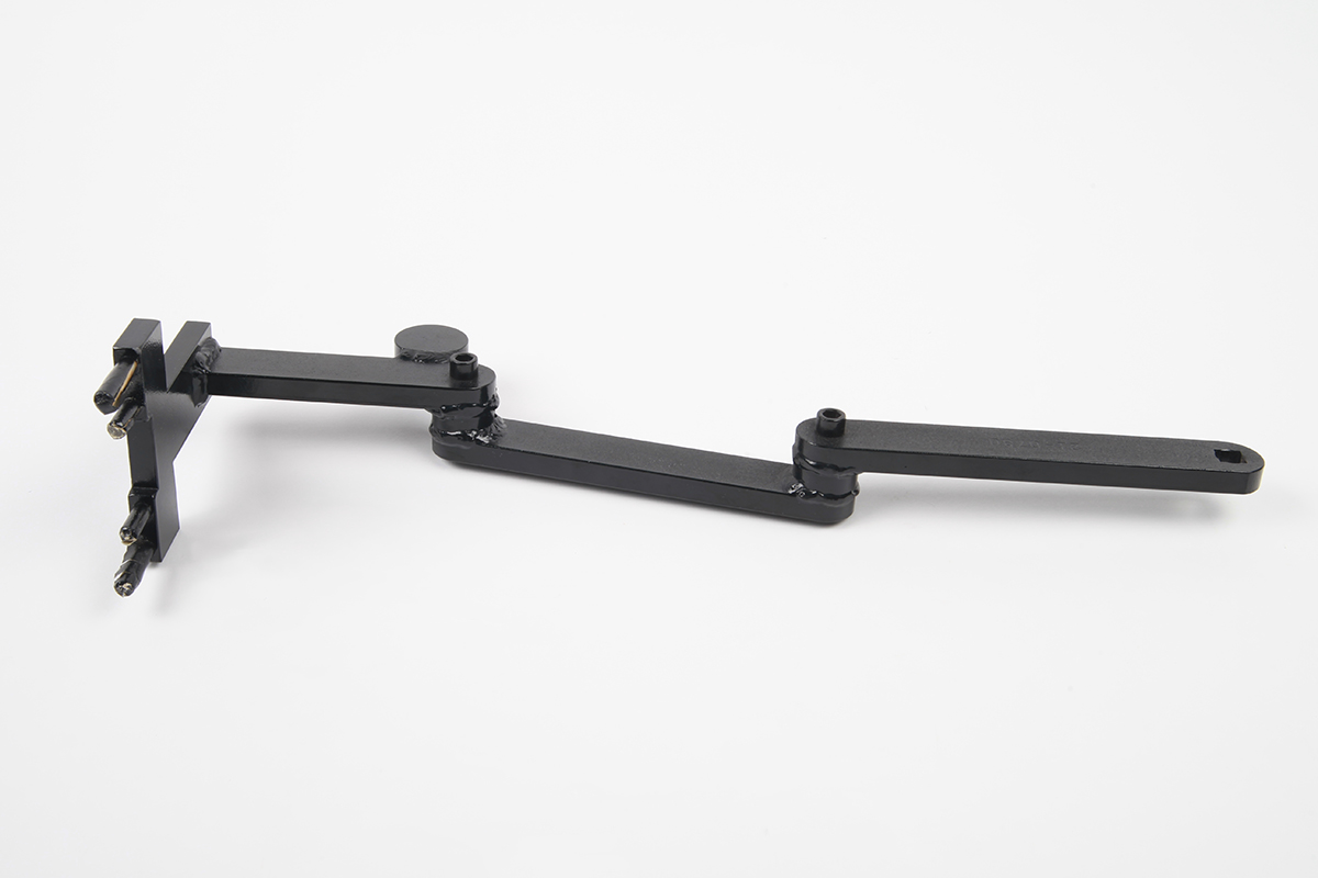

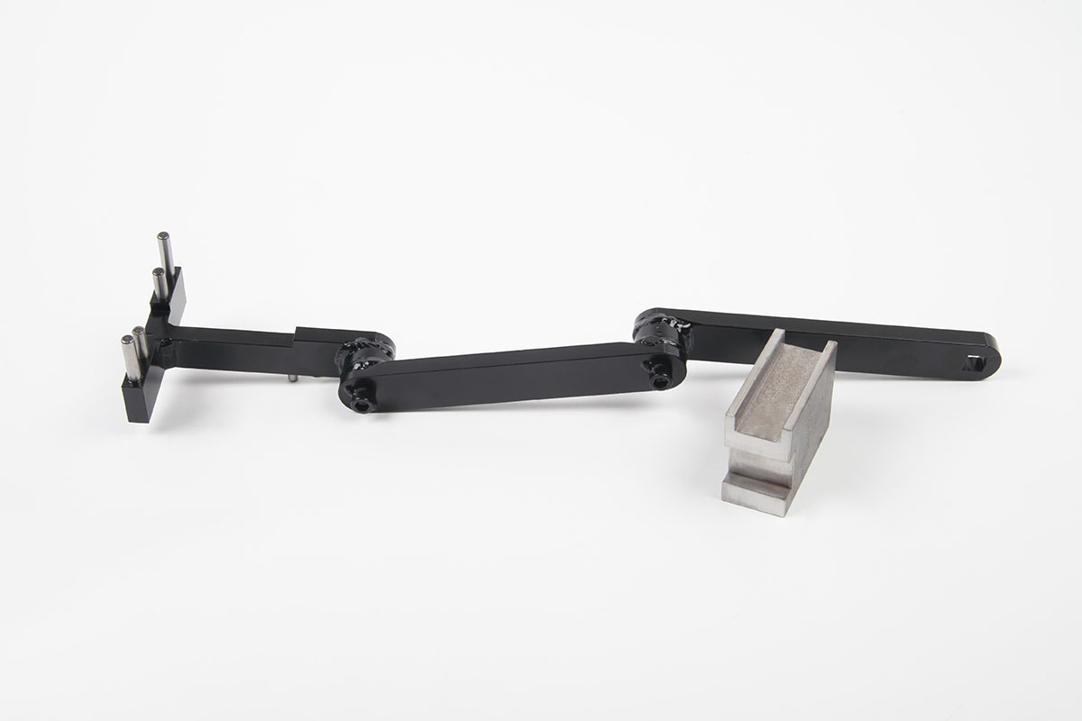

T-2108 SMTC Arm Alignment Tool Service Van

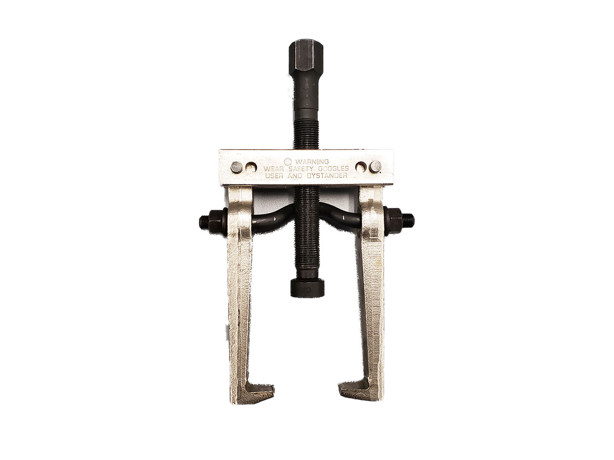

2-Jaw Puller Double Arm Removal Tool Service Van

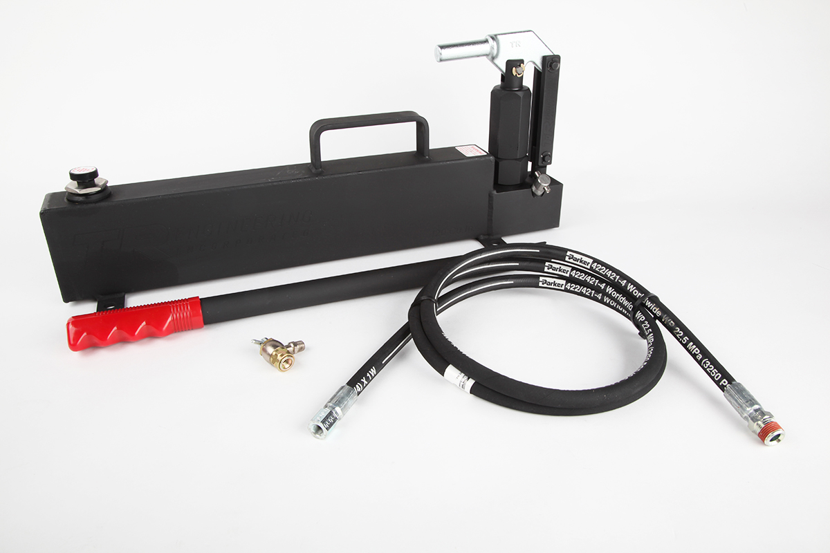

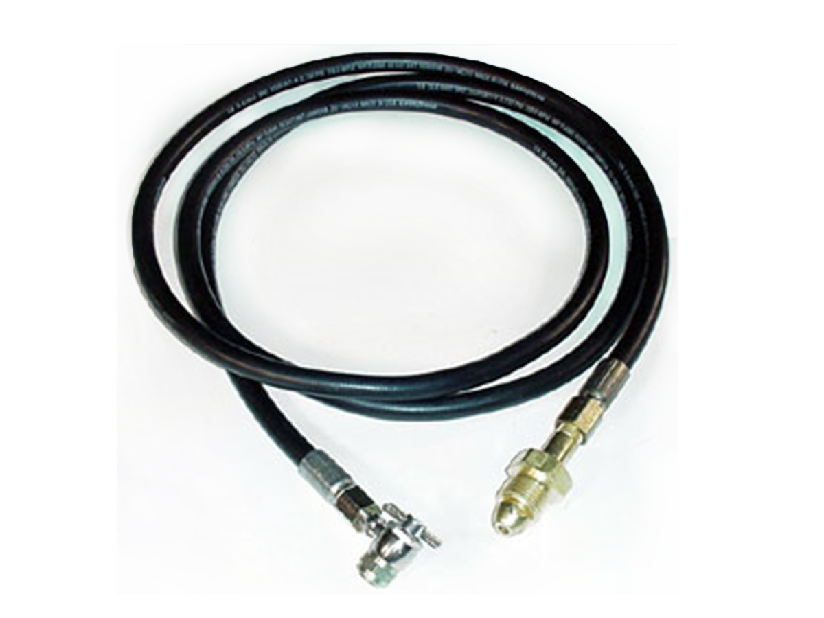

93-0206 Hydraulic Hand-Pump Kit - Assembly At HFO
35-4050A Hydraulic Charge / Discharge Service Van

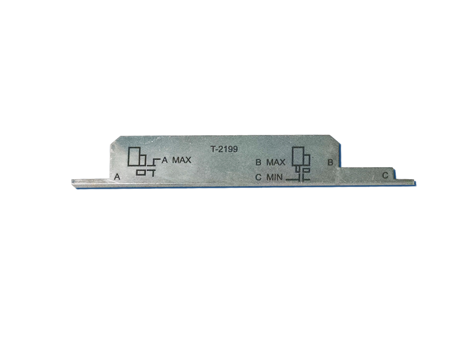

T-2199 Interlock Gap Check Tool Service Van

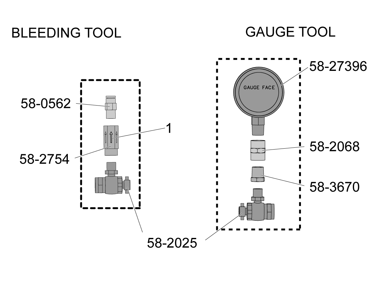

T-0062C Rotary Bleed Kit At HFO

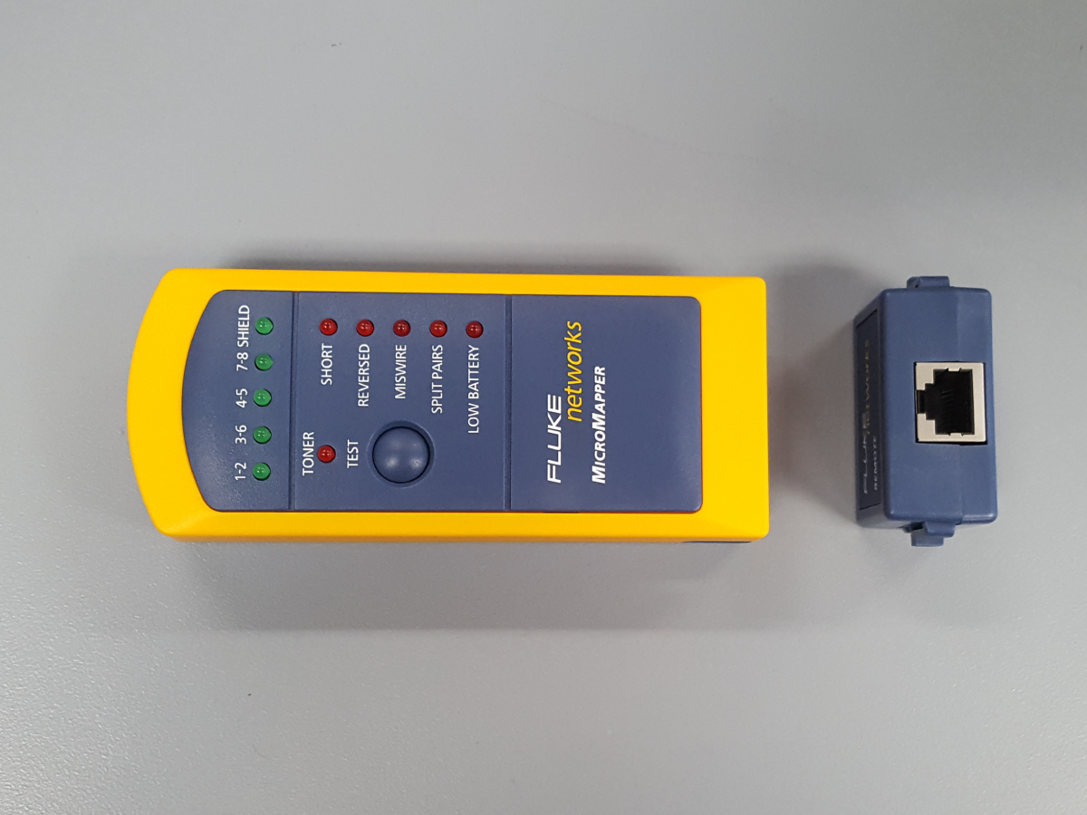

T-0150 RJ45 CABLE TESTER KIT At HFO

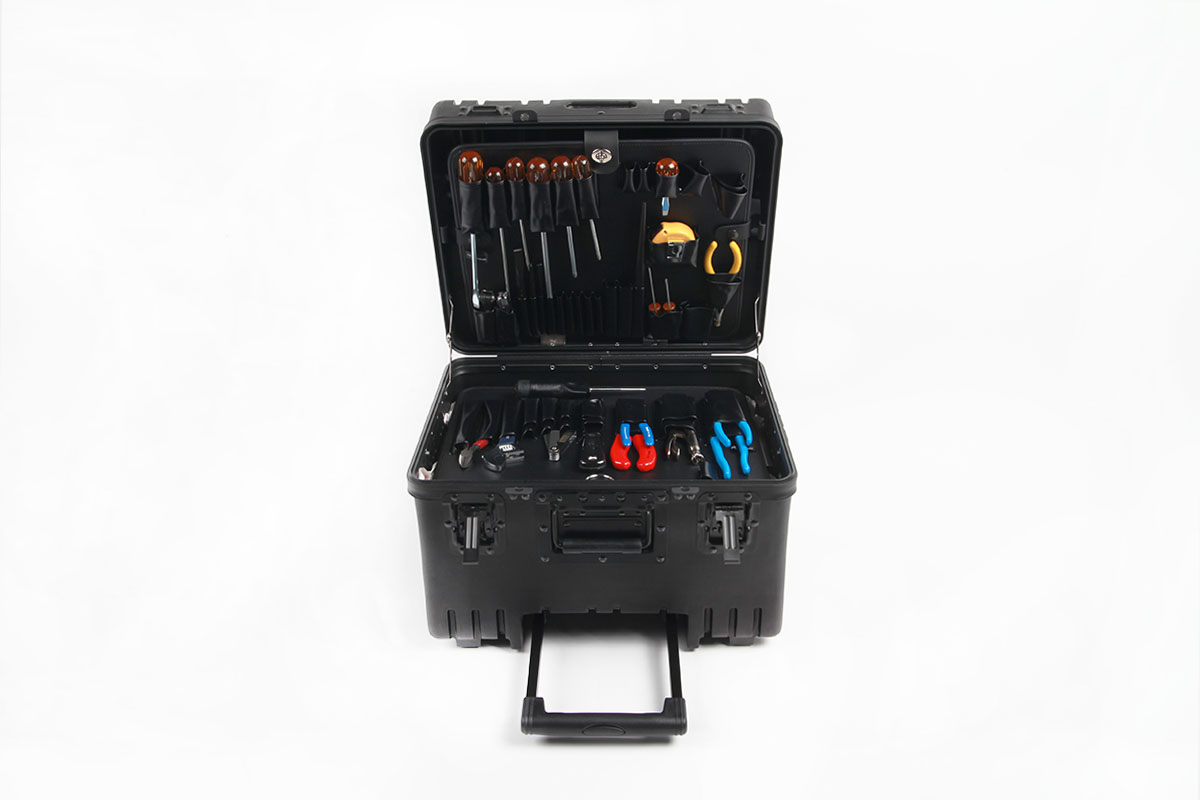

93-9500 Lockable Toolbox *** For Sale to International Distributors Only. N/A

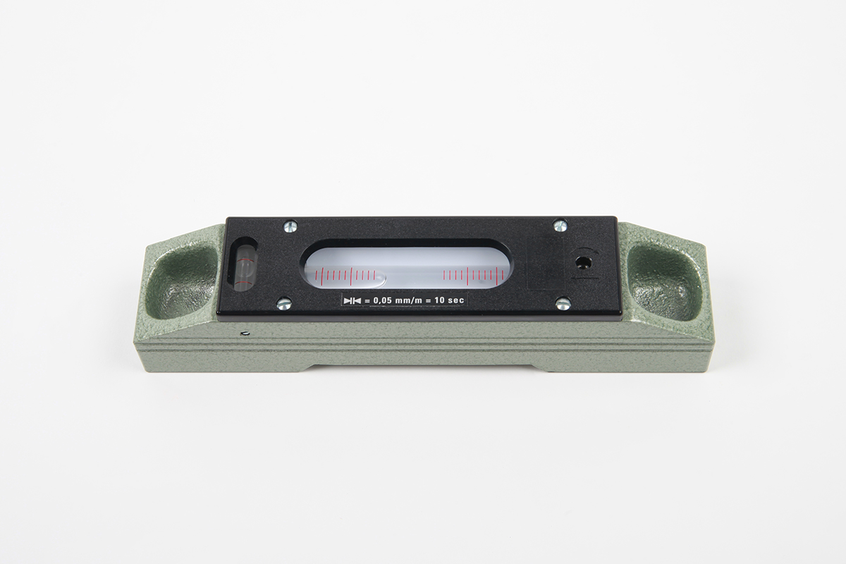

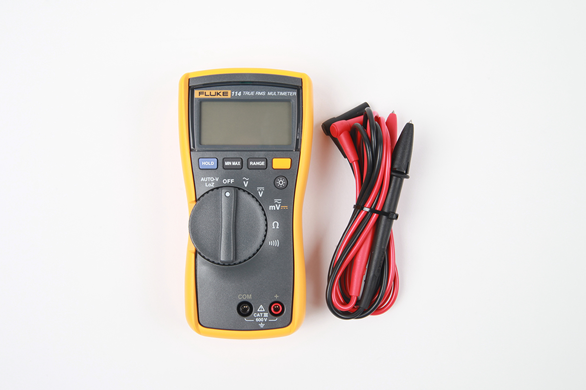

93-9501 Fluke Multimeter M12 N/A

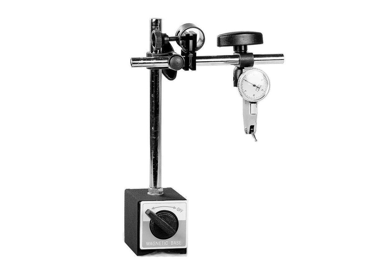

93-9502 Magnetic Base with 0.0001 Indicator N/A

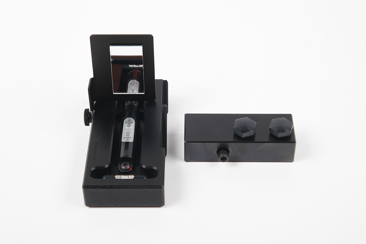

93-9503 Precision Machinist Level, 0.0005" Division N/A

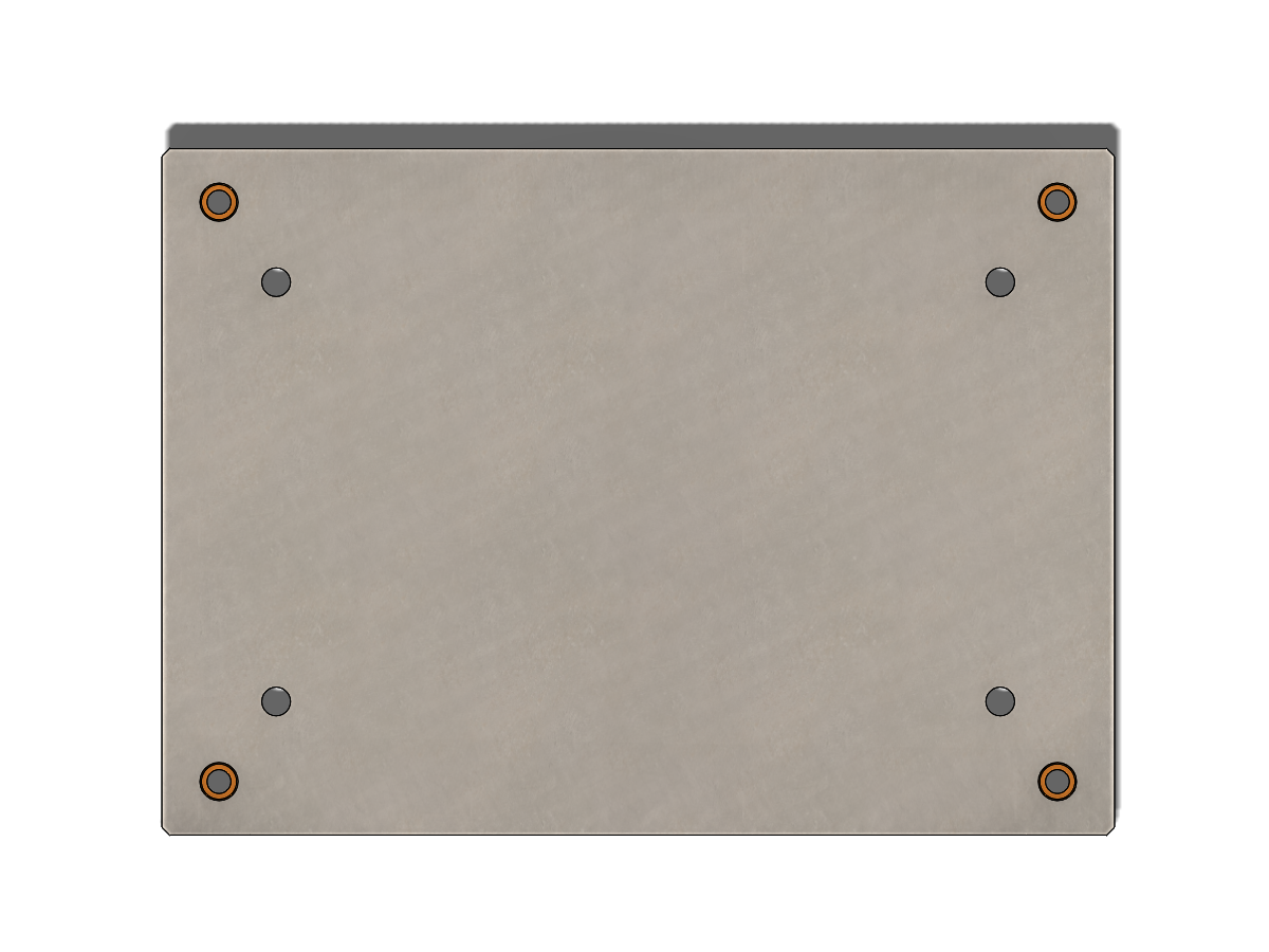

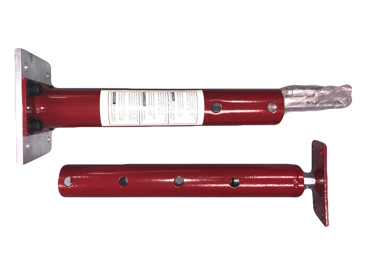

T-0098 SPINDLE HEAD SUPPORT Z-AXIS FJB-16 (For use on MiniMills) Service Van
T-0099 SPINDLE HEAD SUPPORT Z-AXIS FJB-36 (For use on Small, Medium, Large VMCs) Service Van
T-0100 SPINDLE HEAD SUPPORT Z-AXIS TM FJB-16 (For use on Toolroom Mills) Service Van

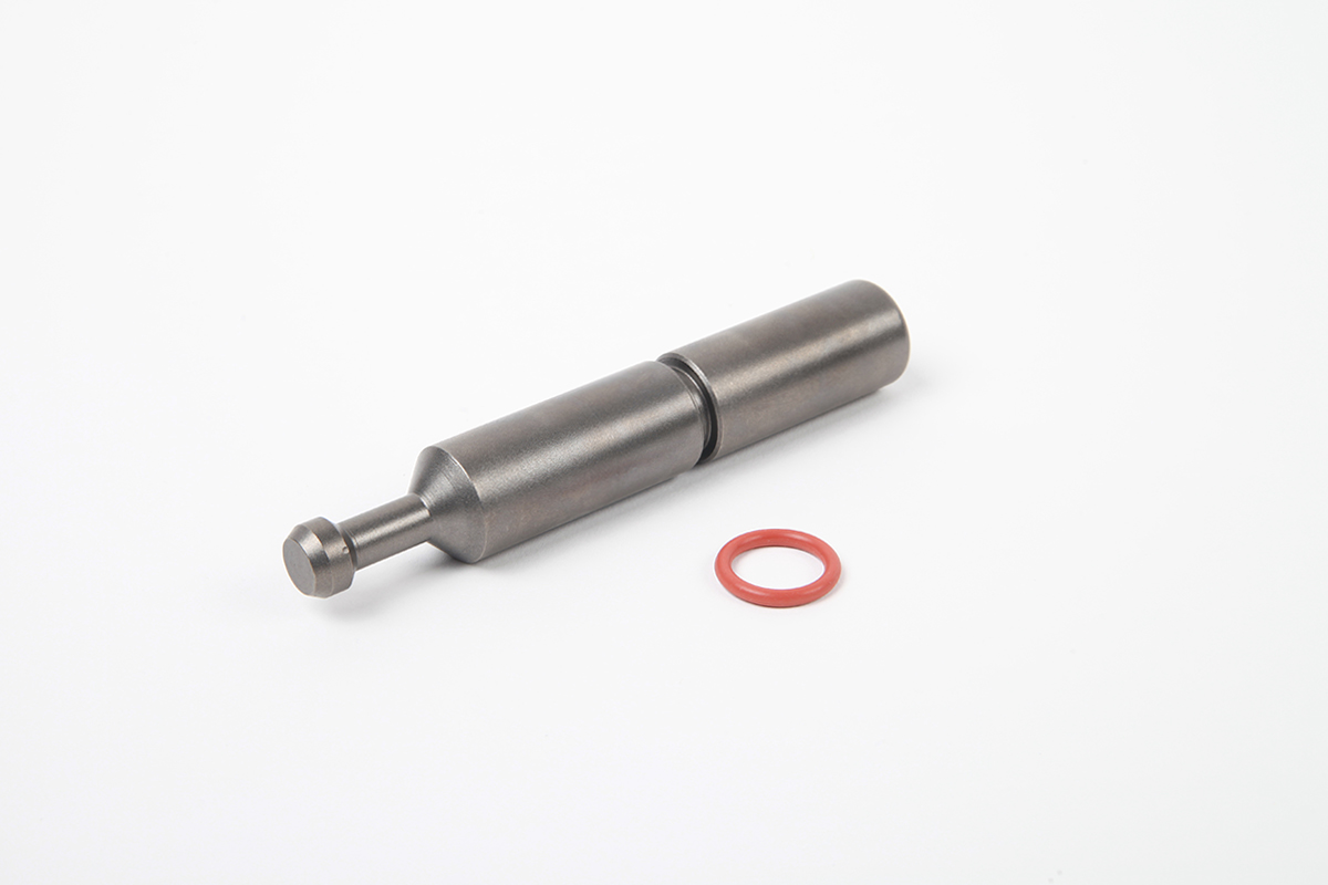

HSK-A63 O-RING MANDREL TOOL W/ PACKING
At HFO

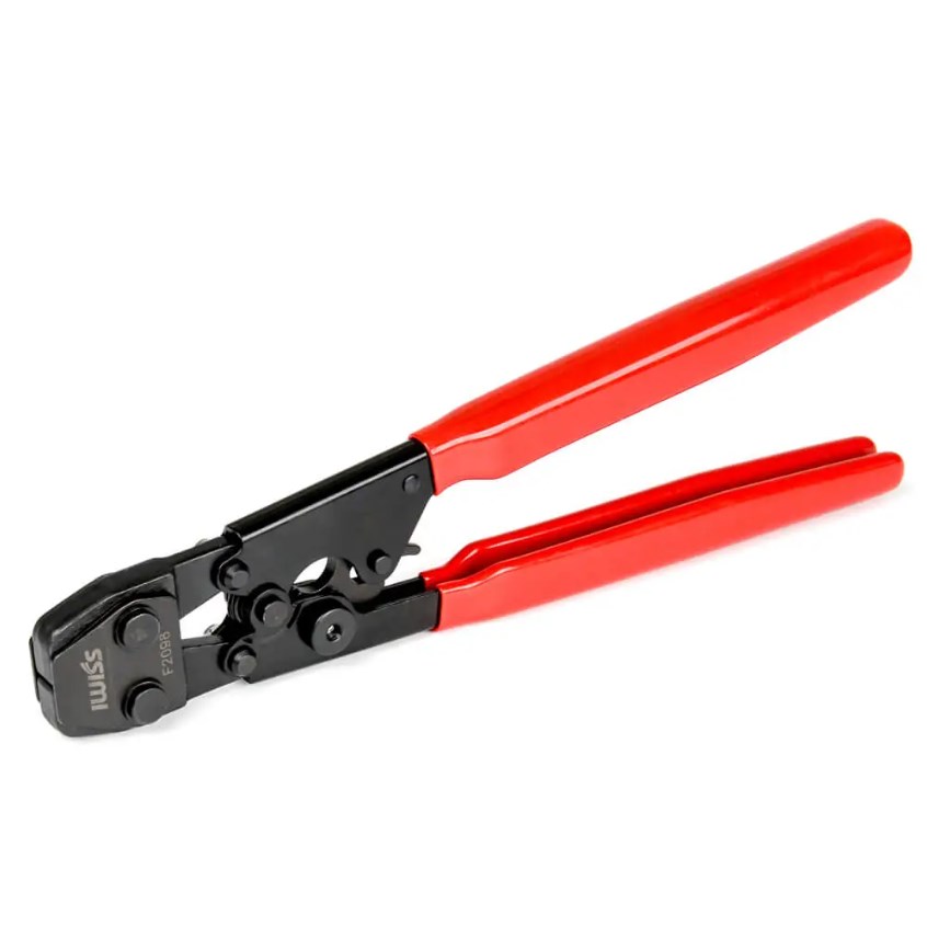

Coolant Hose Crimping Tool Service Van

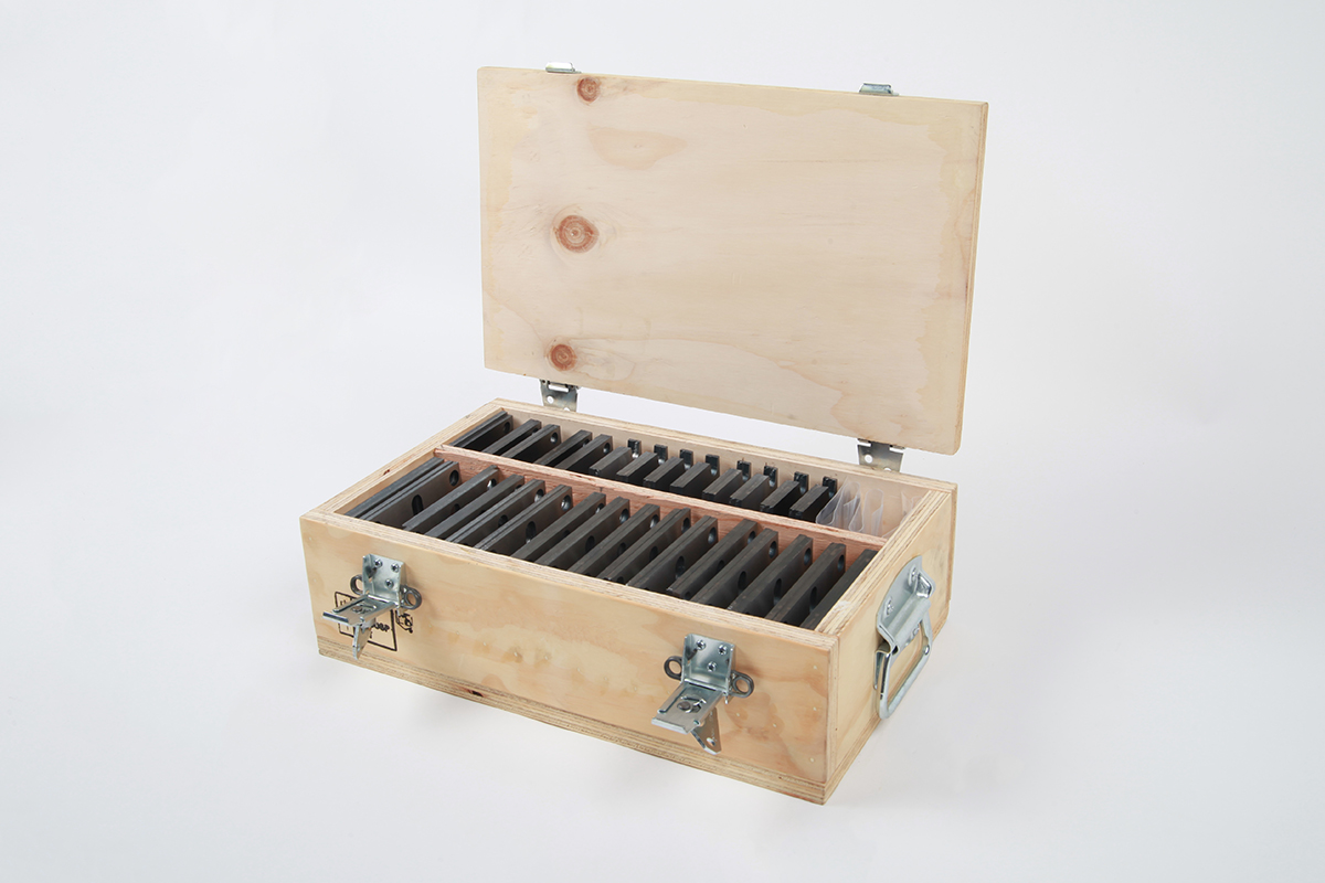

T-0080 BMT65 MASTER ALIGNMENT BLOCK At HFO
T-0081 BMT65 LIVE TOOL ASSEMBLY PRELOAD TOOL At HFO
T-0082 BMT65 ALIGNMENT INDICATOR HOLDER At HFO
T-0083 BMT65 OUTPUT SHAFT ALIGNMENT TOOL At HFO

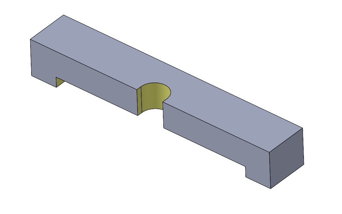

T-0067 (qty. 2) Turret Adjustment Block (req qty. (1) 40-1661 and qty. (1) 40-1662) each. 2 Needed per machine. At HFO

Suggested Toolbox Content For Every Service Engineer
