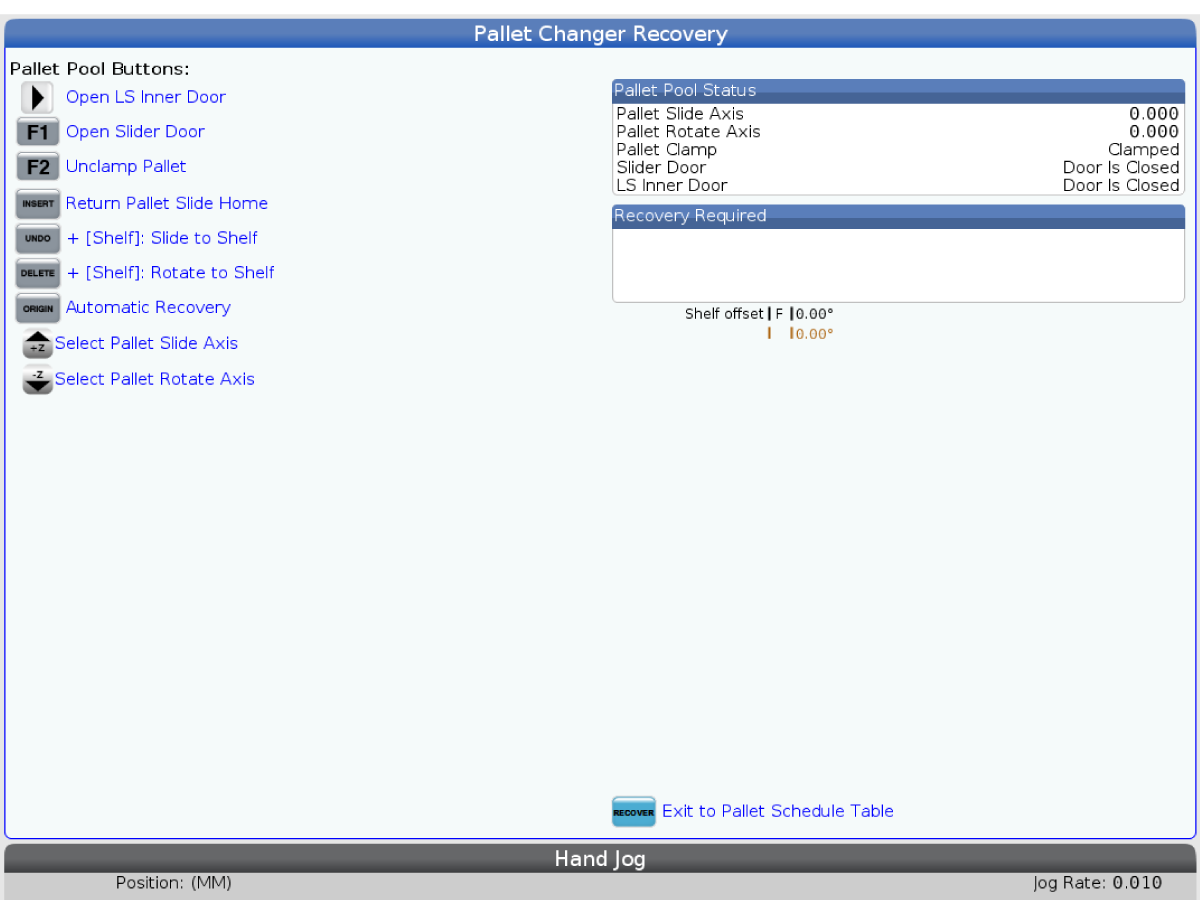

VMC-PP Fine Adjusting Drop Off and Pick Up
This procedure is to fine adjust the VMC-PP pick up and drop off of the pallets onto each individual station. Repeat this procedure to align multiple stations.
If this machine was built before 05/2025, download the latest configuration file for your machine from HBC and update the machine's configuration file.
Note: If the individual shelf parameters were adjusted and a patch file was not created, the configuration update will set the changed values back to the factory settings.
Note: When performing this procedure, change the dimensioning setting to MM using Setting 9.
Adjusting saddle to station alignment:
Use the USB Service key to go into Service Mode.
Enter pallet recovery page and press the letter of the station that needs adjustment then [DELETE] to rotate the pallet pool to the selected station.
Press [-Z]  or  [+Z] to select the Pallet Rotate Axis or Pallet Slide Axis
Test the transition from the ram to the shelf by jogging the pallet onto the station using PS. If the transition needs adjustment, press [INSERT] to bring the pallet back on to the saddle and adjust the PR in the needed direction and test again till the pallet transition is smooth.
VMC Pallet Pool Tool Change Offset Basing Location
VF-2 3+1 Station Shelf F
VF-2 6+1 Station Shelf F
VF-4 5+1 Station Shelf E
When going to fine adjust the shelf location at which the tool change offset is based on, the individual shelf parameter should not be adjusted. The tool change offset for the the PR or PS should be adjusted. Refer to the table to determine which shelf that is based on the pallet pool model.
Once the pallet is adjusted where you want it at the tool change offset basing shelf, Press [DIAGNOSTIC] Go to the PARAMETERS> Factory setting tab.
Search 15.078 for the PR-Axis Tool Change Offset
Type in PR then press [F2] to set the new tool change offset for that axis.
You will need to [ZERO RETURN] both the PR and PS axis after changing the tool change offset starting with the PS.
Note: Once this is done, the other shelves may need readjustment. Go through this procedure again skipping step 3 for each one of the shelves if needed.
Adjusting saddle to station alignment continued:
Once the PR is adjusted, take note of the Pallet Rotate Axis position in the Pallet Pool Status box and exit the pallet recovery page.
Press [DIAGNOSTIC] and go to the PARAMETERS> Factory setting tab.
Press [EMERGENCY STOP] then type in ROTARY and press [F1].
Find the parameter that coincides with the station you are trying to adjust.
Important: The parameter number will be between 2140 and 2149, 2314 and 2321, or 2380 and 2387.
Once the parameter is found, highlight the desired parameter and press [F2].  Double check that the populated value matches the noted value from the recovery page.
Go back to the recovery page and move the pallet pool into a state where you will be able to zero return the PS and PR axes.
[ZERO RETURN] the PS and PR axis starting with PS.
Once that has been done, test the pick up and drop off of the station.
