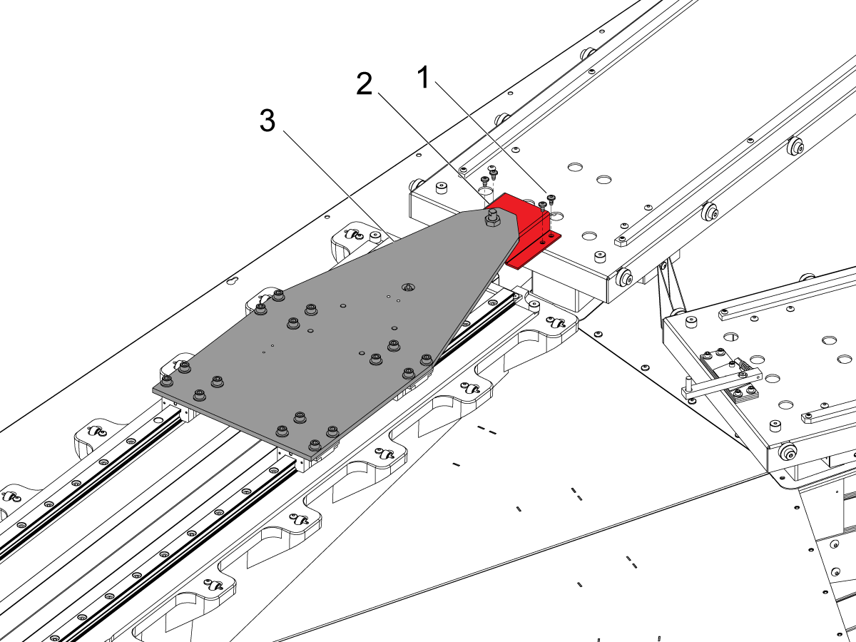

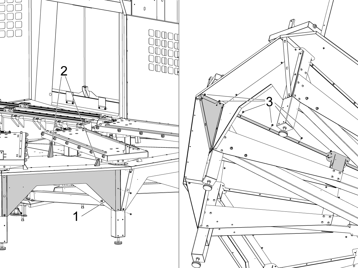

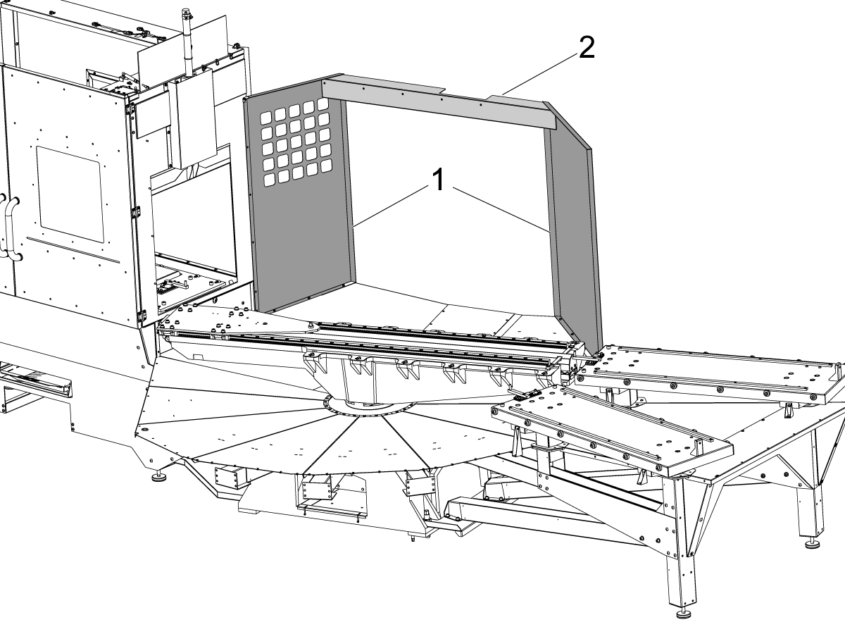

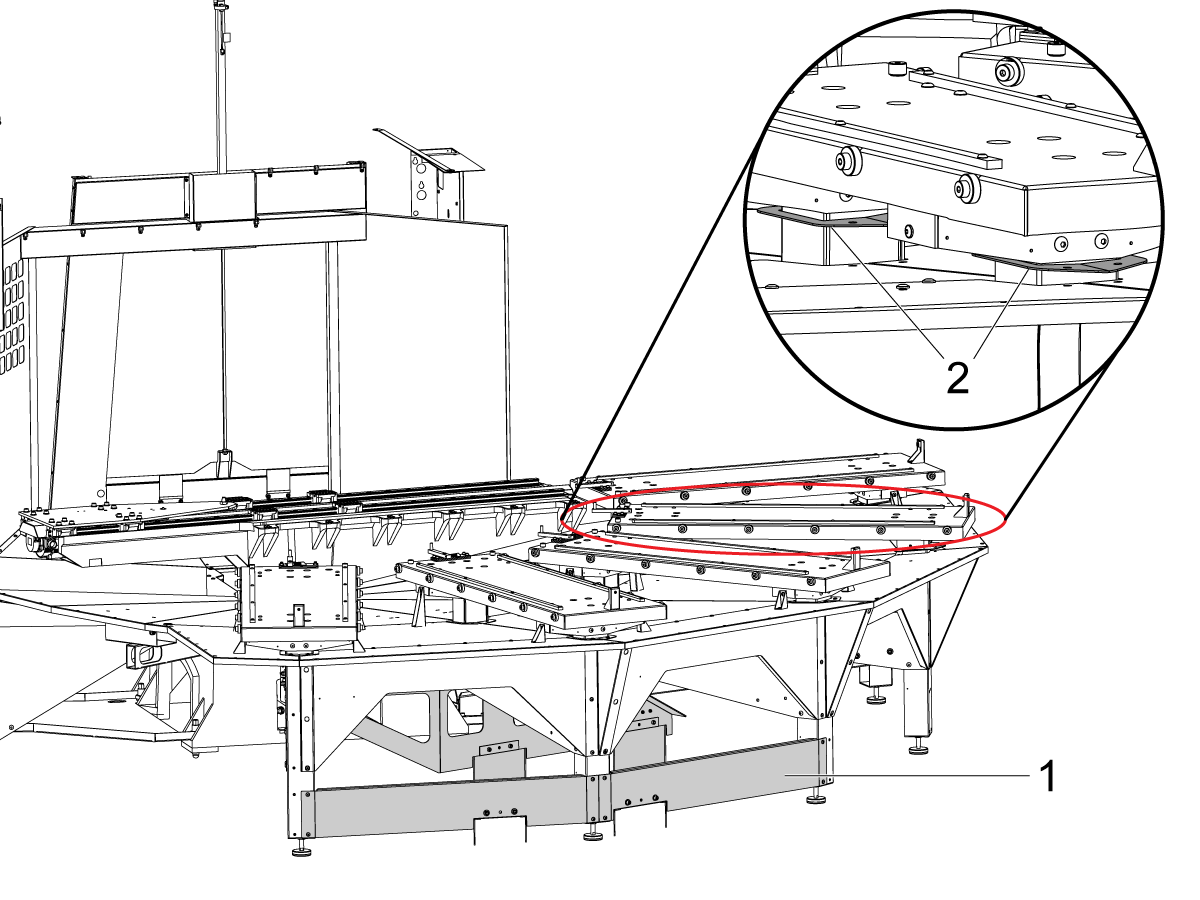

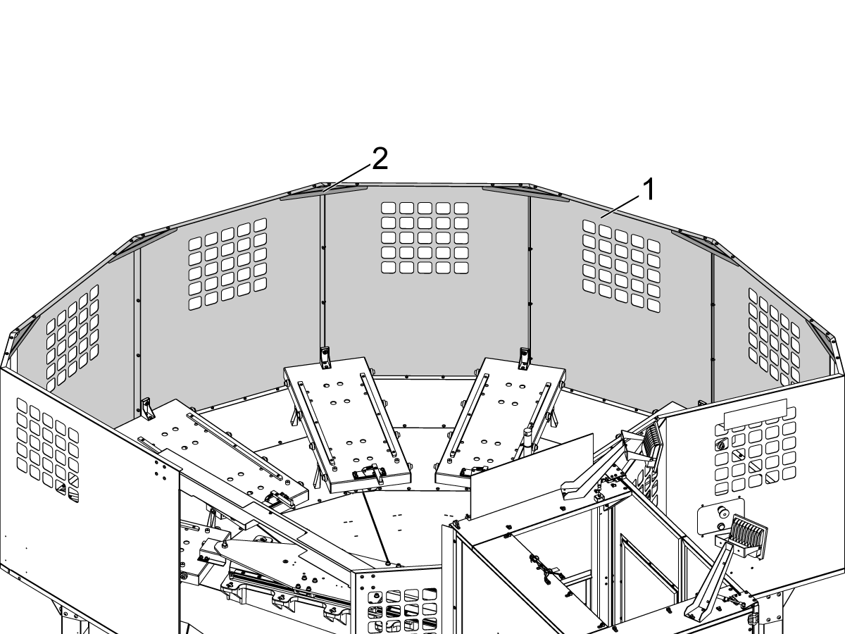

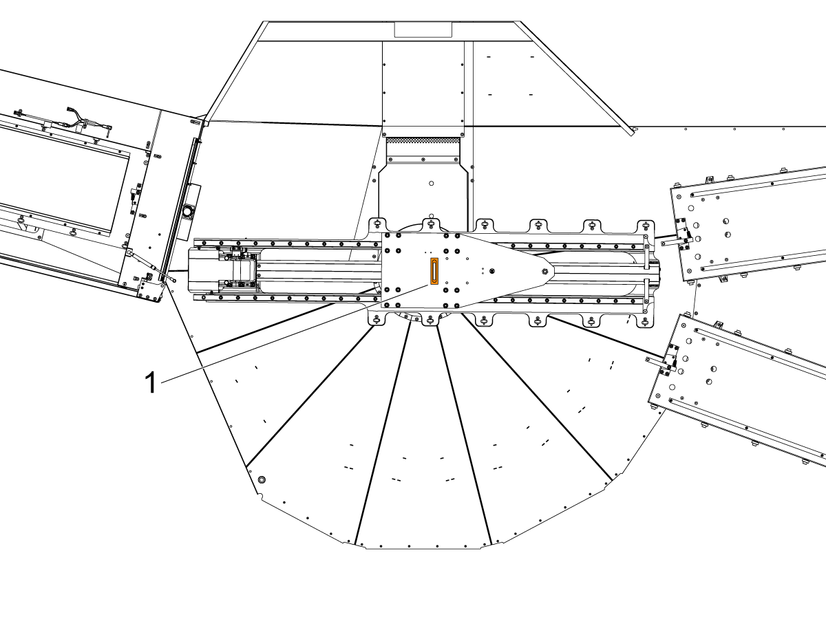

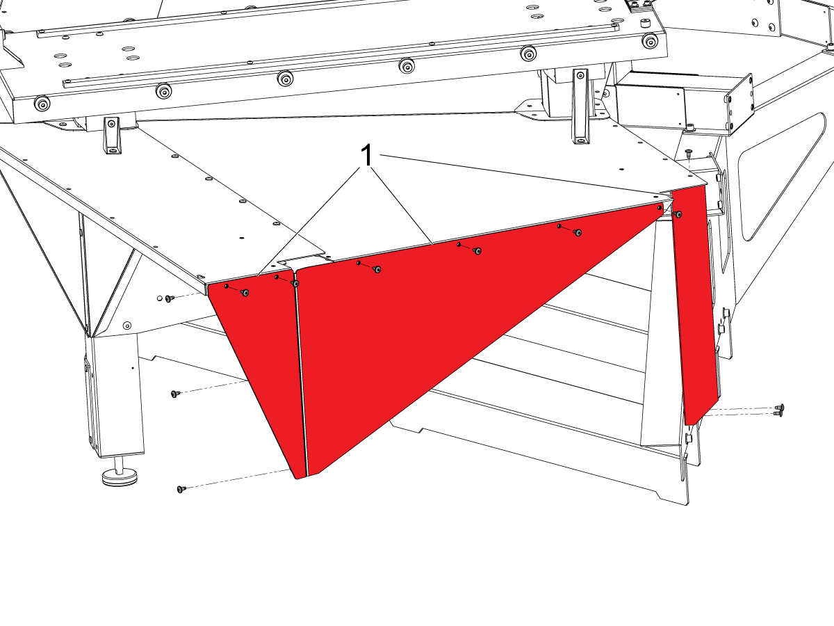

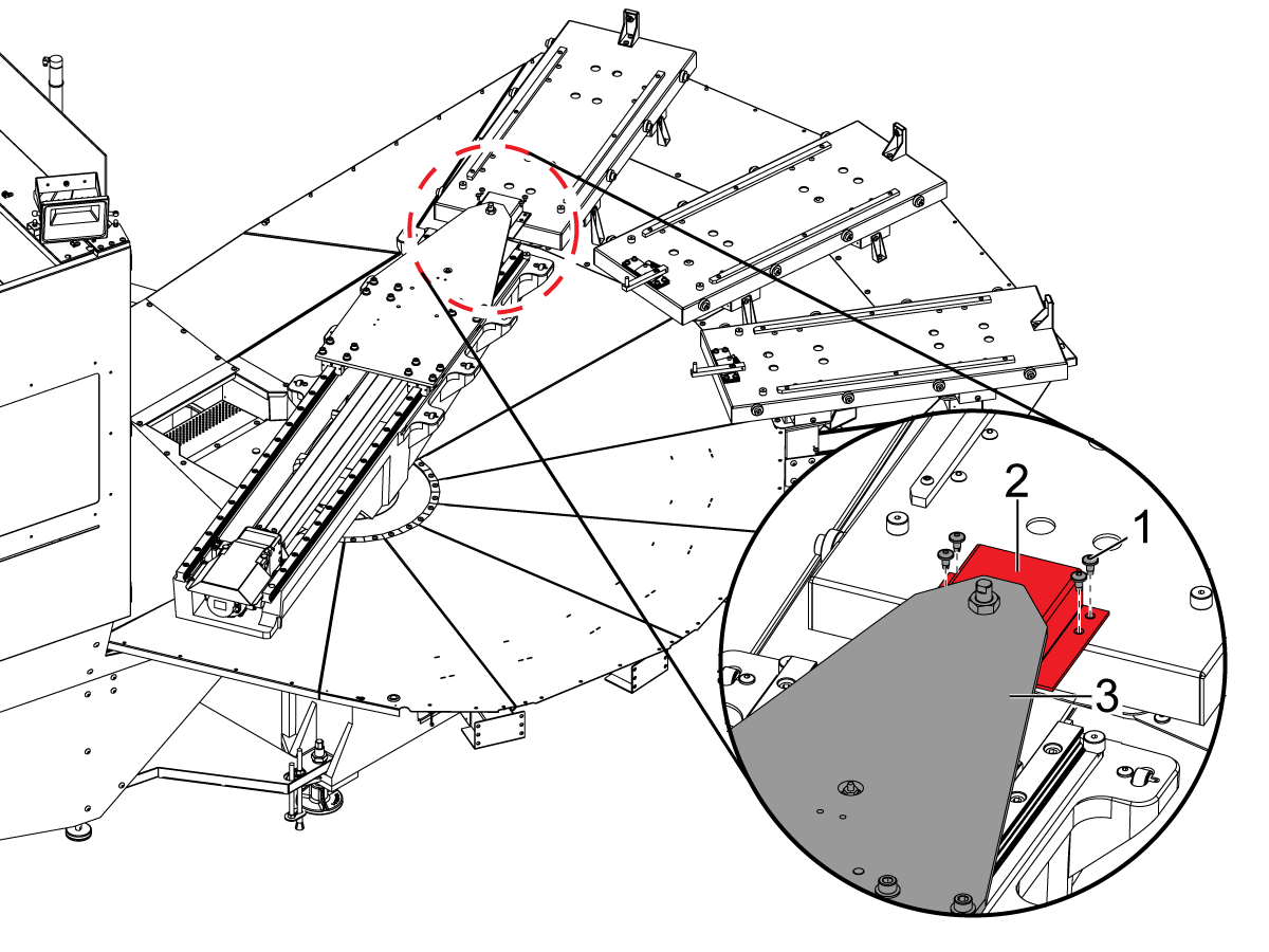

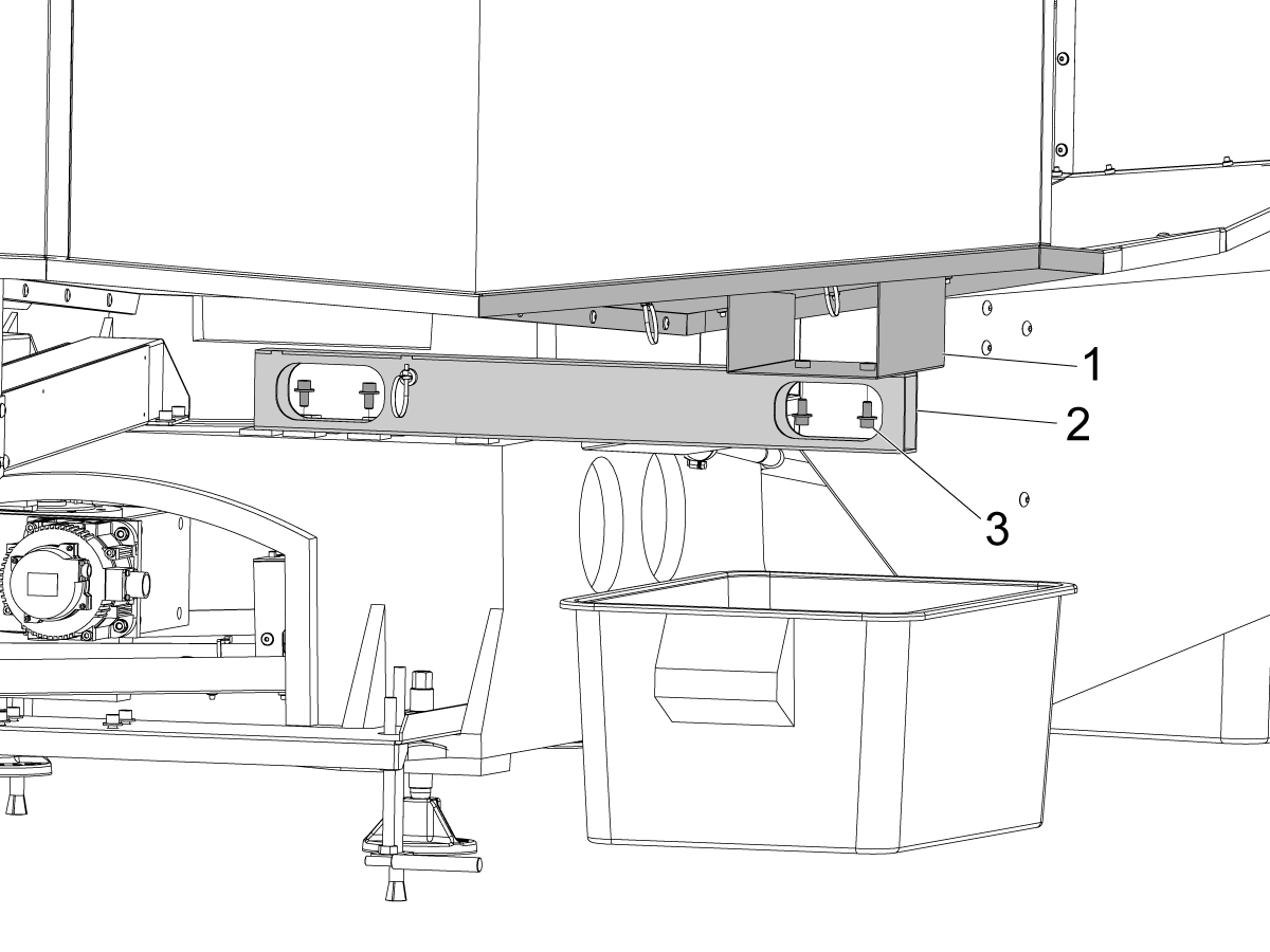

Shipping Brackets Removal
Remove the shipping bracket [2] from the Pallet Pool by removing the hardware [1] and removing the bracket [2] from the PS trolley plate [3].
After taking off the shipping bracket, attach the pallet locking mechanism [1] in its place with the provided hardware [2].
Note: The pallet locking mechanism can be found in the gray rubber maid tote.

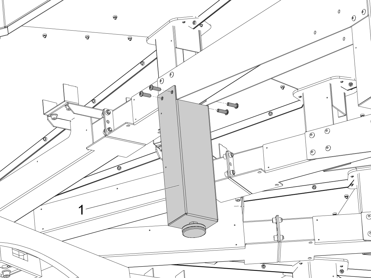

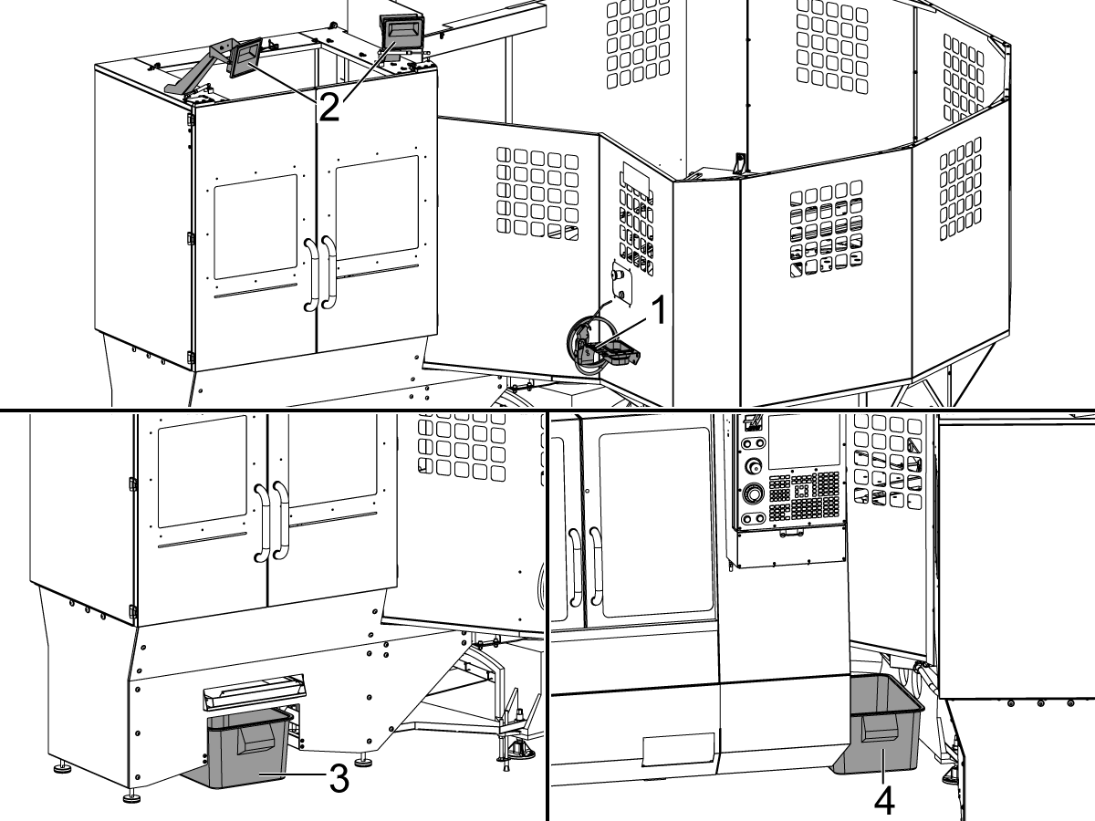

Remove the cover [1] and its hardware [2] to expose the air cylinder [4] of the automatic window on the load station and raise the air cylinder [4] so that the brackets [3] and air cylinder are attached as shown.
Repeat this process for the air cylinder of the Auto Window on the VF-2YT. The gray and yellow air line tubing coming from the lube panel will need to be connected to the Auto Window air cylinder, the ports on the air cylinder will have gray and yellow zip ties to show where each tubing connects.
Note: Do this before placing the machine and pallet pool together for easier access.

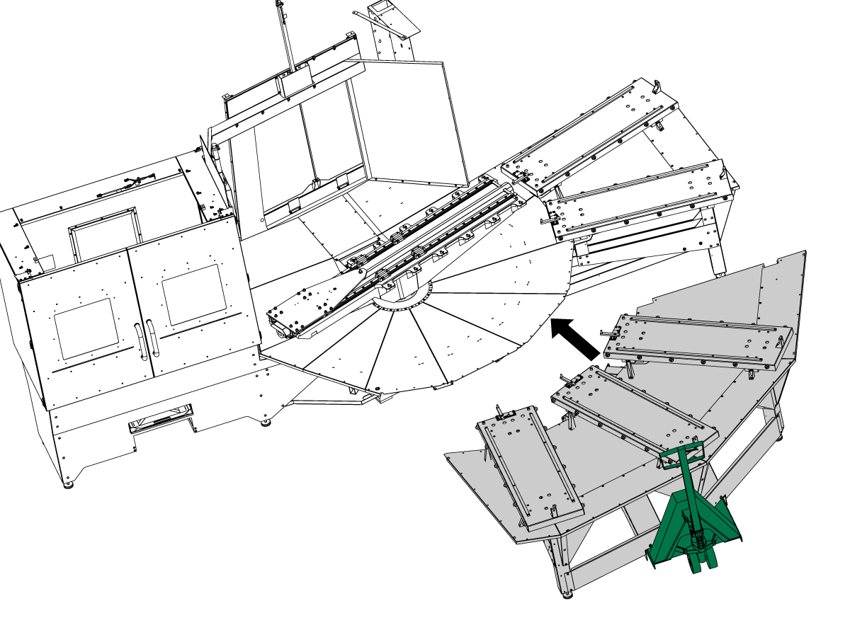

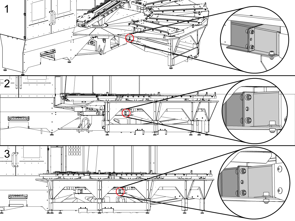

Mating the Pallet Pool

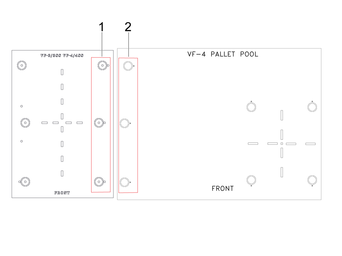

The machine and Pallet Pool should be placed using the anchoring templates. Place the templates over one another so that the points in boxes [1] and [2] line up with each other. View the image for reference.
Important: To ensure that the Pallet Pool does not become mis-aligned, it is required that the machine and Pallet Pool be anchored after leveling. Refer to the following link: Anchoring Instructions.
The VF-2YT must be level and anchored before the Pallet Pool can be installed. Refer to the VMC-Installation procedure.

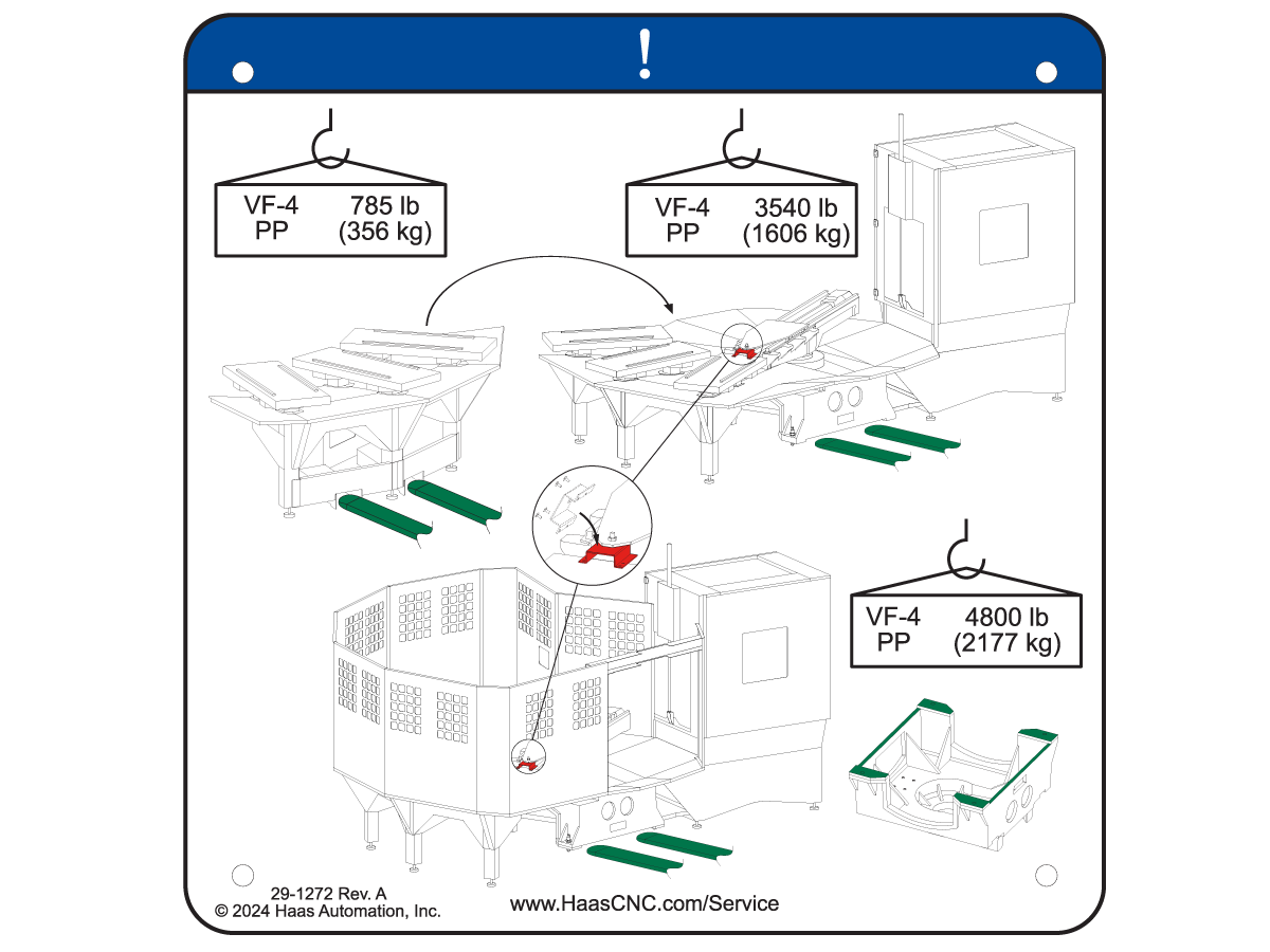

Use a pallet jack or forklift to move the pallet pool close to the machine. When moving the pallet pool into the machine, center the cross bar opening on the pallet pool around the sheet metal bracket that covers the air cylinder on the auto window of the machine.
A decal [1] has been placed on the rear of the pallet pool to indicate where the pallet forks should lift the pallet pool from.
NOTE: Have the pallet jack pick up the pallet pool from the opposite side of where the slide window would be.

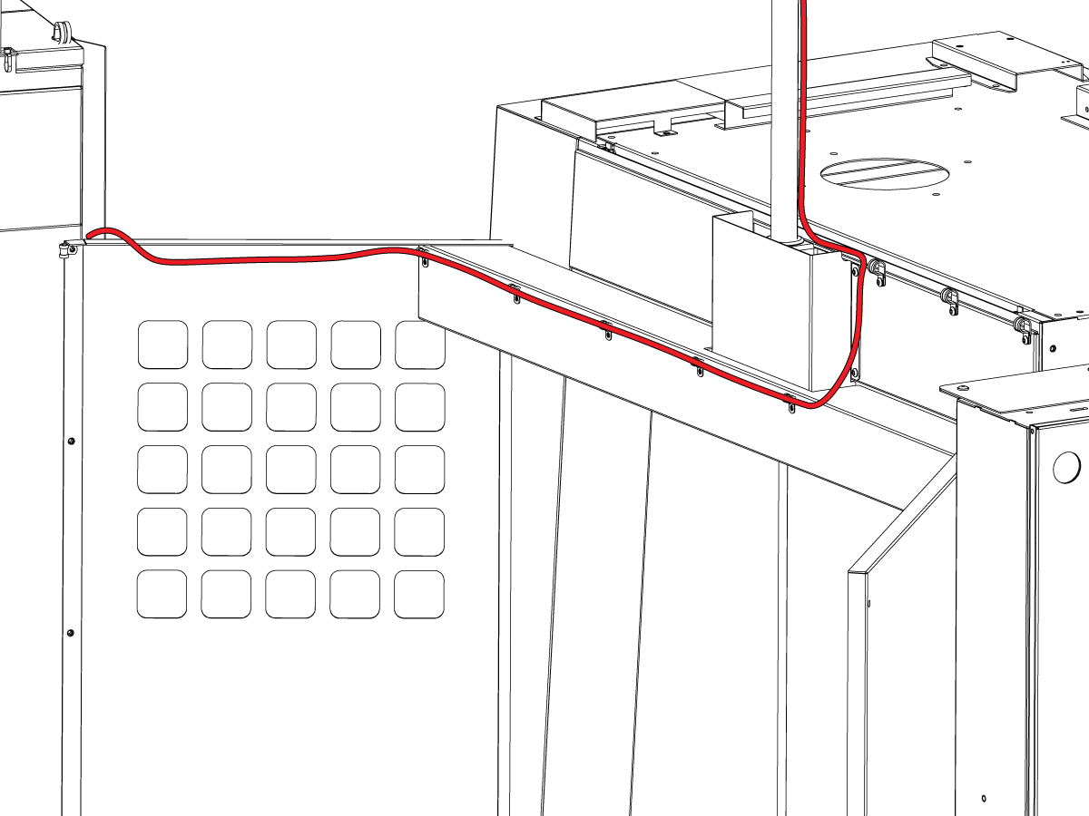

Make sure all the Pallet Pool status bracket connectors are plugged into the correct location.
Attach the cable [1] that runs along the top of the Pallet Pool to the prox sensor connection [2] on the Auto Window and run the cable along the top of the Pallet Pool as shown.

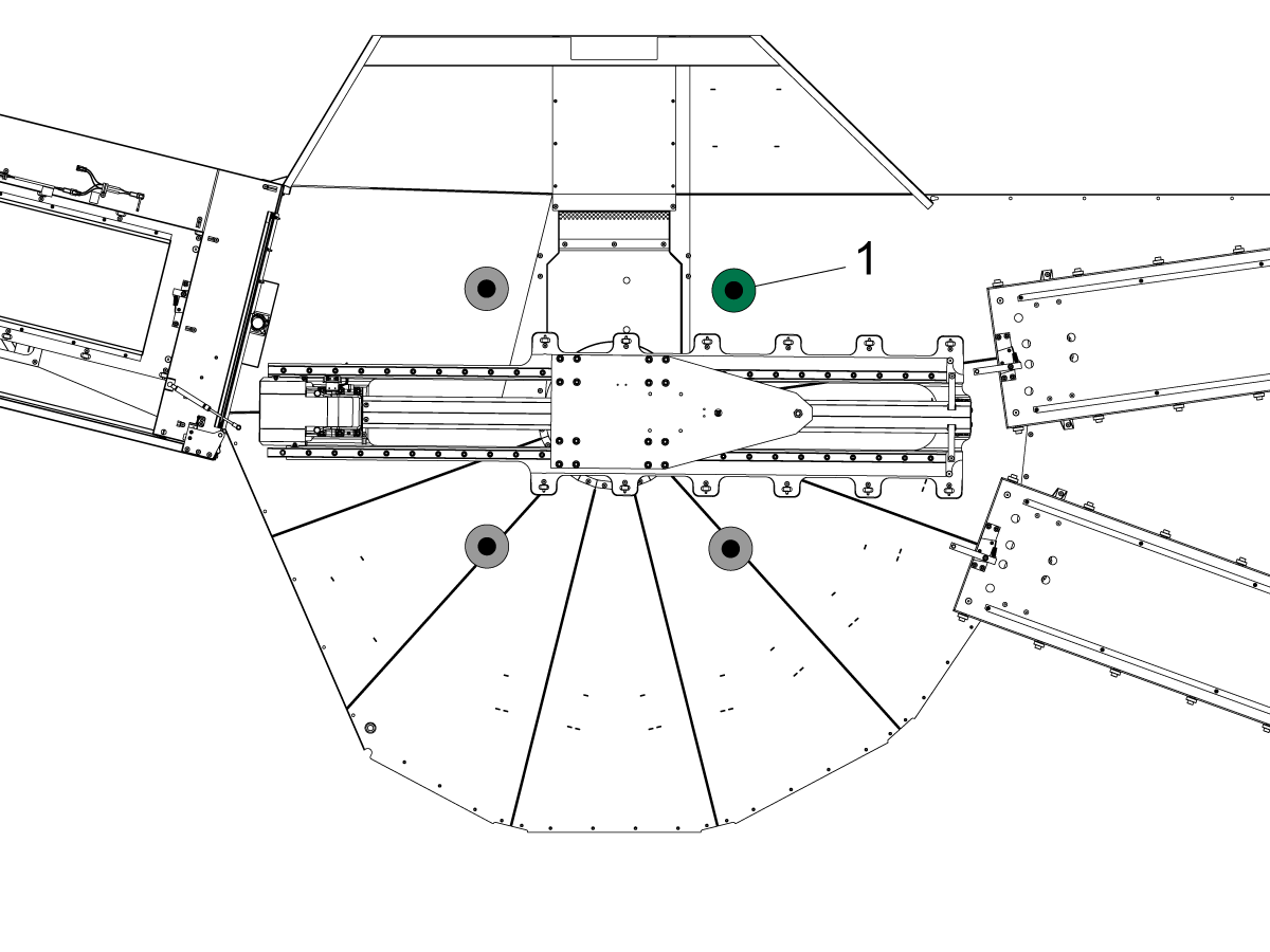

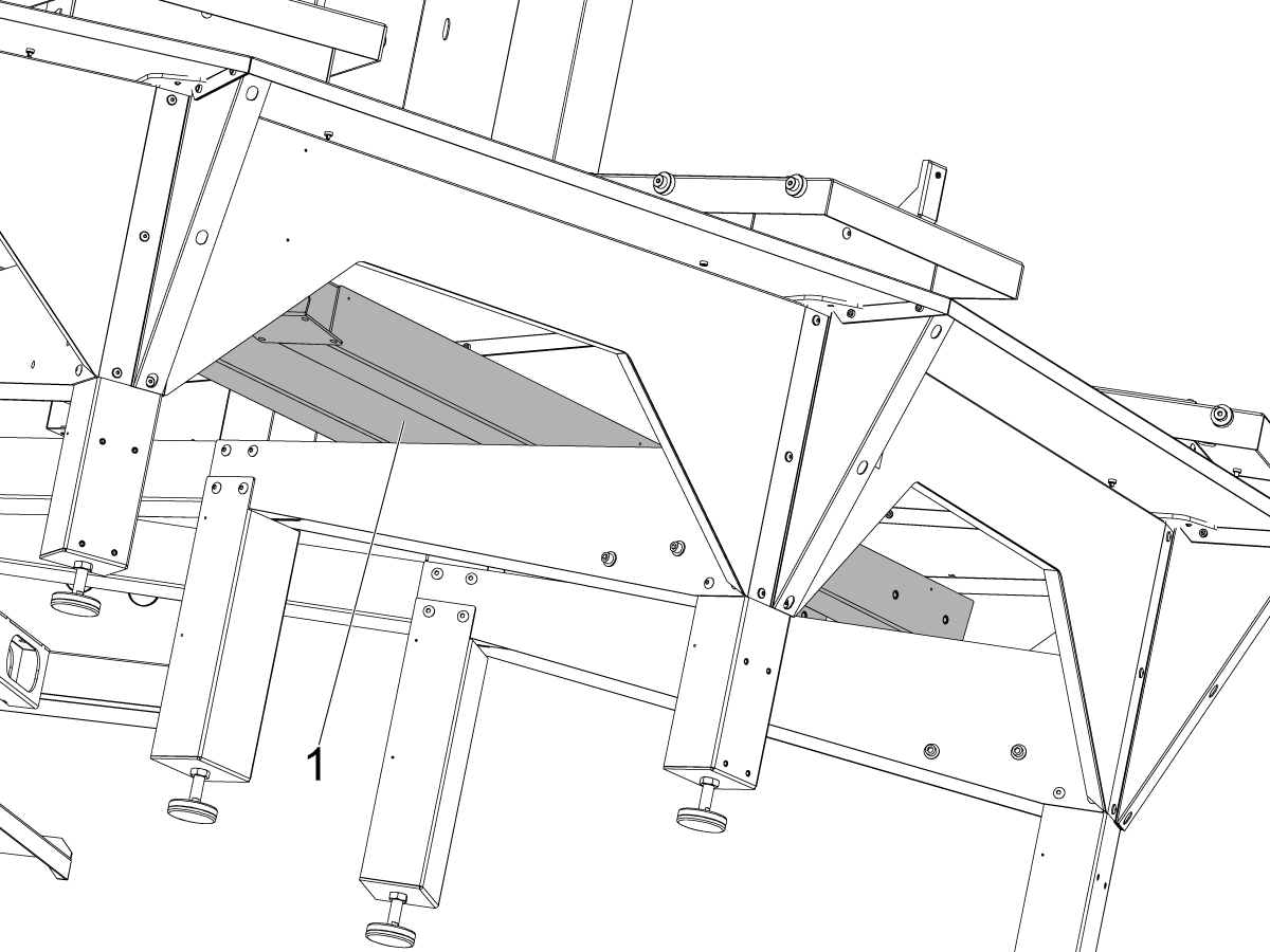

Base Level Pallet Pool
Verify all outer supports feet are NOT touching the floor.
Make sure the pallet pool sit on 3 points, the leveling foot that is not touching the puck is the one closest to the machine control cabinet [1].
The distance from the floor to the bottom on the Pallet Pool base should be approximately 3.5 inches.
Move the saddle to its home position if it is not already, place the bubble level on the trolley plate and rough level with respect to X & Y.
NOTE: Rough level by adjusting the 3 leveling feet without adjusting the 4th in the air.
Once the base is leveled on the 3 points, bring the 4th leveling screw down to touch the pad.

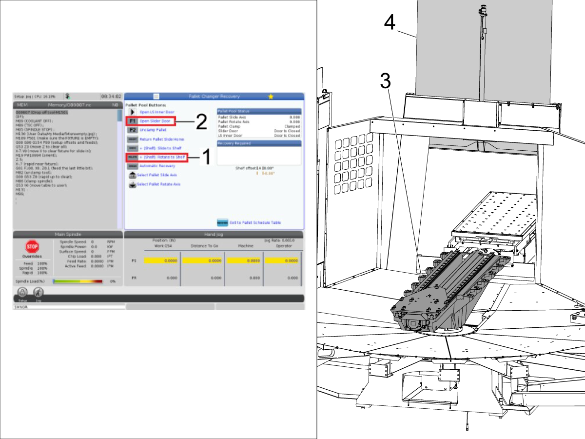

Make sure there are no obstructions inside the machine or inside the pallet pool area. Pull out all the [E-STOPS] and [RESET] the alarms.
Press [ZERO RETURN] and then press [ALL]. The machine will zero return all the axes.
Once all the axis are zero returned press [RECOVER]. A pop up box will appear, select [2] for Pallet Changer Recovery.
Press [H] and then the [DELETE] [1] button. This will rotate the saddle [3] towards station H (as shown in the image).
Press [F1] [2] to open the auto window [4].
Jog the X & Y axes to the positions the values in Factory Settings 1.310 and 2.310, respectively.

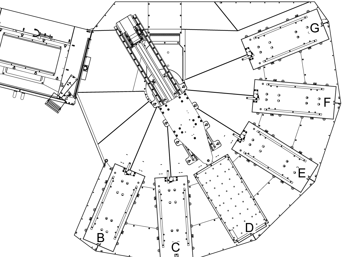

Align Remaining Pallet Shelves
Use the Pallet Changer Recovery page to pick up the pallet and rotate it to shelf G and hand jog the PS axis until the pallet is over the first two rollers of the load station.
The pallet should run smoothly across all of the rollers. If it does not run smoothly, use the outer leveling feet to help adjust and make a smoother shelf loading process.
Use the Pallet Changer Recovery page to send the pallet into shelf G and rotate the trolley plate out so that the pallet is no longer hooked on the trolley plate and verify that the locking mechanism dowel pin latches the pallet correctly.
Note: Refer to the next step for a more in depth explanation for how the locking mechanism dowel pin should latch the pallet correctly.
If the locking mechanism is not latching the pallet properly, adjust the leveling foot to help adjust the locking mechanism.
Repeat this for shelves F and E.
There should have been grease added to the trolley plate at [1] and on all of the dowel pins [2] in the pallet latch mechanisms, if this grease has rubbed off in shipping add more grease to these locations.
It should also be verified that the dowel pin in the pallet station latching mechanism makes at least 0.25 inches [3] of contact with the trolley plate. If this is not the case, adjust the shelf leveling feet to ensure the right amount of contact is being made at each pallet shelf.

Install the tray and air gun [1] and the load station worklights [2] on the pallet pool as shown.
Place the provided totes under the Pallet Pool coolant discharge trays to catch the coolant and chips that drains from the pallets. One tote goes under the load station [3] and the other goes where the machine and pallet pool meet [4].
Empty the totes as needed.

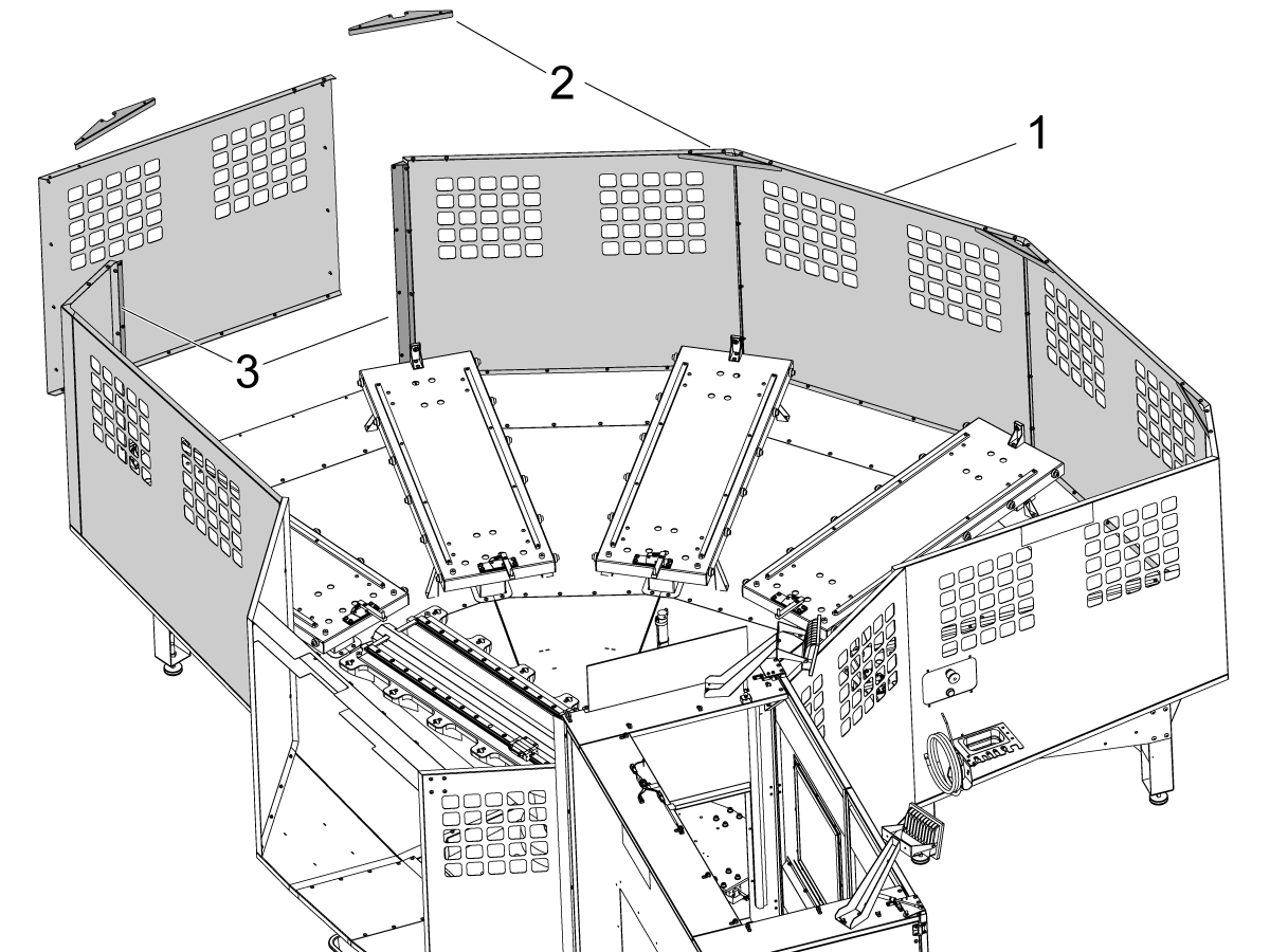

Install the sheet metal walls [1] and crossbar [2] shown. The cut out in the crossbar [2] will be the guide for where to move in the pallet pool to the machine.
 IMPORTANT: Do NOT attach the 3 station module before moving the pallet pool into the machine. Do NOT try to lift the whole pallet pool from the 3 station module, it will not properly hold the pallet pool.

Note: Remove the panel under the electrical cabinet for access to the cables routed from the pallet pool.

Align Pallet Drop Off Station
Insert the Service Key USB and put the machine in Service Mode.
Adjust the height on the pallet pool evenly if needed to be able to slide the pallet from the machine to the saddle.
In the Pallet Changer Recovery page press [F2] to unclamp the pallet [1] in the machine and try to manually slide the pallet [1] onto the pallet saddle [2]. Adjust Factory Setting 2.310 to adjust the y-axis position if necessary.
If more adjustment is needed once Factory Setting 2.130 is adjusted, adjust Factory Setting 2147 to adjust the shelf H PR offset.
Once the pallet saddle [2] and the receiver are properly aligned, manually jog the PR axis 4 degrees off and jog the PS and PR axes to manually hook the pallet.
Once the pallet is hooked and fully extended onto the receiver, set parameter 2137 [:] SHELF H SLIDE OFFSET.
In the Pallet Changer Recovery page while the pallet in the machine is hooked, press [INSERT] to return the pallet slide to home.
Once the pallet is moved off of the receiver [1], remove the nylon washers [2] that are on the (4) surrounding pins.

Attach The 3 Station Module
Remove the shipping brackets [1] on the side of the 3 station module.
Use a pallet jack to move in the 3 station module [1] to the main pallet pool assembly.
Make sure to lift the module [1] higher than the main pallet pool for easier movement into the main assembly.
With the pallet jack still lifting the module while it is fully moved into the main assembly, install the top outer corner bolt to the bulkhead under station B as shown in [1]. Install the remaining 3 bolts under that bulkhead and verify all bolts are hand tight.
Lower the pallet jack so that the module will line up the bulkhead underneath station C [2] and install the bolts at the bulkhead, verify they are hand tight before moving to the next bulkhead.
Lower the pallet jack again so that the module will line up the bulkhead underneath station D [3] and install the bolts at the bulkhead, verify they are hand tight.
Note: An alignment rod can be used in the middle hole of the bulkheads to help line up the bulkhead holes when installing the bolts.
If it is not already, completely lower the pallet jack and remove it from the module.
Remove the module's lifting mechanism [1] and push down the brackets [2] underneath station E.
At this point, the holes on the main pallet pool assembly and the 3 station module should line up, if they do not adjust the module legs until the holes are lined up.
Once the holes are lined up install the sheet metal bolts [1] underneath station E. Also make sure to get the bolts underneath station E shown with [3].
Install the legs [2] for station E.
6
Install the rest of of the bolts along where the module meets the main pallet pool [1].
Once all the bolts are installed and the module is fully attached to the main assembly go back underneath and completely tighten the bulkhead bolts.
If the pallet pool has any feet remaining in the air, go ahead and touch them down to the ground. Do not put any weight on them at this time, they will need weight when adjusting the shelves next.
Align Pallet Shelves For Stations B, C, D, E, F, and G
Use the Pallet Changer Recovery page to pick up the pallet and rotate it to shelf F and hand jog the PS axis until the pallet is over the first two rollers of the load station.
Use the Pallet Changer Recovery page to send the pallet into shelf D and rotate the trolley plate out so that the pallet is no longer hooked on the trolley plate and verify that the locking mechanism dowel pin latches the pallet correctly.
Repeat this for shelves G, E, D, C, and B. in that order.

Attach Remaining Sheet Metal Walls
Install the sheet metal wall closest to the load station use the four (4) nuts [1] and two (2) bolts [2] on the vertical edge. Use the five (5) bolts to secure it underneath.
Install the next sheet metal wall using all bolts in the same locations as the previous wall and install the E-Stop junction box as shown.
Install the remaining sheet metal walls [1] and the cross bars [2] in between.

Route the pallet pool cables [2] as shown in the illustration. The pallet pool work lights are routed among these cables.
Connect the PR motor encoder cable to Maincon PCB channel 15
Connect the PS motor encoder cable to Maincon PCB channel 16.
Connect the PR motor power cable to the amplifier labeled PR. Install the ferrite filter bead on the motor power cable.
Connect the PS motor power cable to the amplifier labeled PS. Install the ferrite filter bead on the motor power cable.
The pallet pool work lights are connected to the LVPS on the bottom left corner of the cabinet to the proper terminals labeled on the cable.

The Pallet Changer Recovery screen shows the Pallet Pool Status. Make sure the Pallet Lifter is Down [1]. If not press [ALTER] to bring the Pallet Lifter down.
Press [G] and then the [DELETE] button. This will rotate the pallet lifter towards station G.

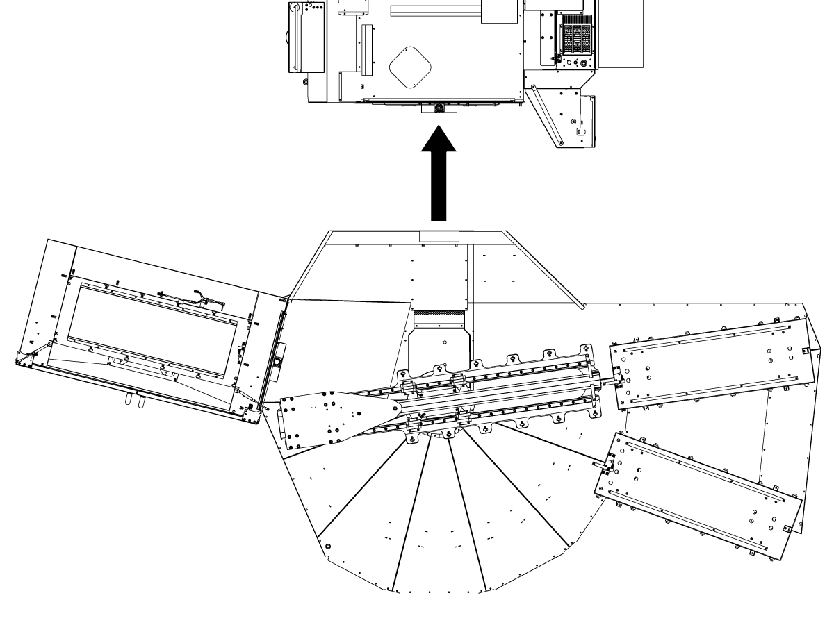

The VF-4 must be level and anchored before the Pallet Pool can be installed. Refer to the VMC-Installation procedure.
Install the two side drip pans [1] that lead to the VF-4 auto-window as shown followed by the middle drip pan [2].
Install the pallet pool drip pan support [2] to help support the drip pan [1] . Use the provided hardware [3] to attach the support to the cast base and the drip pan.
A decal has been placed on the rear of the pallet pool to indicate where the pallet forks should lift the pallet pool from.
Remove the shipping bracket [1] from the Pallet Pool by removing the hardware and removing the bracket from the Pallet Pool's saddle.
Remove the Trolley Plate shipping bracket [1] by removing the two nuts and bolts.
Remove the latch covers [1] from the pallet pool by loosening the bolts and sliding off the latch cover.
Attach Load Station
Use a pallet jack or fork lift to lift the load station into position.
Insert the provided the 8 bolts [1] to attach the load station to the pallet pool support arms.
Note: Use a screwdriver or something similar to help align the load station bolt hole before putting in the bolts.
Attach the pallet pool drip pan to the load station using the  1/4-20 button head bolts [1].
Remove the cover [1] and its hardware [2] to expose the air cylinder [4] of the automatic window on the load station and raise the air cylinder [4] so that the brackets [3] and air cylinder are attached as shown. Once the air cylinder is raised, reattach the cover [1].
Repeat this process for the air cylinder of the Auto Window on the VF-4. The gray and yellow air line tubing coming from the lube panel will need to be connected to the Auto Window air cylinder, the ports on the air cylinder will have gray and yellow zip ties to show where each tubing connects.
Note: Machines built June 2024 and later will now be equipped with the new clamp sensors on the Auto Windows, for proper sensor adjustment/alignment refer to the Clamp Sensor Alignment section of the VMC - Auto Window - Installation procedure.
The load station door gas springs are in a zip lock bag zip tied to the load station doors.
Remove the retaining rings [2] from both sides of the gas spring [1].
Open the door and place the gas spring [1] on the ball studs as shown.
Install the retaining rings [2] on each side of the gas spring.
Repeat this step for the second load station door.

Route the cables from the load station down the side of the load station under the pallet pool drip pan down to the Electrical connection bracket.

Attach load station cable cover [1] to the side of the load station to cover the routed cables.
Note: Do not pinch the cables when putting on the cover.
Remove the module's lifting mechanism [1] and push down the brackets [2] underneath station E. Screw down those plates with the screws provided.
6
If the pallet pool has any feet remaining in the air, go ahead and touch them down to the ground. Do not put any weight on them at this time, they will need weight when adjusting the shelves.

Attach Inner Leveling Feet
Take the support leg [1] and place it under the support arm. Use the provided hardware to attach the support leg to the support arm. Repeat this for all 5 support arms.
Bring down the support feet and have them touch the ground. Do not put any weight on them at this time, they may need some adjustment when adjusting the shelves.

Press [G] and then the [DELETE] [1] button. This will rotate the saddle [3] towards station G (as shown in the image).

Align Pallet Shelves For Stations B, C, D, E, & F
Use the Pallet Changer Recovery page to pick up the pallet and rotate it to shelf E and hand jog the PS axis until the pallet is over the first two rollers of the load station.
The pallet should run smoothly across all of the rollers. If it does not run smoothly, use the outer and inner leveling feet to help adjust and make a smoother shelf loading process.
Use the Pallet Changer Recovery page to send the pallet into shelf E and rotate the trolley plate out so that the pallet is no longer hooked on the trolley plate and verify that the locking mechanism dowel pin latches the pallet correctly.
If the locking mechanism is not latching the pallet properly, adjust the leveling feet to help adjust the locking mechanism.
Repeat this for shelves  F, D, C, & B in that order.
This can be an iterative process and it may be required to adjust the leveling feet back and forth when adjusting the shelves.
Note: We recommend using a roughly 6ft long level to align the station by putting the level on the rollers of the saddle and adjusting the station till the station rollers touch the level.
Install the remaining sheet metal walls [1] and the cross bars [2] in between. Install the two removable wall rails [3] before installing the final piece of the wall.
