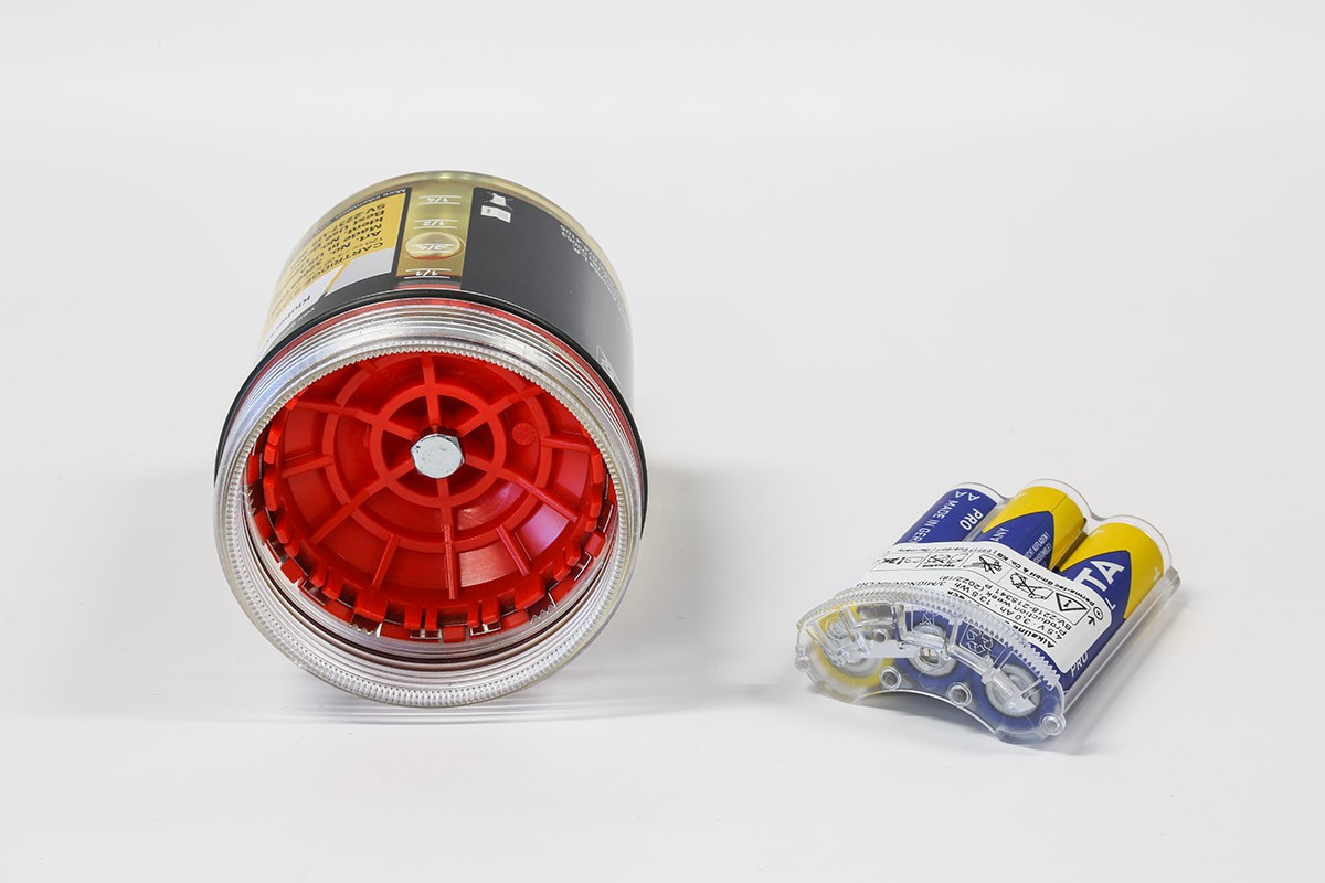

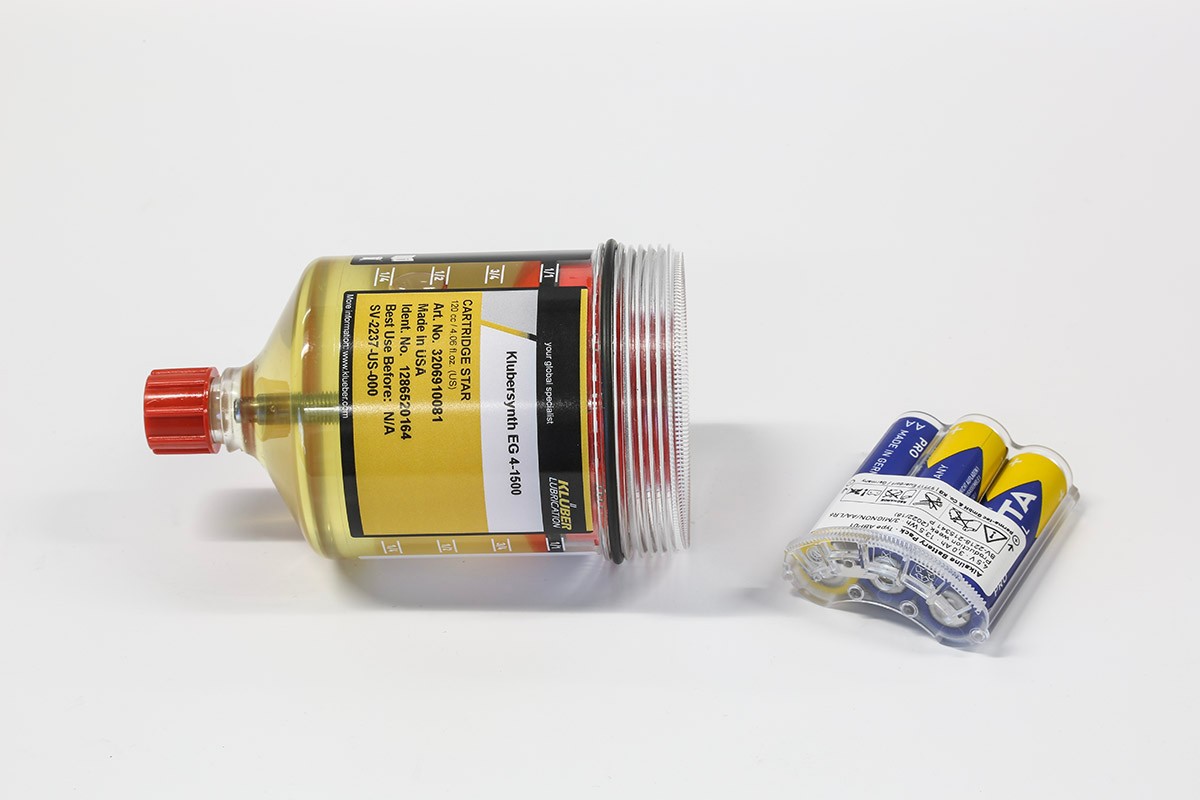

Use this battery-powered pump on Office Mills and Office Lathes that have been converted to the latest axis autolube system, and were built before 12/2008. This battery-powered pump automatically lubricates the ball screws and linear guides.
NOTE: The refill cartridge may be oil or grease.
