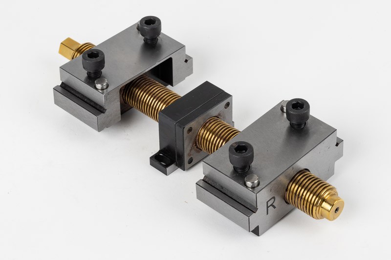

5"(130mm) Self-Centering Vise Replacement Screw Assembly

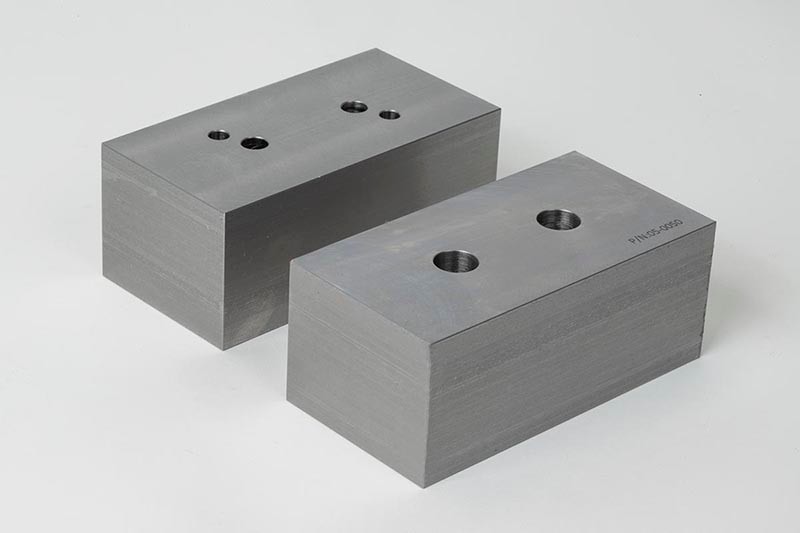

Soft Steel 5" (130mm) x 2-1/2" (64mm) Machinable Vise Jaws

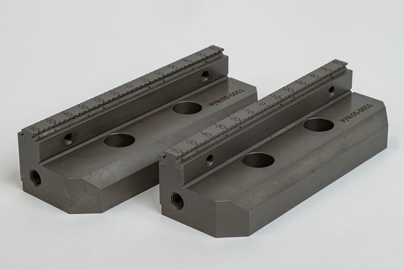

Hard Steel 5" (130mm) Non-Machinable Serrated Vise Jaws

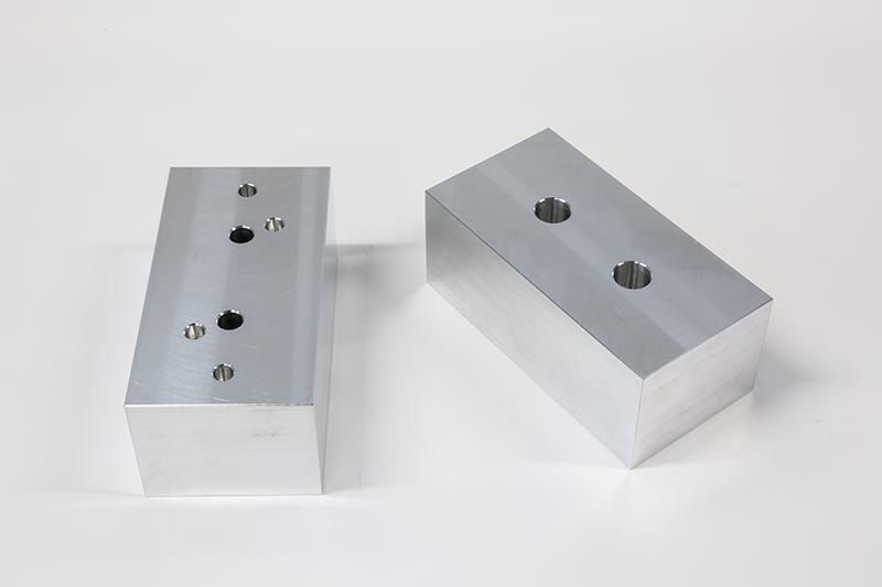

Aluminum 5" (130mm) x 2-1/2" (64mm) Machinable Vise Jaws

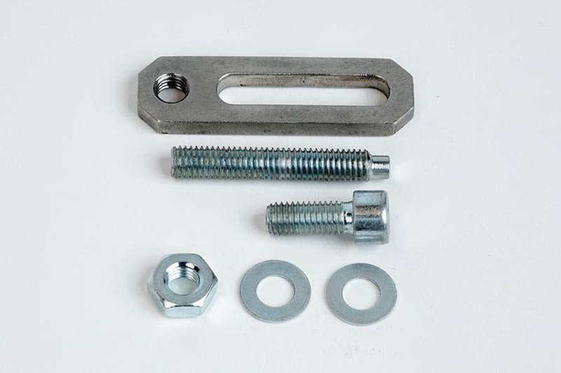

58-Piece, 16mm T-Slot Hardware/Toe Clamp Set, 1/2"-13 Thread

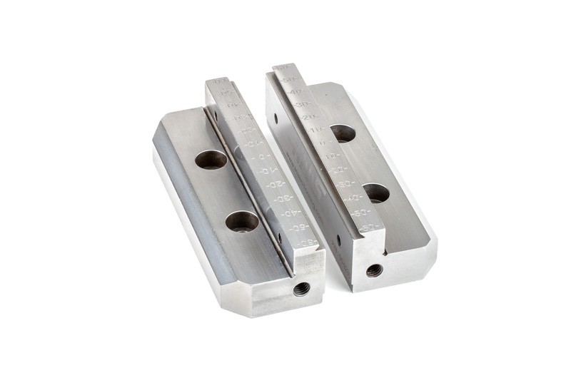

Hard Steel 5" (130mm) Non-Machinable Dovetail Self-Centering Vise Jaws
