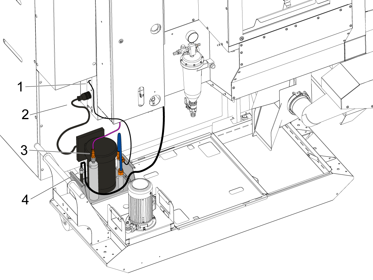

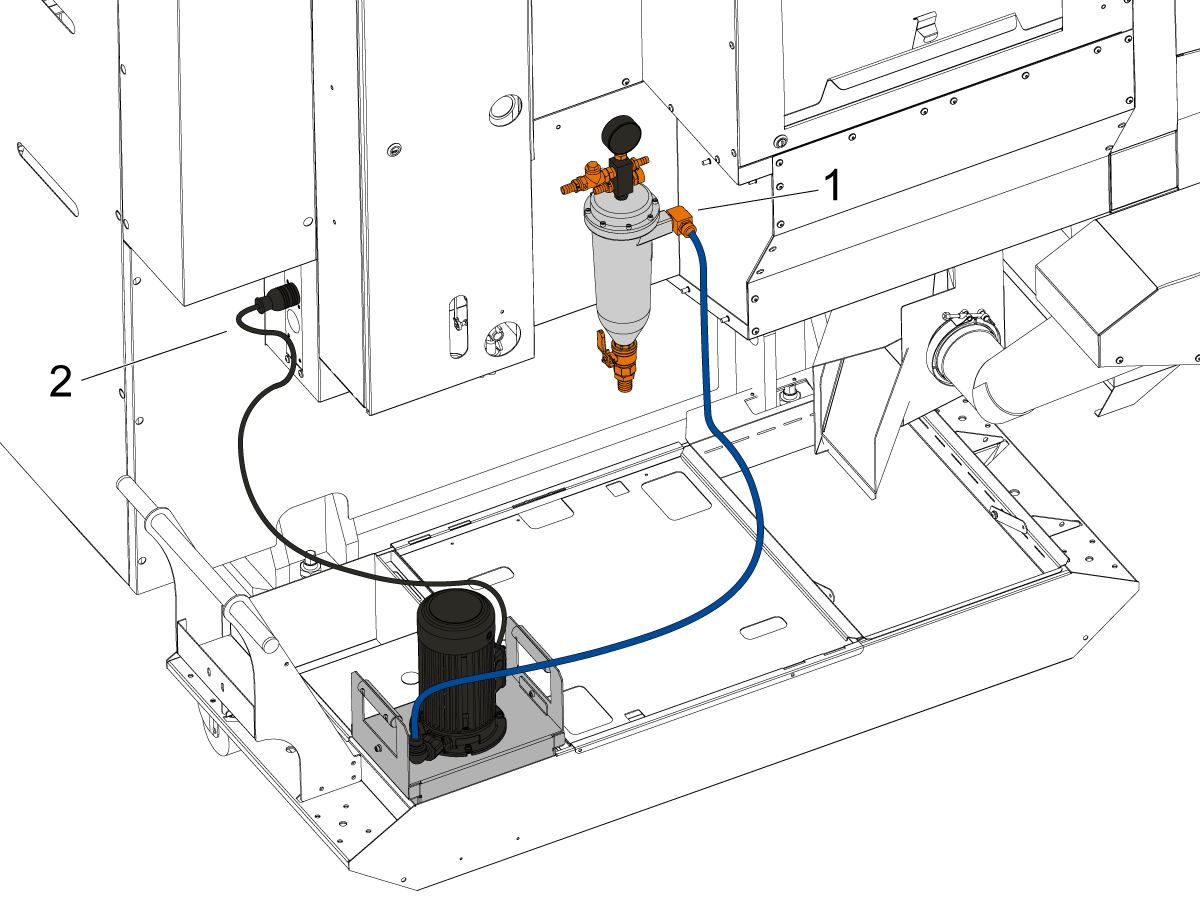

Coolant Tank Installation
Power off the machine.
Install coolant tank handle [1], tank lids [2], and chip tray [3].
Position coolant tank under the left side of machine (when viewing from the front). Ensure that the chip tray [3] is directly under the machine's drain slots, to ensure that coolant flows into the tank.
Insert the coolant pump assembly in the position shown. Connect the coolant hose to the coolant filter [1].
Connect the coolant pump power cable to the socket labeled Low Pressure Coolant.
Fill the coolant tank with coolant. Install the coolant float sensor into the coolant tank. Refer to Coolant Float Sensor - NGC - Installation or Coolant Float Sensor - CHC - Installation for more information.
TSC Option:
Insert the TSC pump assembly into the coolant tank in the position shown.
Connect the TSC pressure sensor [1] into the socket labeled Coolant Filter Sensor. Connect the TSC power cable [2] into the socket labeled High Pressure Coolant.
Connect the purple air hose from the TSC pump assembly's cylinder [3] and into the lube cabinet.
Connect the coolant hose [4]. Ensure that the connection between the coolant hose and TSC pump assembly is firmly torqued.
Note: Improper tightening of the TSC coolant hose will cause leaks.
