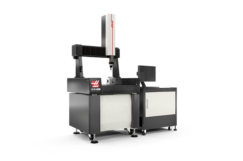

    Haas Automation’s first coordinate measuring machine – the HMM430 – brings professional-grade inspection to your shop. This machine is perfect for small- to medium-sized shops looking for their first entry into the world of CMM inspections and ownership. Everything you need to get started is included.
    Streamline your quality control by reducing the amount of time spent performing inspections with conventional metrology tools. Compared to similarly sized options from the big names in the CMM world, you’ll find the HMM430 offers competitive accuracy at an unbeatable Haas price.
    Product Highlights:
    ____________________________
    • Renishaw controller &  linear scales
    • TouchDMIS measuring software
    • Includes Computer with Non-Touch Monitor, Keyboard, Mouse, and Speaker
    • Microsoft Windows Operating System, Windows 11
    • Linear guide bearings
    • Program inspection directly from 3D models
    • Full CNC inspections with CAD models
    • Quick measurements without CAD models using joystick to hand-jog probe
    • 12-month parts warranty from ship date, supported by your local Haas Factory Outlet; on-site installation, training, service labor, and travel charges will apply
    Product Specifications:
    • Linear scale resolution: 0.001mm
    • Max volume: 400 x 430 x 350mm (X,Y,Z)
    • Probe head: Renishaw MH20i
    • Probe body: Renishaw TP20 w/ standard force module
    • Max part weight: 120 kg

    Technical Specifications - HMM430
    Control Type   Direct CNC Controlled (DCC)
    Control Package Details: Probe Head Renishaw MH20i
    Probe body Renishaw TP20 w/ Standard Force Module
    Joystick Renishaw MCU-lite 2
    Controller Renishaw UCC T3-2
    Servo Amplifier Renishaw SPA3-2
    Included Probe Tips   ø1 x 20mm
      ø2 x 20mm
      ø3 x 20mm
      ø4 x 20mm
    Other Included Components   Aluminum practice part
      Calibration Sphere
      Uninterruptible Power Supply
    Travel / Measuring Volume (XYZ) X 15.7" \ 400mm
    Y 16.9" \ 430mm
    Z 13.7" \ 350mm
    Granite Bed Accessible Area 23.2" x 33.5" \ 590 x 850mm
    Flatness 0.0002" \ 0.005mm
    Linear Scales:  Manuf. Renishaw
    Resolution 0.00004" \ 0.001mm
    Accuracy (Evaluated at 20±1 °C, 55-65% Humidity) U1 (Linear) 2 + L/200µm (about 2 - 6 µm \ 0.00008" - 0.00024")
    U3 (Volumetric) 4 + L/100µm (about 4 - 11 µm \ 0.00016" - 0.00043")
    Bearing Type   Linear Guide Bearing, Hardened steel
    Max part weight   120kg
    Measuring Software   TouchDMIS
    PC Operating System   Windows 11
    Included Computer Peripherals
    Power Requirements
    Machine Dimensions (including base)   36.2" x 38.2" x 82.7" \ 920 x 970 x 2100 mm
    Computer Cart Dimensions   23.6" x 29.5" x 30.8" \ 600 x 750 x 780mm
    Total Footprint (Machine + Cart)   83.5" x 38.2" \ 2120mm x 970mm
    Machine Weight   1279lbs / 580kg
    Computer Cart Weight   177lbs / 80kg
    Shipping Dimensions Length  107.5"
    Width 44.9"
    Height 69.3"
