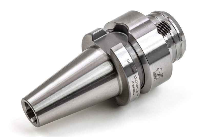

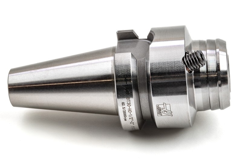

BT30 1/2" Hydraulic Chuck x 2" Gage Length, TSC
Part #: 04-1449
BT30 HYDRAULIC CHUCK, 1/2"-2"
Price: 278.95 ( / unit)
195.97
This BT30 hydraulic milling chuck has a 0.5 in \ 1/2" bore diameter and a 2" gage length. The chuck accepts precision straight-shank collets (optional) to reduce the bore and hold smaller diameter tools. The hydraulic fluid within the chuck compresses to provide equal pressure around the cutting tool shank, providing high grip strength, low runout, and excellent damping properties. It is through-tool coolant (TSC) capable, with a M12x1.75 pull stud/retention knob thread.
  • Technical Documents
NOTE: Hydraulic holders that exceed 2.5" (63mm) [ØBD] Body Diameter need to be defined as a "Large Tool" in the Haas Control depending on your tool changer.
Item Hydraulic Chuck
Taper BT30
[ØD] Bore Diameter 0.5 in \ 1/2"
[ØBD] Body Diameter 1.811 in
[GL] Gage Length 2.0 in
[BL] Body Length 0.614 in
[LSCX] Maximum Clamping Length 1.811 in
[OAL] Overall Length 3.906 in
Concentricity 0.00012”
Balanced to RPM 25000
Retention Knob Thread Size M12X1.75
Through Tool Coolant Yes
Screw TS4
Spindle Drive Slots Yes
Weight 1.3 lbs \ 0.6 kg
