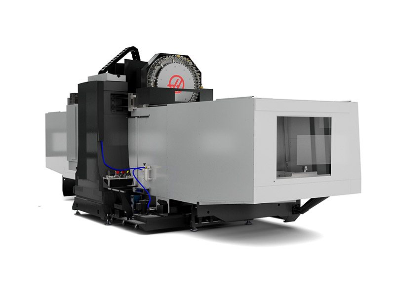

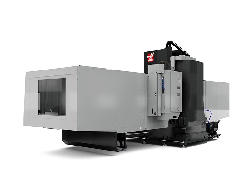

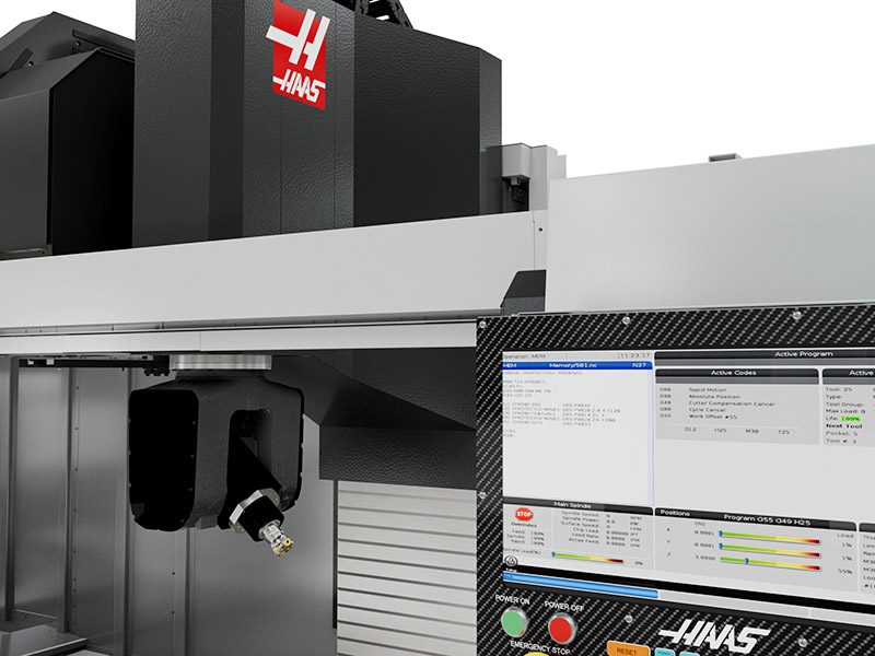

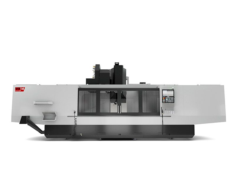

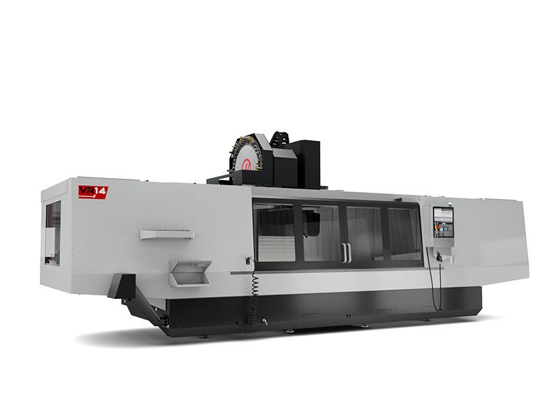

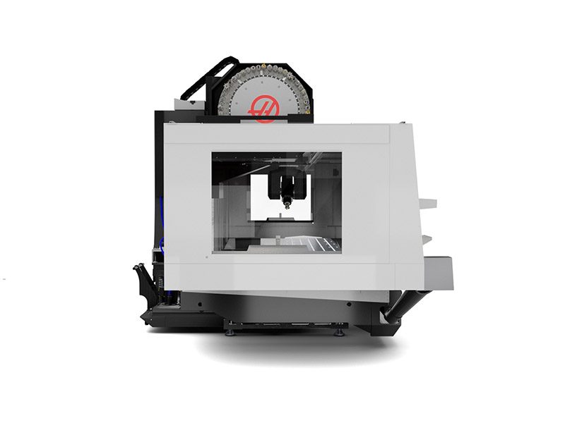

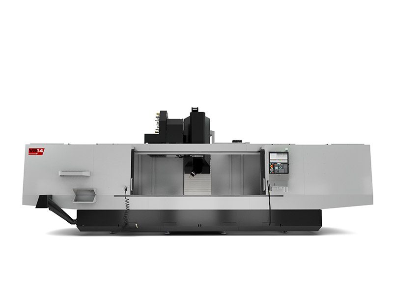

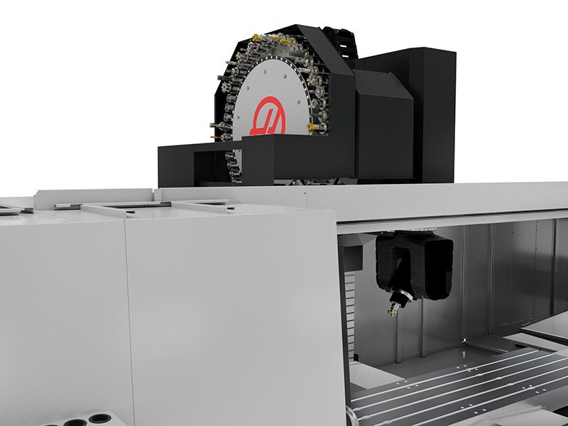

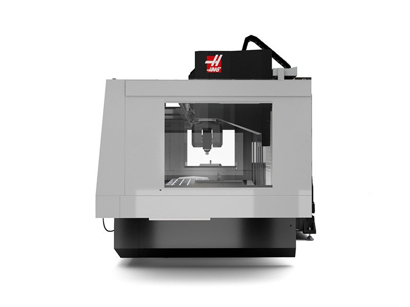

VR-14
    CNY ONLY
5-Axis Vertical Machining Center; 150" x 40" x 42", 2-axis head
  • Dual-axis spindle head
  • ±245° of C-axis rotation, ±120° of B-axis tilt
  • 5-axis simultaneous machining
  • Powerful axis brakes for rigid 3+2 machining
  • HSK-A63 taper
  • Includes Tool Center Point Control
Haas VR Series VMCs are the perfect solutions when your 5-axis parts are too large to rotate using traditional rotary tables and trunnions. Each VR Series machine features a large T-slot table that easily supports large workpieces and fixtures, and a powerful 2-axis gimbaled spindle head that provides access to nearly any angle on the part for complex shapes, undercuts, and 5-side machining.
See Available Stock
Current Lead Time
  • HSK-A63 Taper
  • 5 Axis
  • 20k RPM
  • 50+1 Tool Capacity
