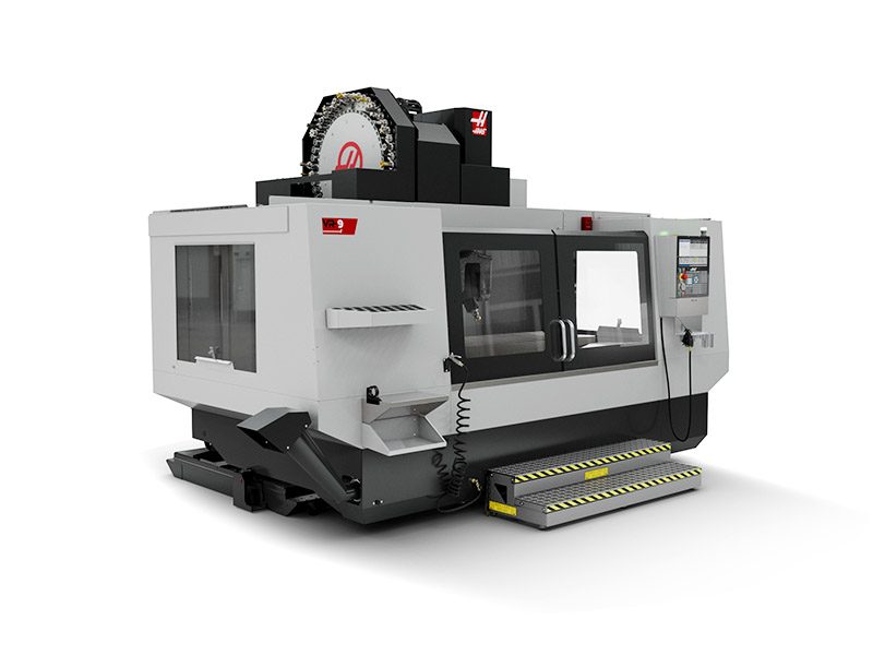

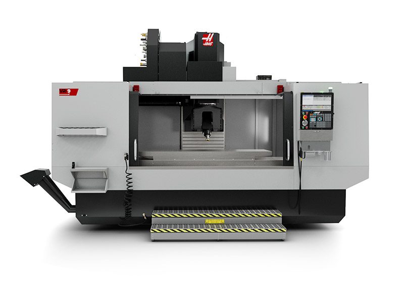

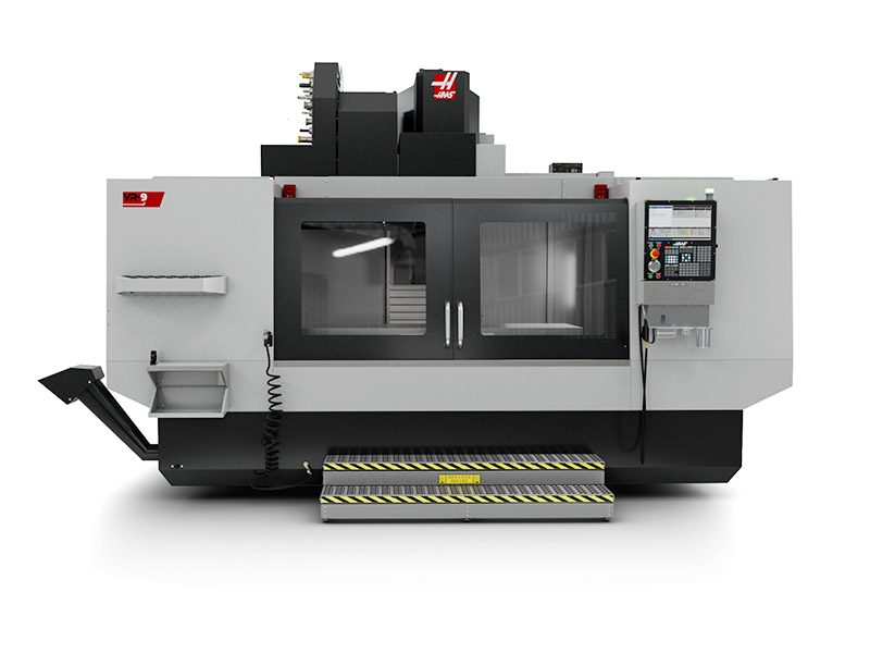

VR-9
  1. Vertical Mills
  2. VR Series
  3. VR-9
VR-9
    CNY ONLY
5-Axis Vertical Machining Center; 84" x 40" x 42", 2-axis head
Haas VR Series VMCs are the perfect solutions when your 5-axis parts are too large to rotate using traditional rotary tables and trunnions. Each VR Series machine features a large T-slot table that easily supports large workpieces and fixtures, and a powerful 2-axis gimbaled spindle head that provides access to nearly any angle on the part for complex shapes, undercuts, and 5-side machining.
  • Dual-axis spindle head provides ±245 degrees of C-axis rotation and ±120 degrees of B-axis tilt
  • 5-axis simultaneous machining
  • Powerful brakes on the B and C axes for rigid 3+2 machining
  • HSK-A63 taper
  • Includes Tool Center Point Control
