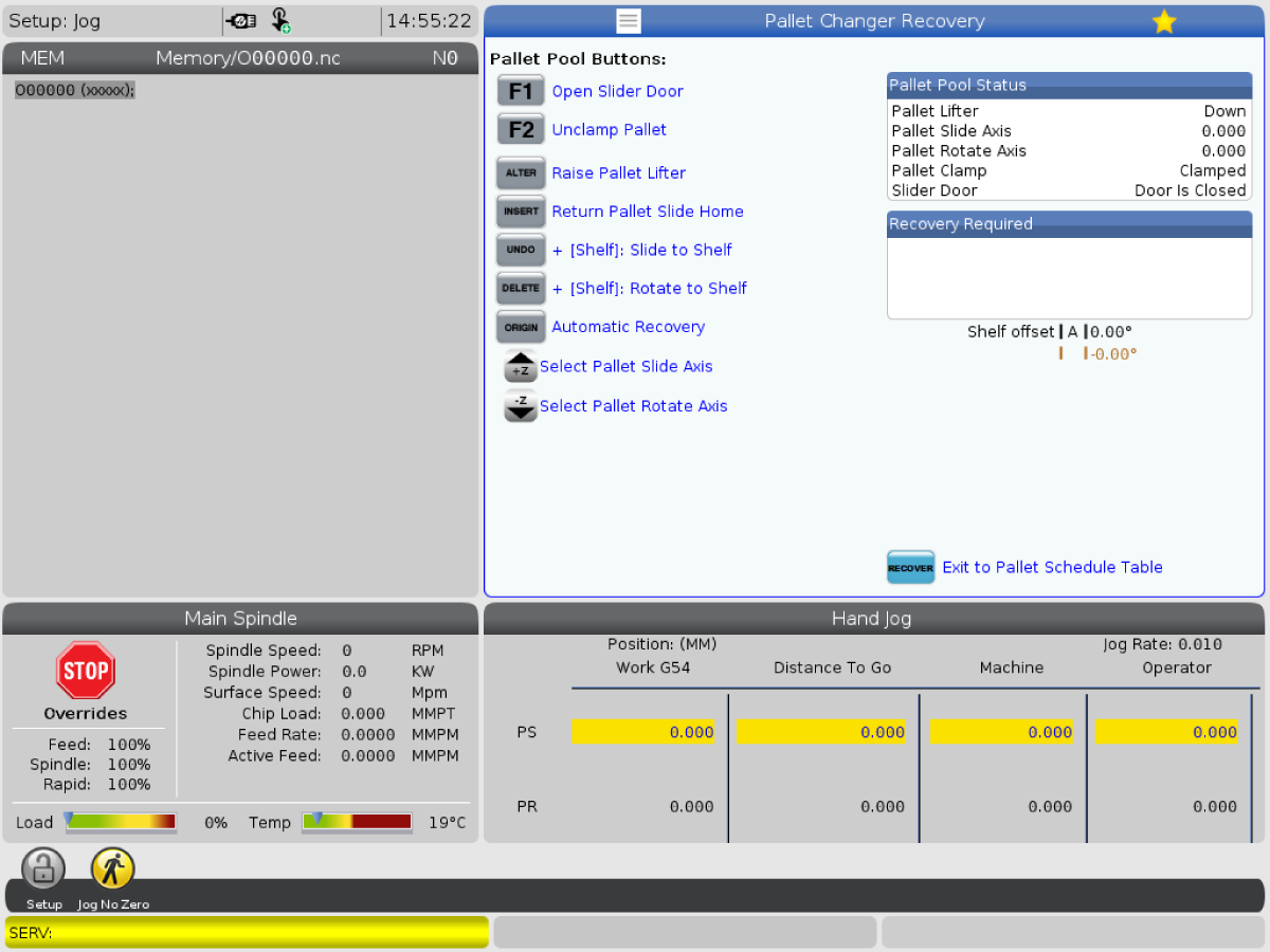

UMC/EC-PP Fine Adjusting Drop Off and Pick Up
If this machine was built before 05/2025, download the latest configuration file for your machine from HBC and update the machine's configuration file.
Note: If the individual shelf parameters were adjusted and a patch file was not created, the configuration update will set the changed values back to the factory settings.
Note: When performing this procedure, change the dimensioning setting to MM using Setting 9.
Use the USB Service key to go into Service Mode.
Enter pallet recovery page and press the letter of the station that needs adjustment then [DELETE] to rotate the pallet pool to the selected station.
Press [-Z] or  [+Z] to select the Pallet Rotate Axis or Pallet Slide Axis
Use these axes to jog the ram into position to allow for smooth drop off and pick up from the station.
Test the position by pressing [ALTER] to raise and lower the ram.
Take note of the  Pallet Rotate Axis position and the Pallet Slide Axis position in the Pallet Pool Status box.
Once a desired position is found, exit recovery by pressing [RECOVERY].
Press [DIAGNOSTIC] Go to the PARAMETERS> Factory setting tab.
Press [EMERGENCY STOP].
Type in SLIDE and press [F1].
Find the parameter that coincides with the station you are trying to adjust.
Note:The parameter number for Slide Offset will be between 2130 and 2139, 2306 and 2313, or 2372 and 2379.
Once the parameter is found, type in the noted value for the PS axis and set the new slide offset for the desired station letter using that value.
Type in ROTARY and press [F1].
Note: The parameter number will be between 2140 and 2149, 2314 and 2321, or 2380 and 2387.
Once the parameter is found, type in the noted value from the PR axis and set the new rotary offset for the desired station letter using that value.
Go back to the recovery page and move the pallet pool into a state where you will be able to zero return the PS and PR axes.
Zero Return the PS and PR axis starting with PS.
Once that has been done, test the pick up and drop off of the station.
