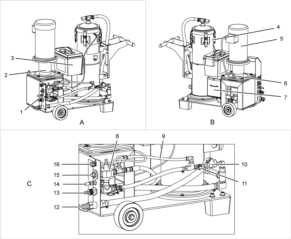

[A] - Front View (Enclosure Panel Removed)
[B] - Back View
[C] - Plumbing Detail- Connector Panel
  1. Connector Panel
  2. 1000 PSI Pump Assembly
  3. Spare Auxiliary Filter Bag box
  4. Auxiliary Filter Tank
  5. Pump Motor
  6. Pump Oil Reservoir
  7. Electrical Junction Box
  8. Regulator Valve
  9. Auto Prime Line
  10. Check Valve
  11. Filter Drain Valve
  12. Supply In
  13. Filter Drain
  14. Prime Line
  15. 1000 PSI Out
  16. Pump Control Cable

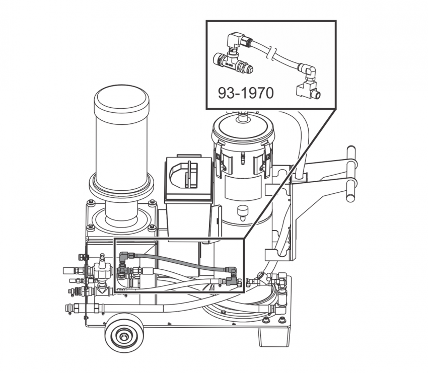

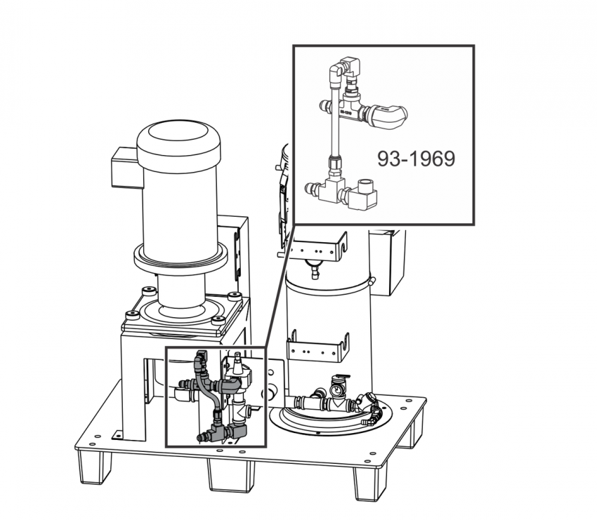

  • 93-1969; Auto Prime Bypass kit for stand style HPC-1000/TSC-1000 coolant assembly.
  • 93-1970; Auto Prime Bypass kit for cart style HPC-1000/TSC-1000 coolant assembly (started shipping in 2011).

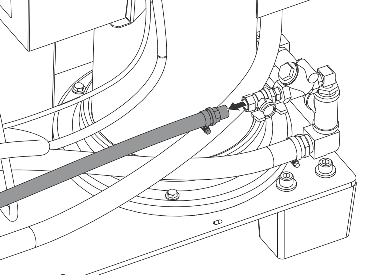

Auto-Prime Bypass Line - Installation - HPC-1000/TSC-1000 - 93-1969 Stand Style

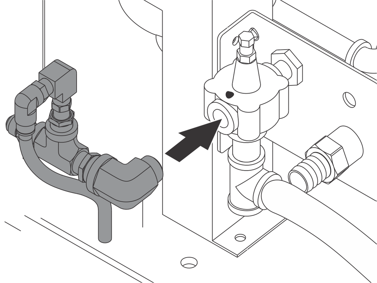

Disconnect the TSC-1000/HPC-1000 pump power cable from the power source.

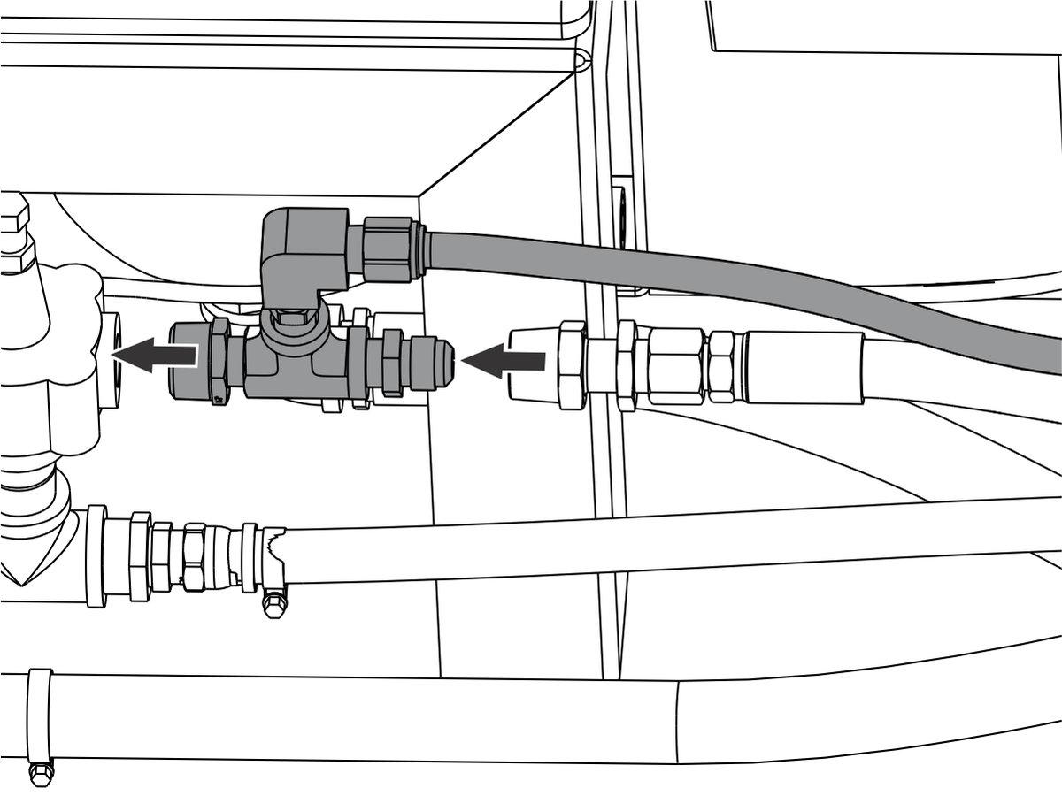

Find and mark the regulator valve output hose.
Disconnect the hoses and 90° fittings.
Connect the auto prime bypass assembly to the regulator valve output port as shown.
Connect the auto prime bypass assembly to the regulator valve bottom port as shown.
Connect the hoses you disconnected in step 3. Match the marked hose with the regulator valve output connection.
Command an M88 or press the [AUX CLNT] button to test the system for proper output.

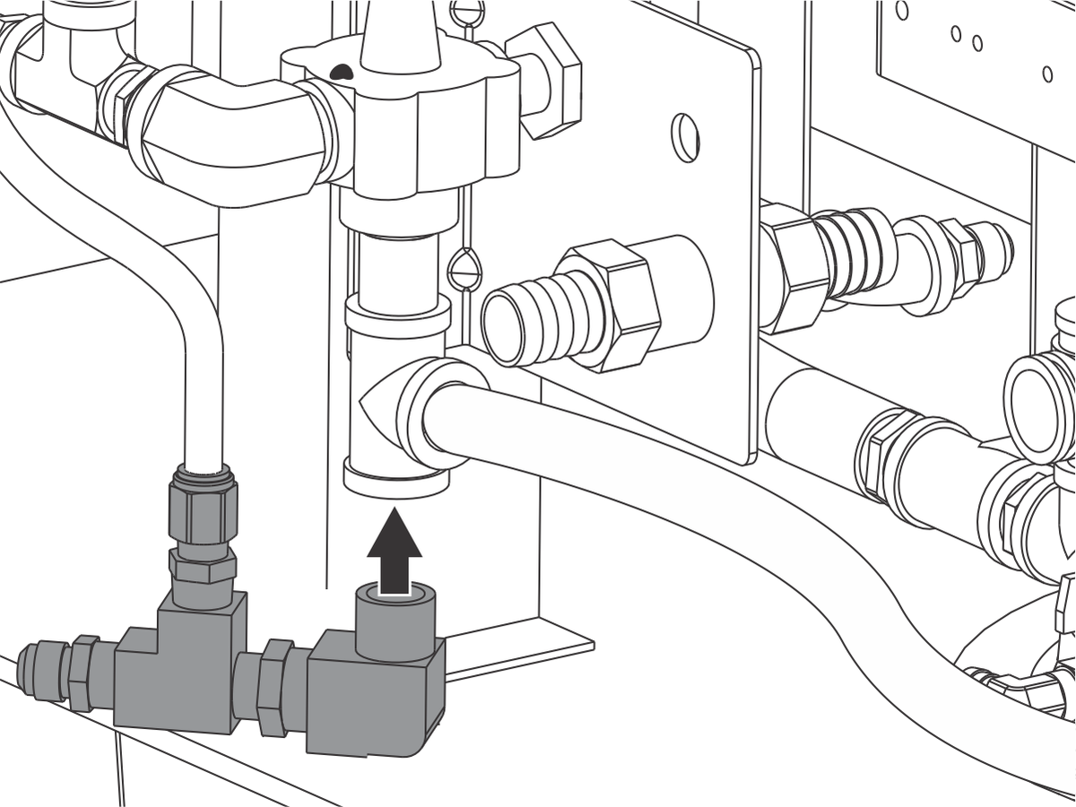

Auto-Prime Bypass Line - Installation - HPC-1000/TSC-1000 - 93-1970 Cart Style
Remove the TSC/HPC Front Enclosure Panel.

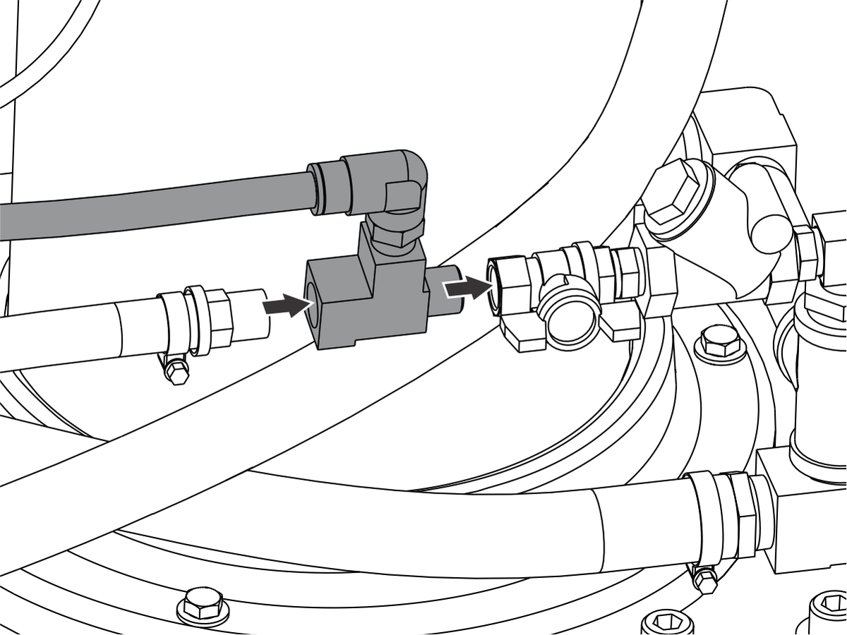

Disconnect the filter drain hose at the ball valve end.
Install the NPT fitting end of the auto prime bypass assembly between the ball valve and the filter drain hose.
Disconnect the 1000 psi out hose from the regulator valve.
Install the tee fitting end of the auto prime bypass assembly between the regulator valve and the 1000 psi out hose.
