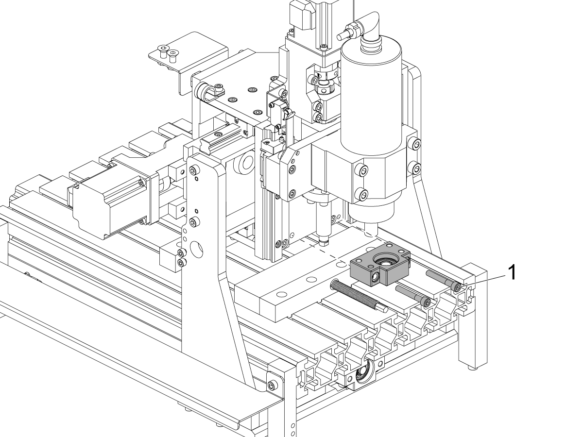

X - Axis Ball Screw Support Bearing Removal
Jog the X-axis to the left to shift the bridge away from the support bearing side of the ball screw.
Push [POWER OFF].
Unplug the Desktop Mill.
NOTE: Be sure to unplug BOTH the control pendant and the Desktop Mill power cords as current runs from the pendant to the mill.
Remove the two M6 Socket Head Cap Screws that secure the ball screw support bearing [1].
After removing the socket head cap screws, slide out the support bearing off the ball screw.

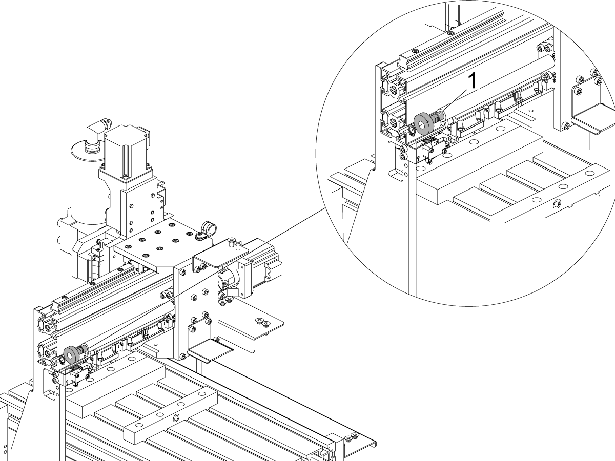

X - Axis Ball Screw Bumper Installation
Install the ball screw bumper onto the X - axis ball screw.
Place the snap ring into the snap groove to secure the bumper in place [1].

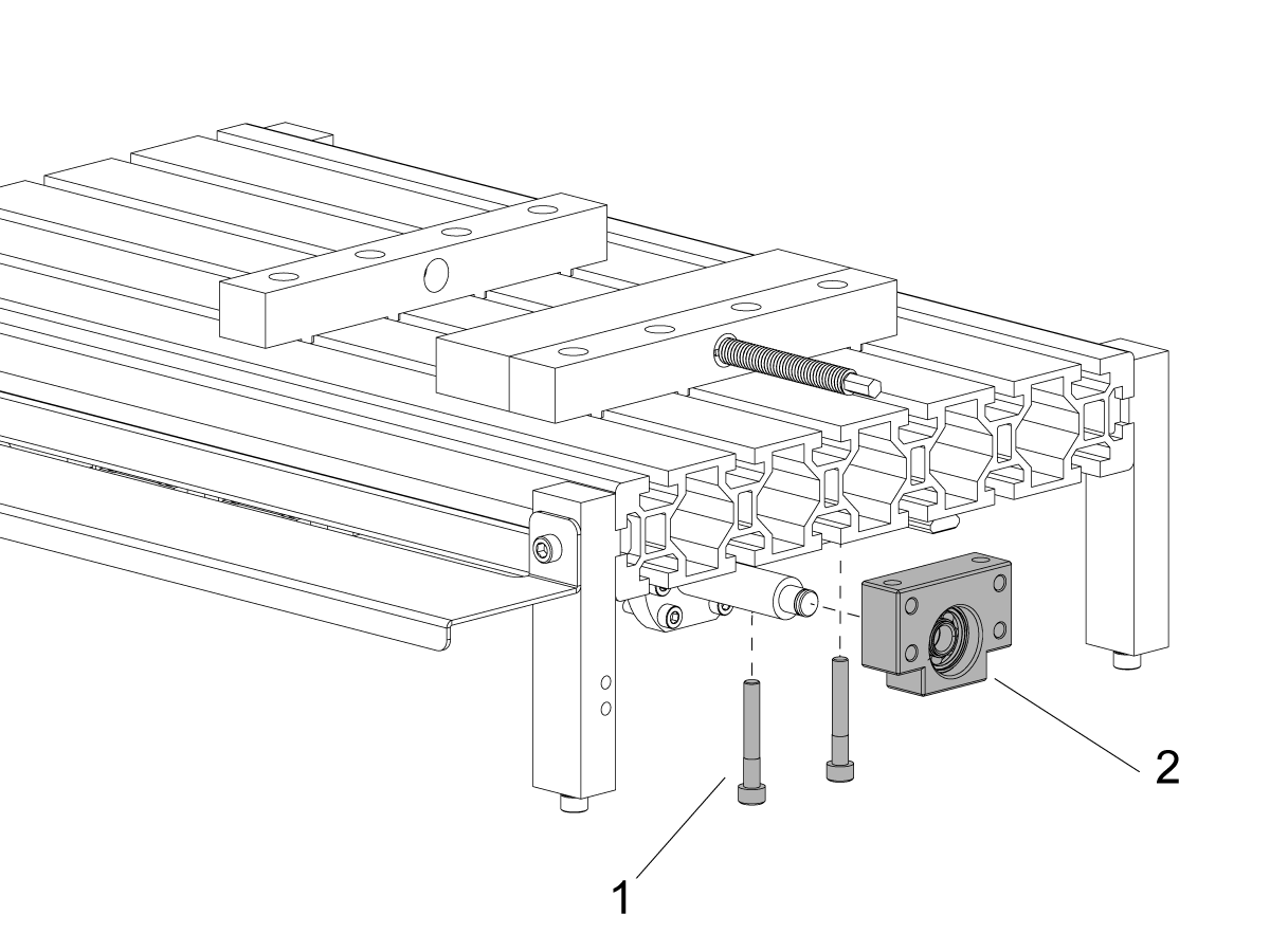

Y - Axis Ball Screw Support Bearing Removal
Jog the Y - axis to shift the bridge away from the support bearing end of the ball screw.
Push [POWER OFF].
After removing the socket head cap screws, slide out the support bearing off the ball screw [2].

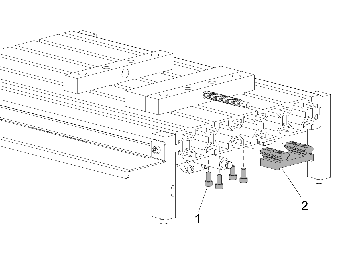

Remove the four M6 bolts from the T-nuts [1].
Slide the four T-nuts and ball screw spacer out of the T-slots [2].

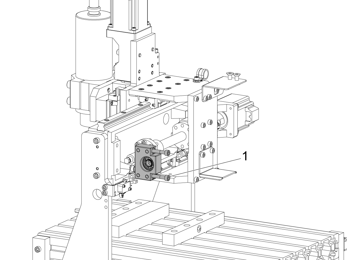

Z - Axis Ball Screw Support Bearing Removal
Jog the Z - Axis to the top of its travel in order clear the spindle away from the support bearing end of the ball screw.
Push [POWER OFF].

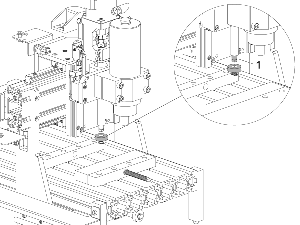

Z - Axis Ball Screw Bumper Installation
Install the ball screw bumper onto the Z - Axis ball screw.
