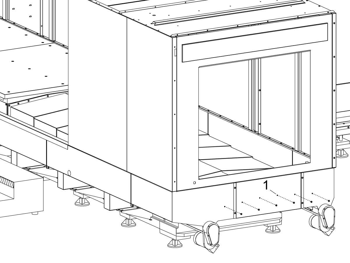

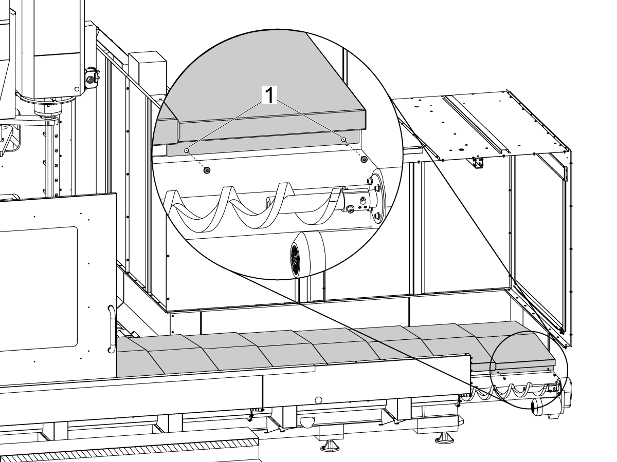

Remove the four screws on the side of the way cover that attach it to the auger troughs.
 Note: There are two screws on each side of the way cover.

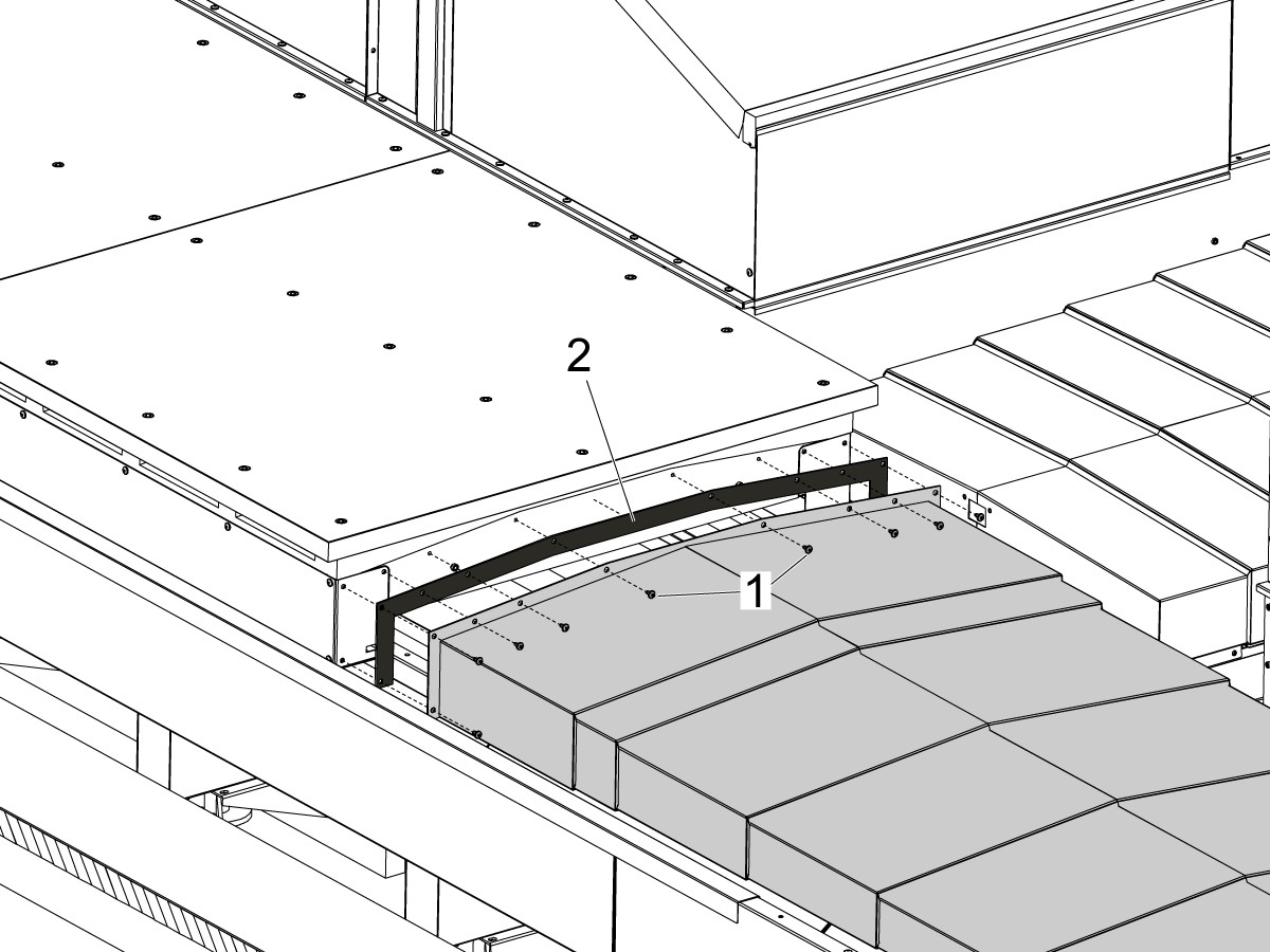

Remove the ten bolts [1] securing the way cover to the table.
Remove the used gasket from the table mounting surface.
Remove the six bolts [1] securing the way cover to the sheet metal.

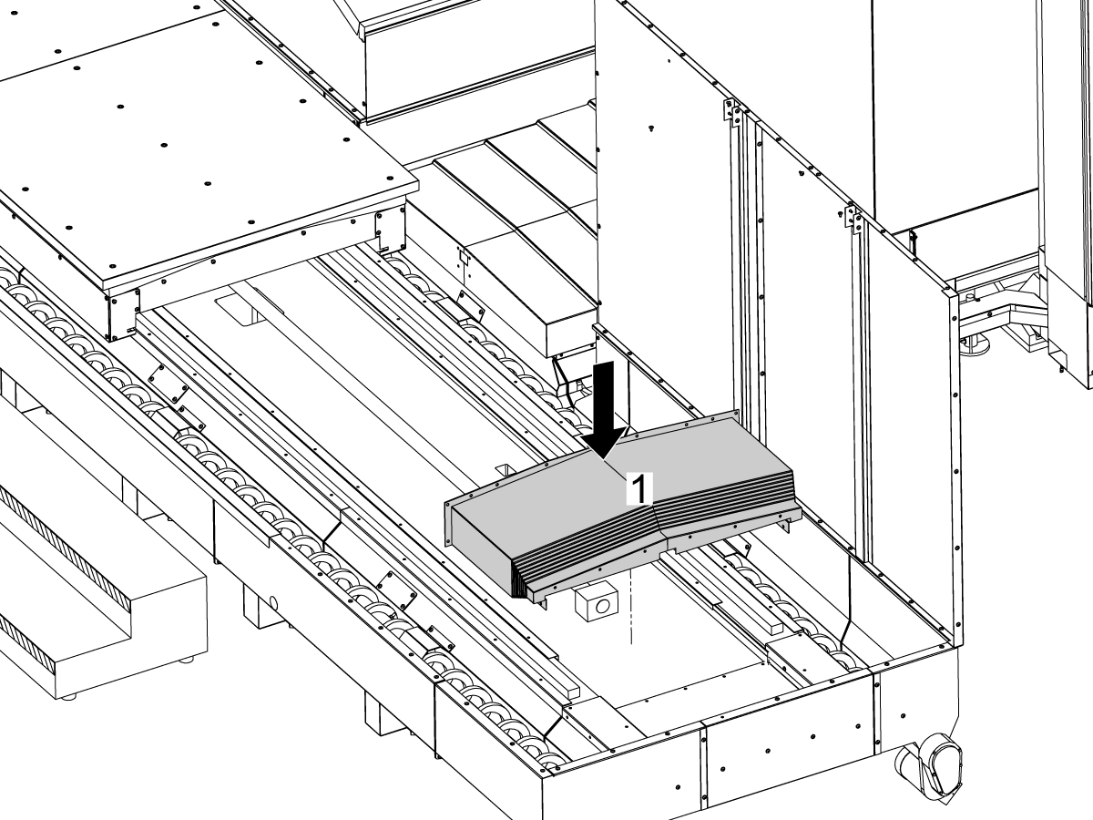

Remove the way cover.

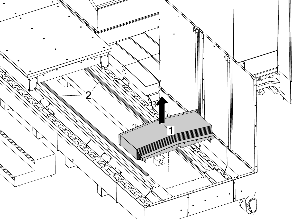

Remove chips and debris from the linear guides.
Clean the table surface where the gasket will attach.
Apply a thin coat of grease to the way cover guide bars [2].
Install the replacement way cover [1].
 Caution: Do not let chips or debris to fall onto the ballscrew, ballscrew motor, or guide rail areas.

Attach the sides of the way cover to the auger troughs with unused bolts [1].

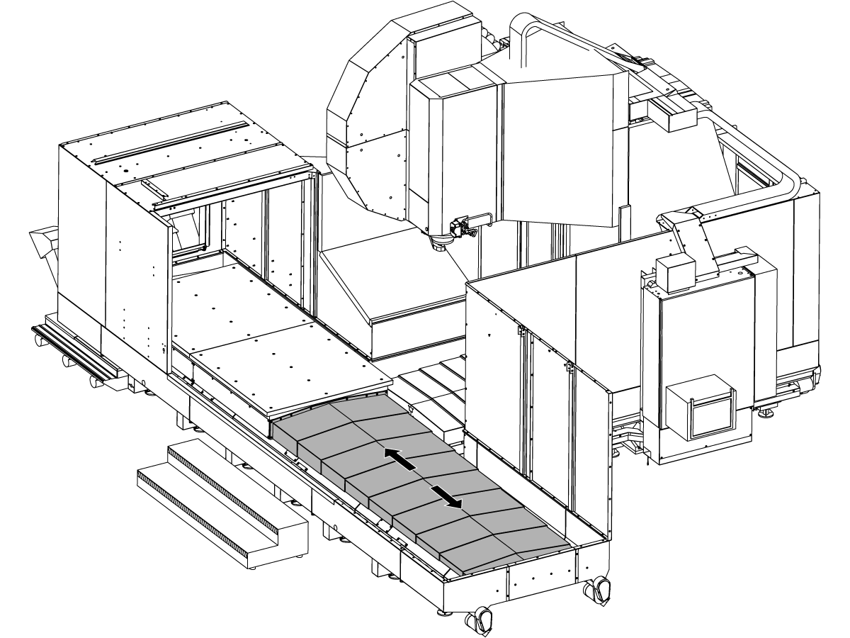

Slowly move table across the full axis travel. Listen for grinding or sounds of impact from the way cover. If these sounds are present, open the way cover and slowly move it along the rails, looking for places where impacts may occur.
Tighten down way cover bolts. Lightly spray a multi-purpose lubricant on the tops and sides of the new way cover panels.
Run way cover back and forth across the full extent of axis travel several times to break it in.
