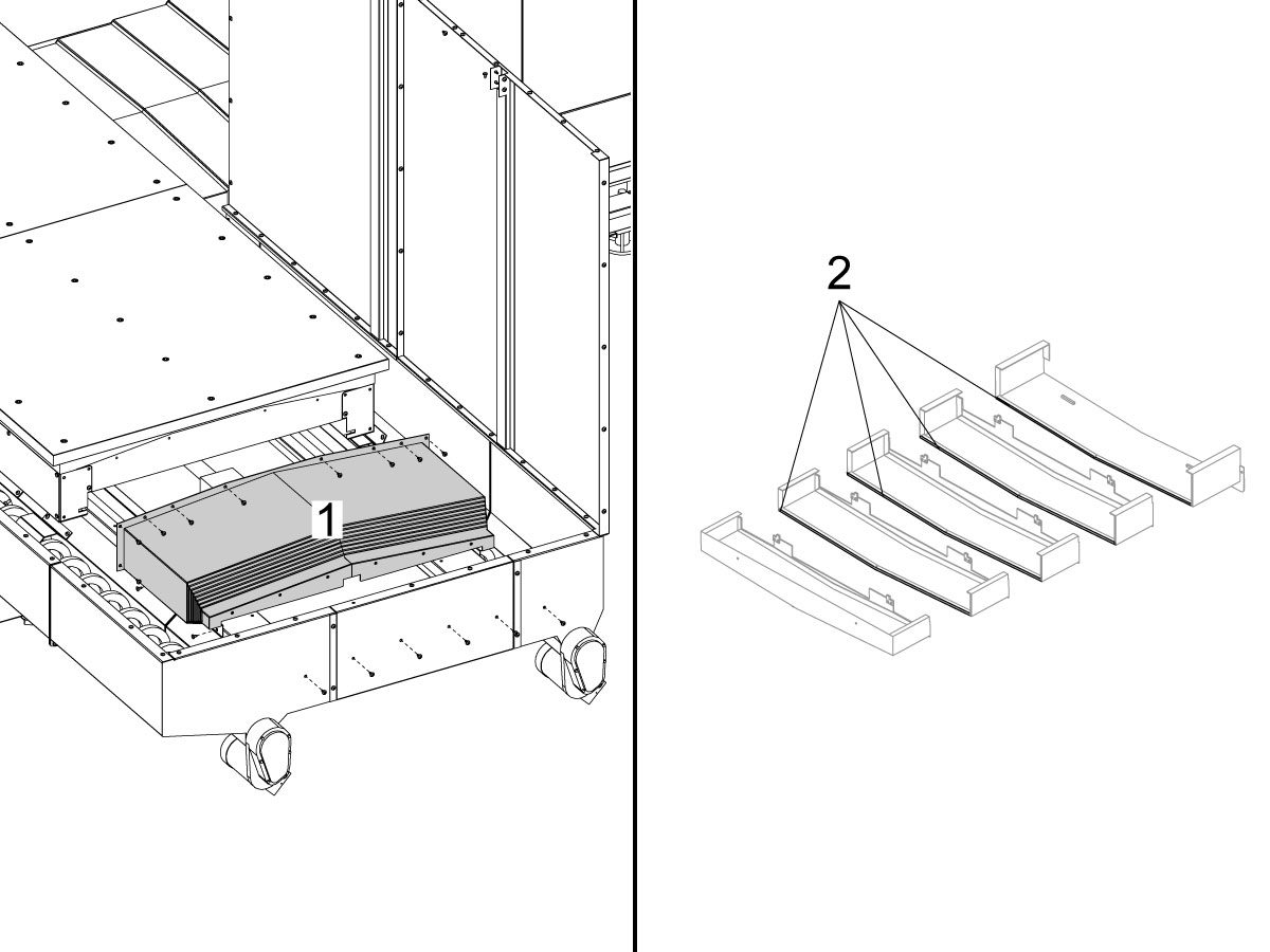

Jog axis to extend way cover and press [E-STOP].
Remove these parts from the machine:
  • Telescopic way cover [1]
Caution: The way cover has sharp edges. Use the leather gloves when you handle the way cover.

Wipe off excess grease [1] and inspect the brass seals [2], plastic slides [3], and bumpers [3]. Use the mallet to remove any dents from the way covers.
Note: Bumpers were added starting September 2021. However, they are not backwards compatible. If a bumper is damaged or missing, the way covers will still function properly.

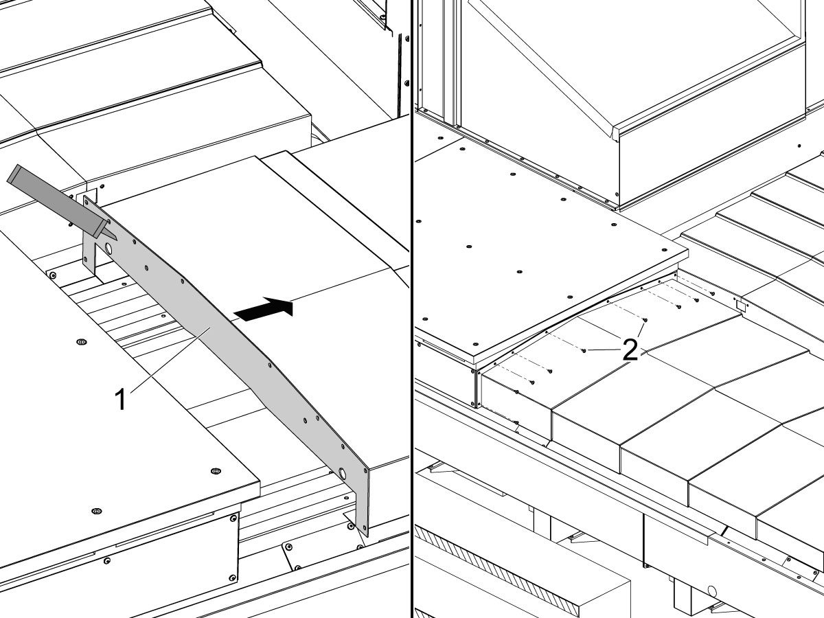

Apply a thin coat of grease to the way cover guide bars [1].
Install the way cover over the guide bars.
Attach the way cover end panel to the sheet metal. Use the end [2] and side [3] fasteners.
Move the table [4] to the full X-Axis travel.
Fully extend the sections of the way cover [5]. Make sure the way cover moves correctly and is the correct length.

Move the largest section of the way cover away from the table.
Put the RTV ASI 335 sealant on the way cover where it touches the table mounting surface [1].
Attach the way cover to the table with the (10) fasteners [2].
Remove any sealant that is squeezed out of the space between the way cover and the table.
