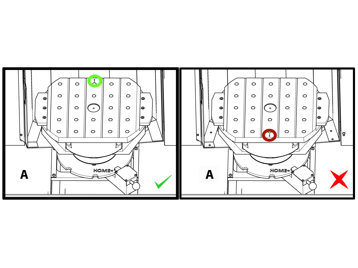

Pallets are loaded into the pallet pool on Load Station A in the reverse orientation as loading on a standard pallet changer machine. On a pallet pool the locating arrow on the pallet must point away from the operator as illustrated. Once the pallet is loaded in the Load Station A press [F3] while on the PST to put the Load Station pallet away.

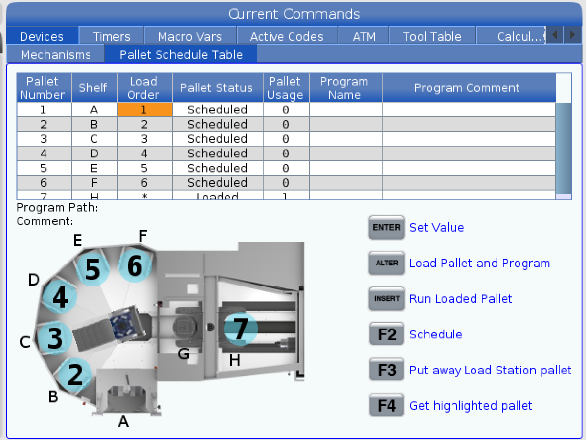

The Pallet Schedule Table incorporates a number of features to help the user with their routine.
Load Order and Pallet Status: These two features work together to show which pallet is currently in the machining area. Enter a number for the load order and press [ENTER] on the Pallet Status field to select the pallet status. The choices are: 0: Unscheduled, 1: Scheduled, 2: Missing and 3: Completed.
Comment: To add a user comment to a pallet, highlight the pallet number field and press [ENTER]. A box will appear, type in the desired comment and press [ENTER].
Pallet Usage: This feature gives the number of times the specific pallet has been loaded into the machining area. Press [ORIGIN] button to clear the value.
Program Number: This detail shows which program number has been assigned to the pallet. To select a program, highlight the Program Name field then press [ENTER] and navigate to the program.
Program Comment: This area displays the comments that are written in the part program. This can only be changed by editing the comments in the program.
Command Prompts:
[ENTER] The function changes depending where the highlighter is located. It is used to enter a user comment, set a value in the field and to view options for the field.
[ALTER] Load Pallet and Program. This will load the selected pallet into the machine and call the assigned program to memory.
[INSERT] Run loaded program. This will start the machine running in Pallet Scheduler Mode. The machine will continue to run all scheduled pallets in the PST until they are completed. For more information on Pallet Scheduler Mode refer to M199 Pallet / Part Load or Program Endin the M-code section.
[F2]Schedule Load Station pallet. This will set the status of the Load Station pallet to Scheduled.
[F3] Put away Load Station pallet. This will return the Load Station pallet to the pallet pool.
[F4] Get highlighted pallet. This will bring the selected pallet to the Load Station.

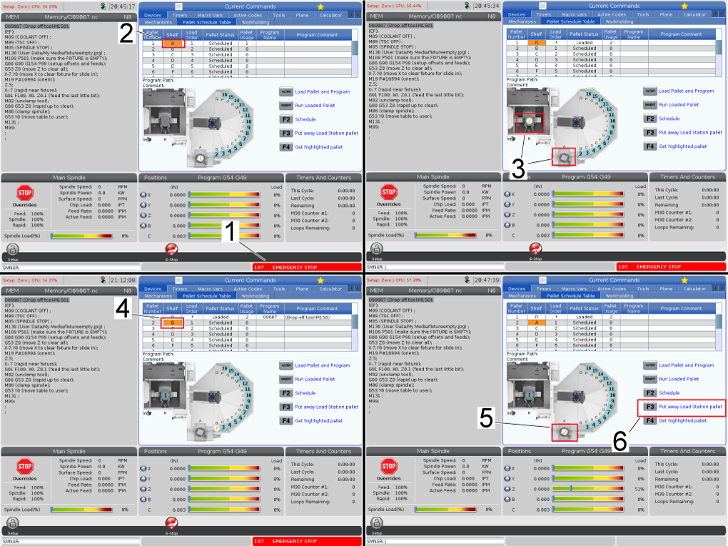

Using the Pallet Scheduling Table to Load Pallets
NOTE: The following images are that of a 16-station UMC pallet pool.
Load the pallets using the Pallet Schedule Table.
To reach the Pallet Schedule Table tab press [CURRENT COMMANDS] then go DEVICES > PALLET SCHEDULE TABLE.
Schedule the pallets, to do this highlight the pallet status of the pallet [1] and press [F2] to schedule. Repeat this process for the remaining pallets.
NOTE: The pallets must be scheduled in order to physically load the pallets to the station. After all pallets have been loaded the user can unschedule the pallets as needed. Unscheduling a pallet will tell the Pallet Pool not to pick up that pallet.
To load the pallets on the machine first press E-STOP [1] then go to the Shelf tab on pallet number 1 [2]. Change pallet 1 to shelf R [3], this will open the loading station in the software of the machine.
Next highlight the pallet 2 shelf tab [4] and change that to shelf A, this will move the location of pallet 2 to the load station [5].
Physically load a pallet onto the load station and press [F3] to put away the load station pallet 2 onto the empty shelf B.
Continue this process for the rest of the shelves and once complete move pallet 1 back to shelf A.

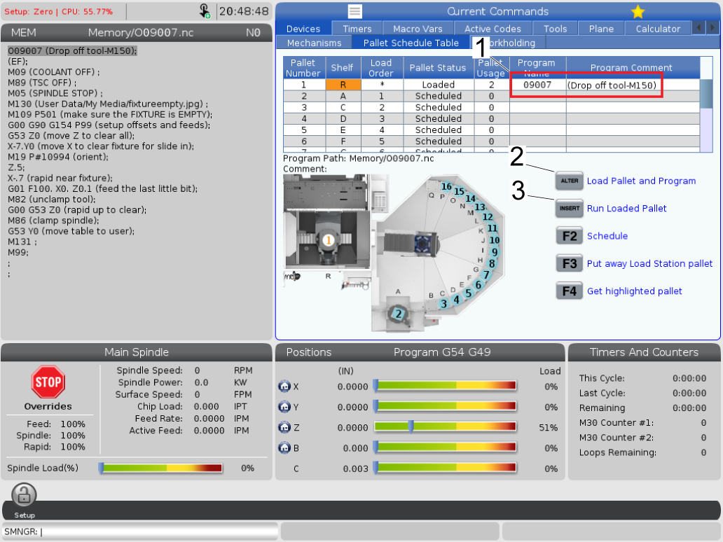

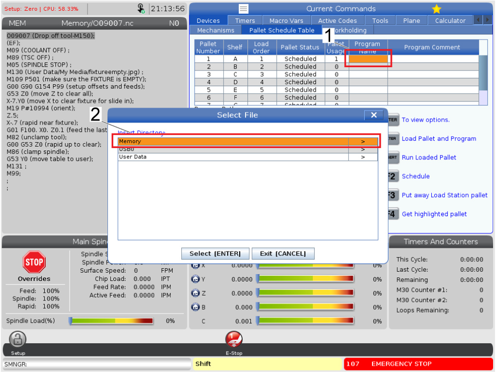

To load a program for a specific pallet go to the Program Name tab [1].
A pop up menu will appear which will ask where to load your program from. Choose the file location, select the program you wish to run for that pallet and press [ENTER].
The program name and program comment will appear in its respective tab [1]. Continue loading programs for all other pallets this applies to.
Pressing [ALTER] [2] will load the pallet and program as the name describes.
Pressing [INSERT] [3] will run the program of the pallet in shelf R, the pallet status should also tell you what pallet number is loaded.

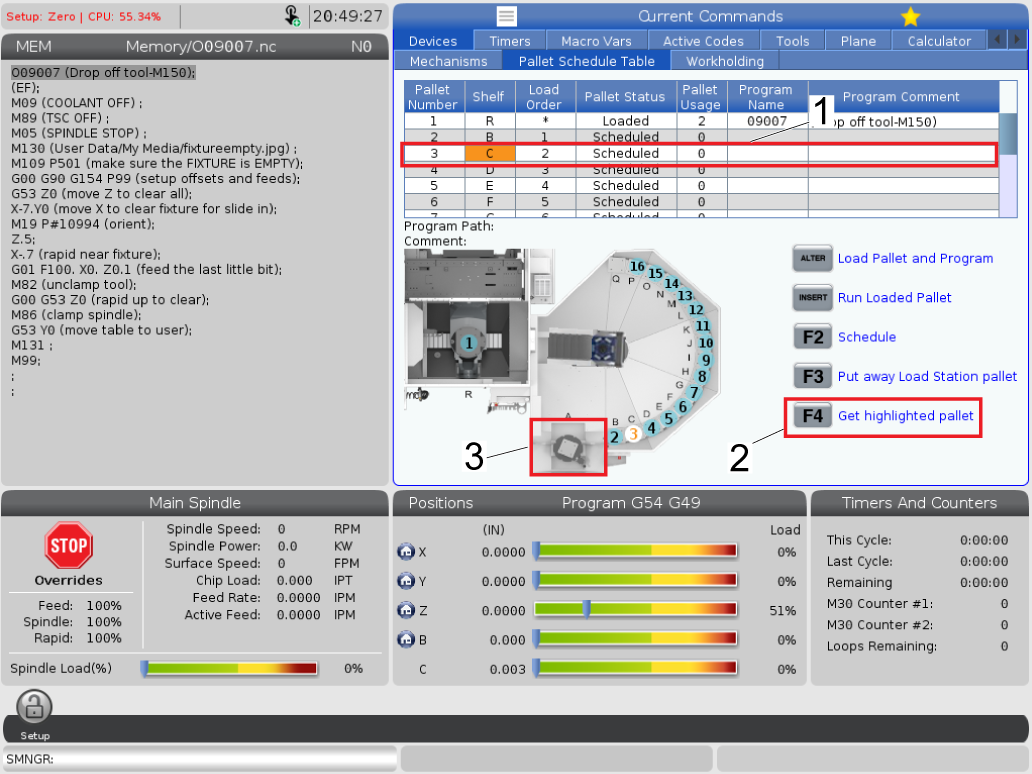

To retrieve any given pallet choose the pallet number or the shelf [1], you should see the number of the pallet highlighted, press [F4] denoted as [2] and that should bring the highlighted pallet to the loading station or shelf A [3].
NOTE: If there is a pallet in the load station when this process is commanded the pallet in the loading station will be loaded to an empty shelf in the pallet pool in order to move the highlighted pallet ot position.
